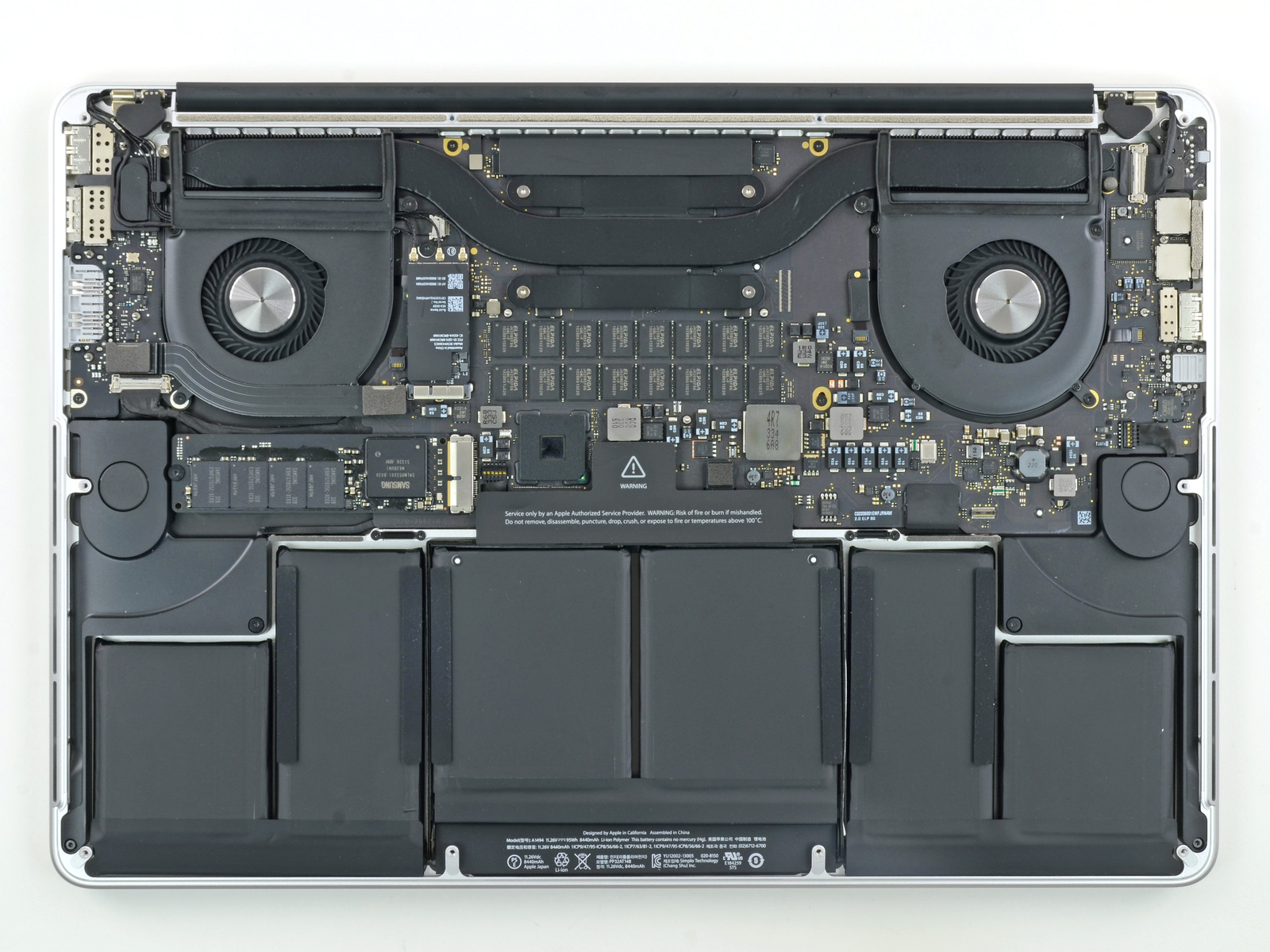

Also, with how thin the keyboard is they're most likely fitting more of the heavy hitting stuff on the other side as well. The iFixit non-TB version had space for more shielded RAM on the other side.

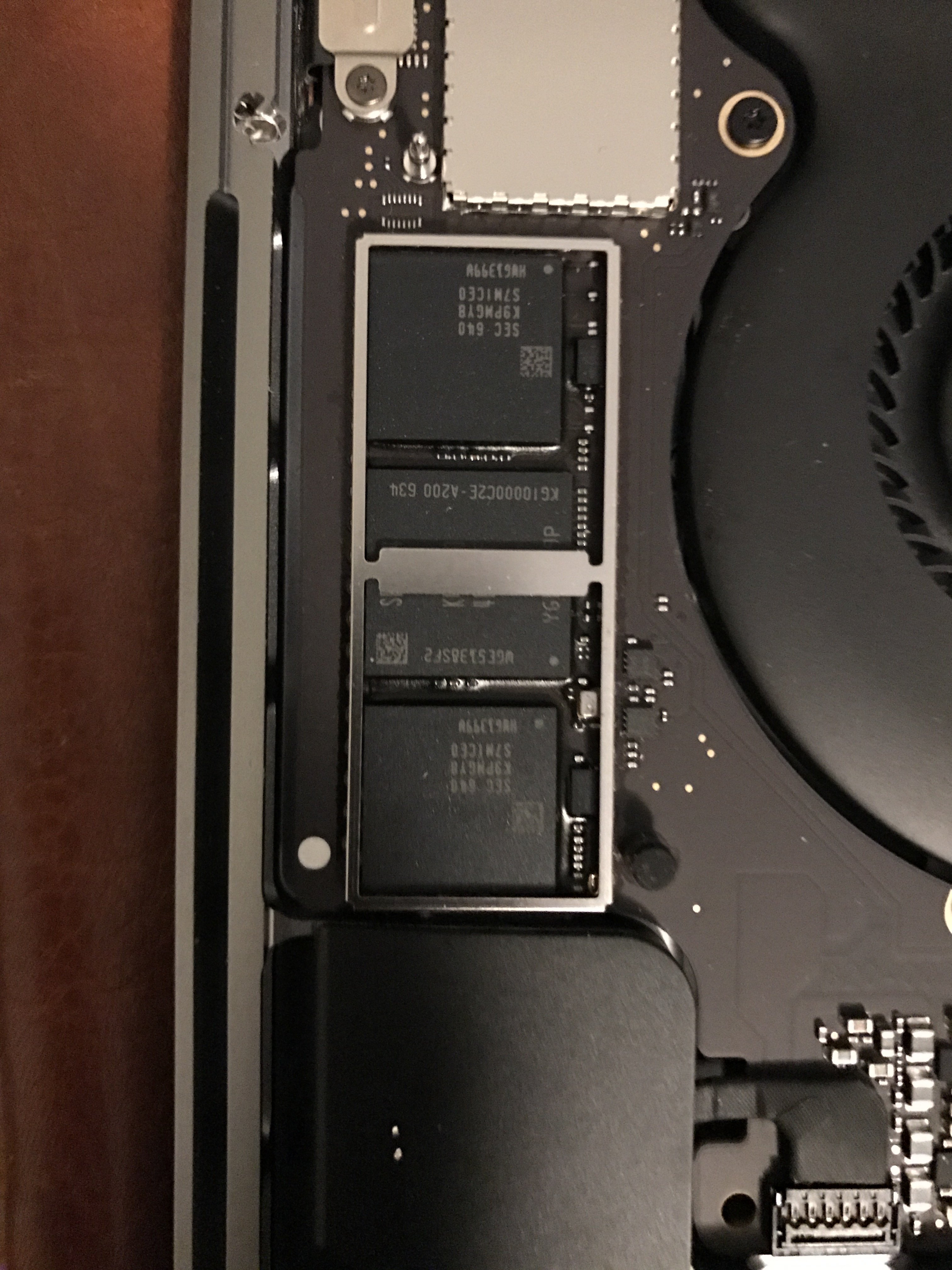

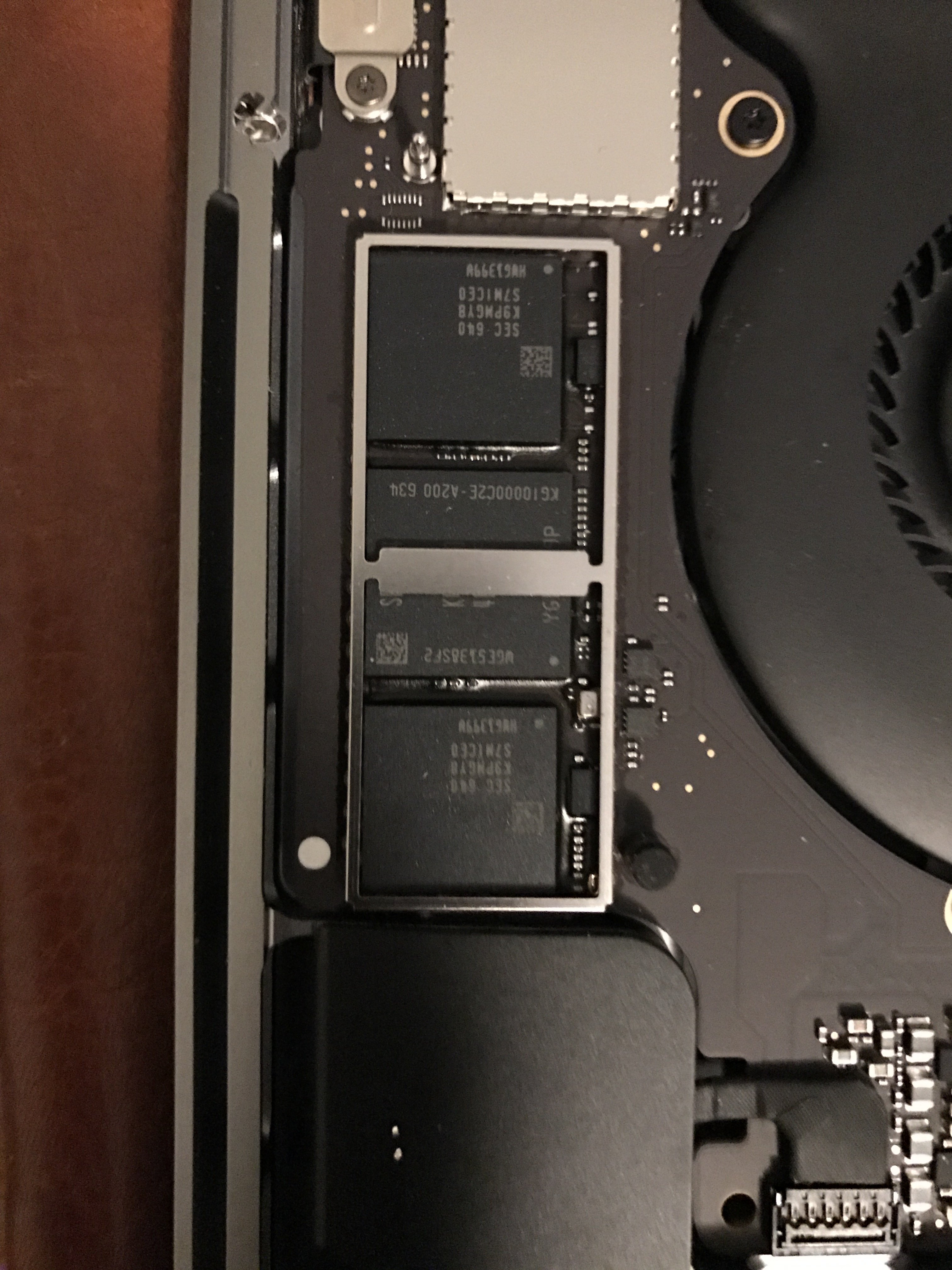

I got slightly more daring and removed the shielding on where we thought the SSD was - those chips look like SSD guts to me. The other shields wouldn't budge as easily as this one did.

It's under one of the silver PCB shields, but I'm not daring enough to start messing with those as it'll look like it was tampered with. I was expecting to be able to see the T1 / Touch Bar component area, but alas everything interesting is shielded with these models.
Going by the image below, shielding closes to CPU/GPU is most likely RAM and VRAM. Maybe T1 chip under the shielding closest to the top of the image and SSD components at the bottom near the fan?

Does it look like those models with 2 TB SSD storage would have a second module up at the top of the photo, symmetrical to the module shown at the bottom?

Based on the label, may Samsung V-NAND chip some as 850Pro
