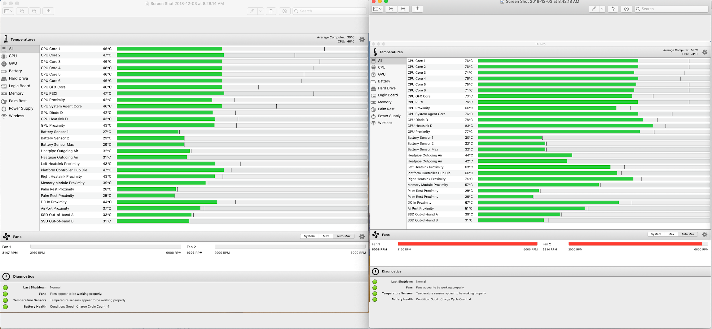

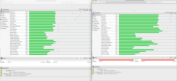

How would you explain professors vega running 13 degrees cooler?
The image on the left is idle and the image on the right is after four runs of the heaven benchmark. For the record, temperatures stabilized after the second run and did not change appreciably for the final two runs.

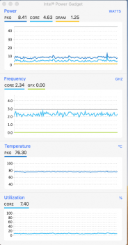

[doublepost=1543844827][/doublepost]Intel Power Gadget right after the fourth run.
Can't say anything about it since I don't know what the test conditions were. If its with external display attached, I'd speculate that Vega Pro could be more efficient with its low power mode. If its with the iGPU running, I'd speculate that the older laptop had defective cooling 🙂

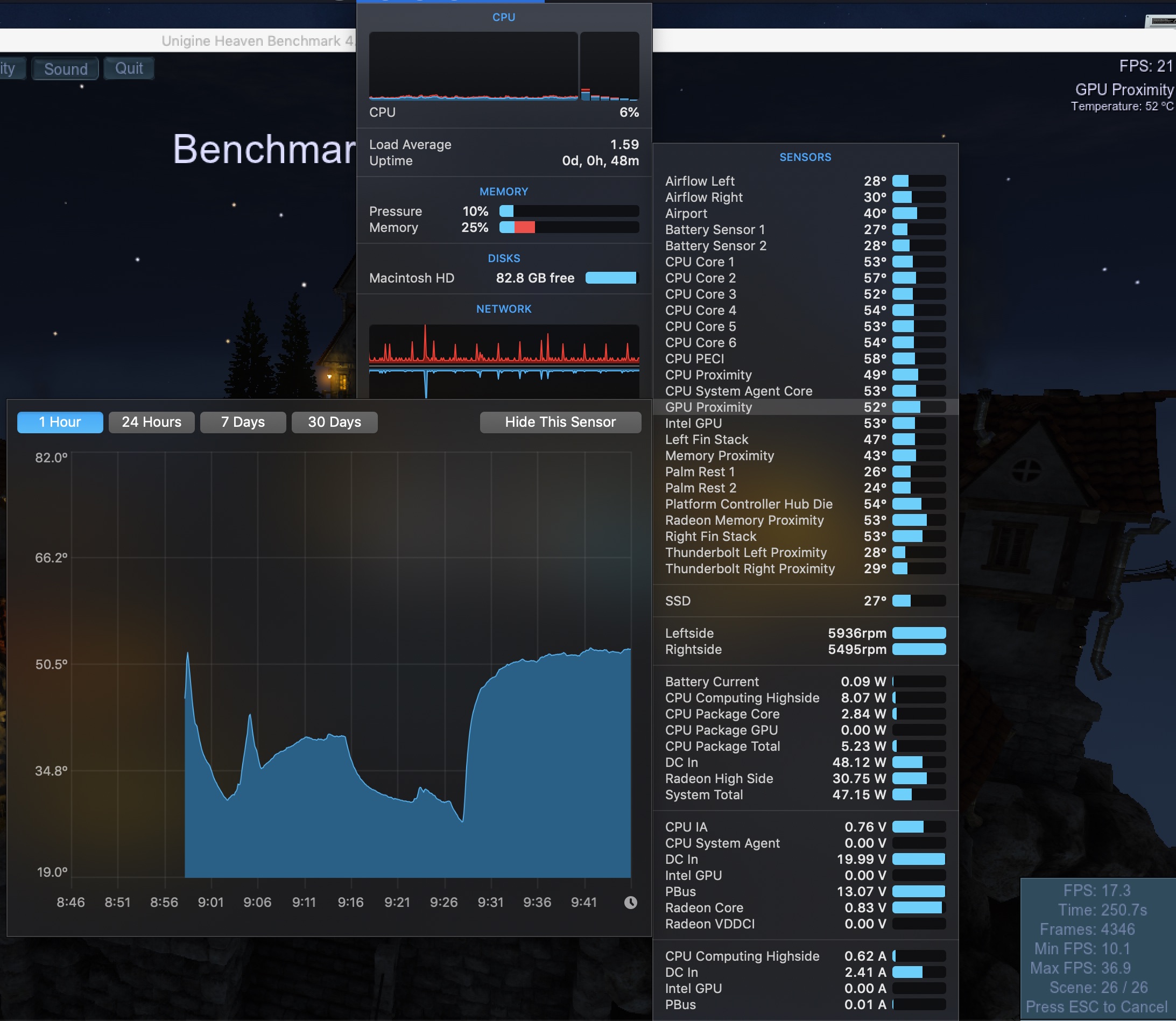

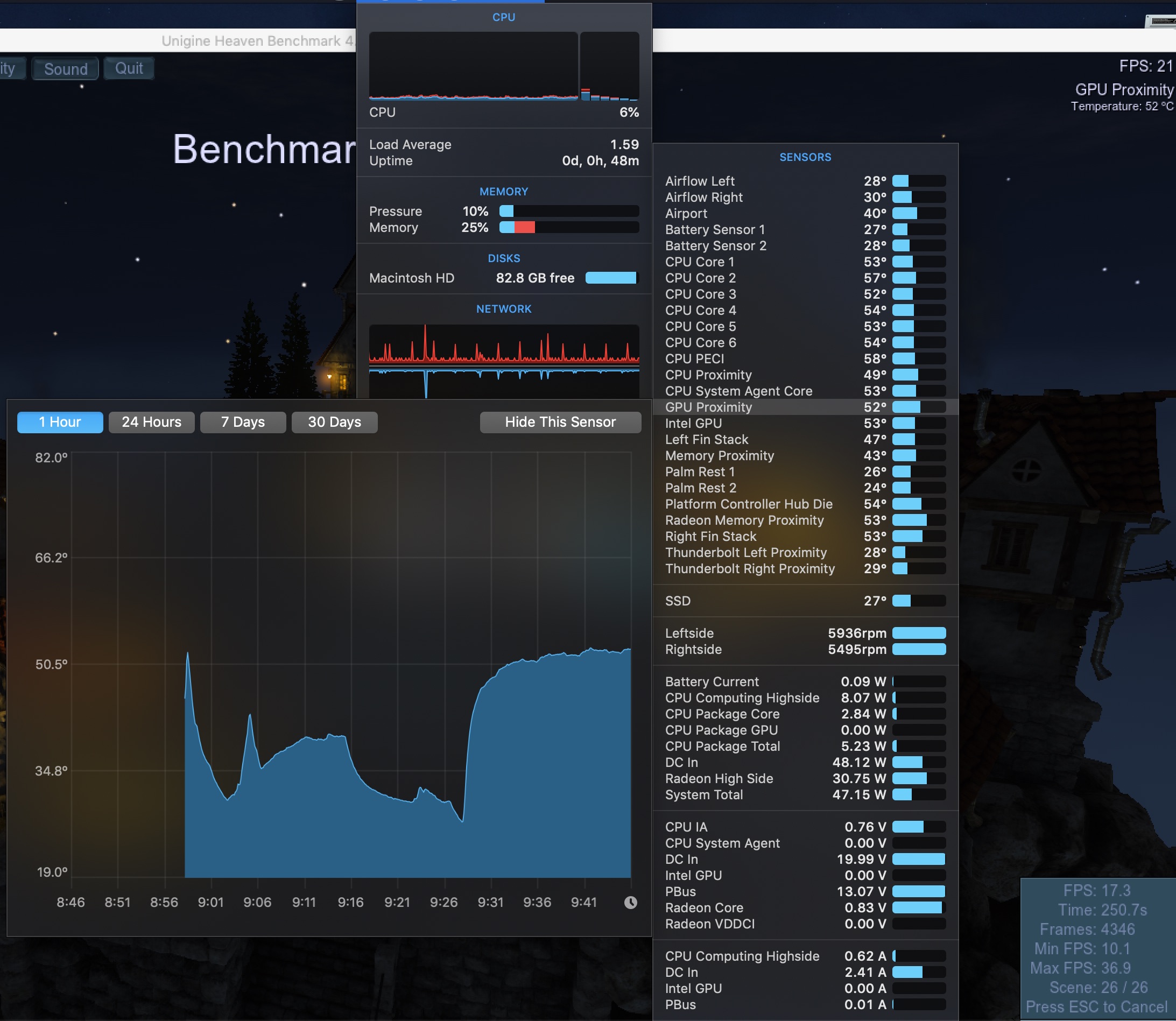

Anyway - as a baseline, here is my 555x with fans at full blast after 4 times Heaven Extreme run, screenshot made at 250s mark of the last run. Note - it looks like fans on Vega can go higher than on mine.

Where do you see CPU and GPU power dissipation?
Power dissipation is the correct term. I was looking for the GPU and CPU power dissipation, but I see now that istat only calculates CPU power dissipation. I will run this test as soon as I get home from the university.
One thing I have noticed, is that the heaven benchmark stops running as soon as I click on the istat sensor menu. Do you know of a way around this?
Joe
I think you meant power draw, you can see it on my screenshot, the Watts for individual components and totals.

There is an option in settings "Always run" - it doesn't have any effect on my case, my installation runs in the background regardless, you can try it. And the GPU power is shown under "Radeon High side".
About power consumption/dissipation - the values shown in sensors are based on current measured at voltage regulators, that's the input power and I don't know if this takes into account the VRM efficiency. So the actual GPU power dissipation may be lower (or identical) to the reported power draw.

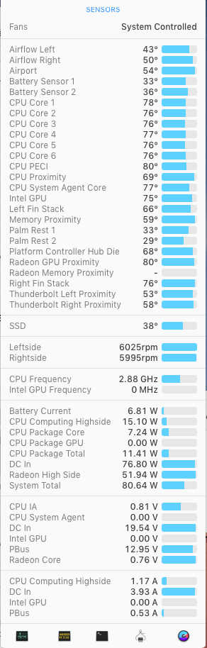

Here you go. After four runs: Highest frame rate 64, lowest frame rate, 27.

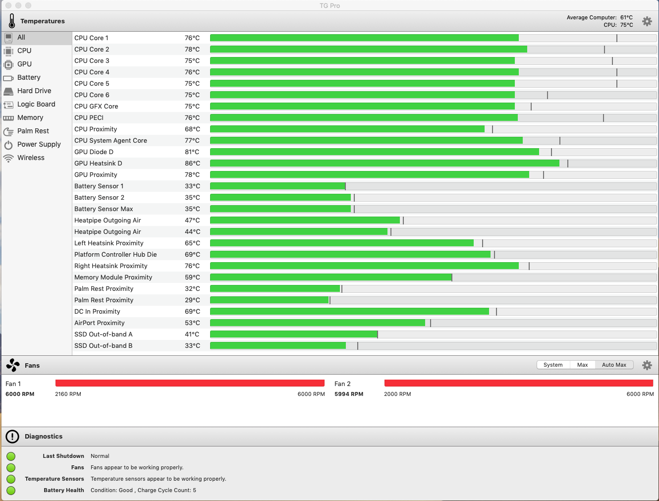

Thanks again! This is the first time somebody posted readable values. Even I eventually got caught up in the hype that this is going to be 35W GPU based on repeating claims that it is cooler, I need to edit my posts where I admitted to be wrong in my predictions. Dang it, I almost sold my 555x to get better balanced laptop. So, realistically, we're looking at 10%~15% power efficiency improvement from polaris, and not 60%.
Did you use some third party charger? Your system was tapping into battery.
To answer OP question - Vega is hotter, by a lot.

You are most welcome. At idle, this computer is 13C cooler than an identically configured 560x. Unfortunately, I did not run any benchmarks to measure load temperatures. With respect to your question, I am using the caldigit TS3 Plus docking station.

13C cooler at idle than my identically equipped 560X under the exact same test conditions.
