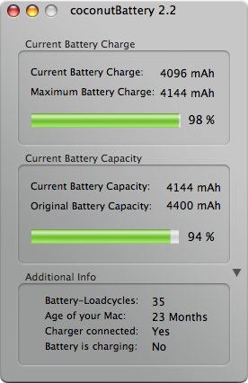

I have replaced my battery and still I have a problem with my Macbook not charging the battery past 98%. Does anyone else have this problem or is it normal?
Thanks
mine does that sometimes, like right now its been stuck on 97%, usually i just unplug the power adapter for a few minutes then plug it back in
Sometimes mine will only display 99%. Usually if I unplug the magsafe, then plug it back in, it will display 100%.
edit: this is on a MBP
Mine charges to 100%, then I shut it down, turn it back on the next day and it is at 98%. That is with the Magsafe connector plugged in.
I've had it charge to 100 % occasionally but not that often. It's usually at 98 %, even after it's "fully" charged.
After almost 2 years, you'd think the thing would work as I expect but that's not the case.

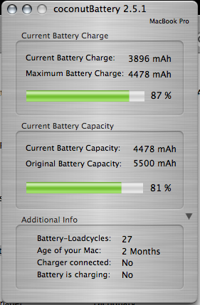

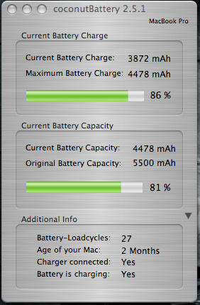

How do you only have that little charges? Mine MacBook is a month old and is just shy of that.😕
I haven't been away from home enough or there haven't been enough hurricanes. I really needed it in the 2004 hurricane season since I went around 5 days at a time, 3 times without power.
Even when I take it out when I'm photographing something, I don't always pull it out to edit just then for fear that someone will try to steal it while I'm shooting again.
That's normal. It's not good for a battery to fully charge to 100% every time, so the OS will stop it from charging to 100%, usually anywhere between 95-100%.

here's what apple says about it 😀 and for those too lazy to click, here ya go 😀
Some PowerBook G4, iBook, MacBook Pro and MacBook computers may not show the battery as 100 percent charged in Mac OS X, even when the power adapter is plugged in. The battery appears to stop charging between 93 percent and 99 percent. (PowerPC-based computers may stop charging between 95 and 99 percent; Intel-based computers may stop charging between 93 and 99 percent.)
This is normal. The batteries used in these computers are designed to avoid short discharge/charge cycles in order to prolong the overall life of the battery. Because of this, when setting the Mac OS X battery status menu bar icon to display charge state by percentage, you may notice that the reported charge stays between 93 or 95 percent and 99 percent. When the battery level eventually drops below 93 or 95 percent, it will charge all the way to 100 percent.
I'm pretty sure that the 98% is just a minor calibration error. It's not that you're not charging you battery to its maximum, it's just that the sensors are reading it as 98% full. It tends to happen when there's a large space of time where you don't drain your battery. A calibration will surely fix this problem if it bothers you. Otherwise, it's really nothing to worry about.
