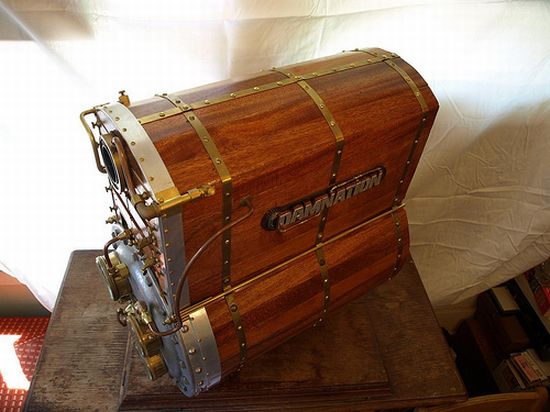

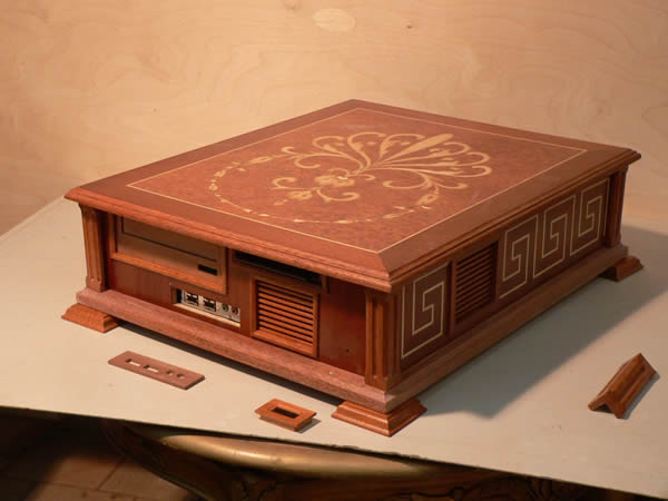

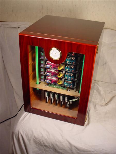

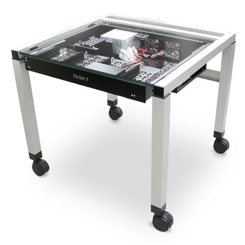

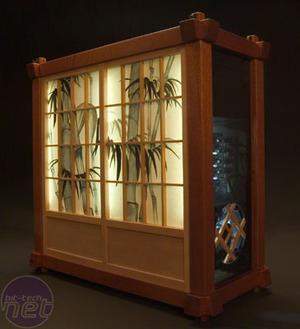

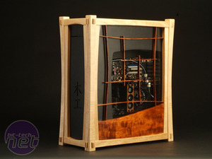

Yeah, if you want it in a Mac case it seems like a bit of a project. 😉 I dunno tho... I might just build my own case. I was a cabinet maker in a former life and something like below looks pretty sweet to me!
There's a buttload of very interesting ideas if you're up for a project:
I'm not ready to start yet tho. I guess in about 8 months to a year. I wanna watch the market for awhile longer. I keep waiting for something totally new to arise. Like quantum computing or something. 😀
I guess I can make something that will run completely silent and still be very cool. 😉
WOW!
2 or 3 of those are very beautiful, thanks for posting them up 🙂
Yeah, the bottom left two I've read about, that guy does amazing work.
I also like that pizza-box shaped one.
Tess - you wouldn't happen to be into steampunk now would you? 🙂
