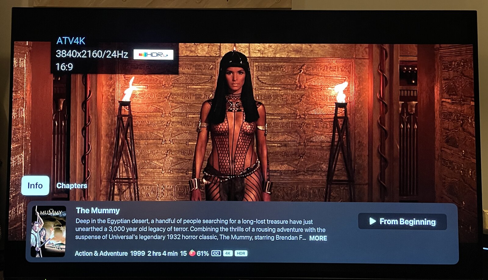

So I can assume then that the Netflix movies are displaying in 4K UHD even though the tag says DolbyVision?
Yes you’ll be getting 4KHDR, there should be some sort of on screen information from the TV itself to show what it’s actually outputting on screen.
On my TV if I press the info button it’ll show the screen ratio, whether it’s Dolby Vision, HDR or HDR10+ along with the framerate info.
Like this as an example
70b018fd-7228-420b-9378-1ecab057e52b-jpeg.1801894
That's one of my problems. My Samsung remote doesn't have an info button,so I can't always see what the screen is actually displaying.

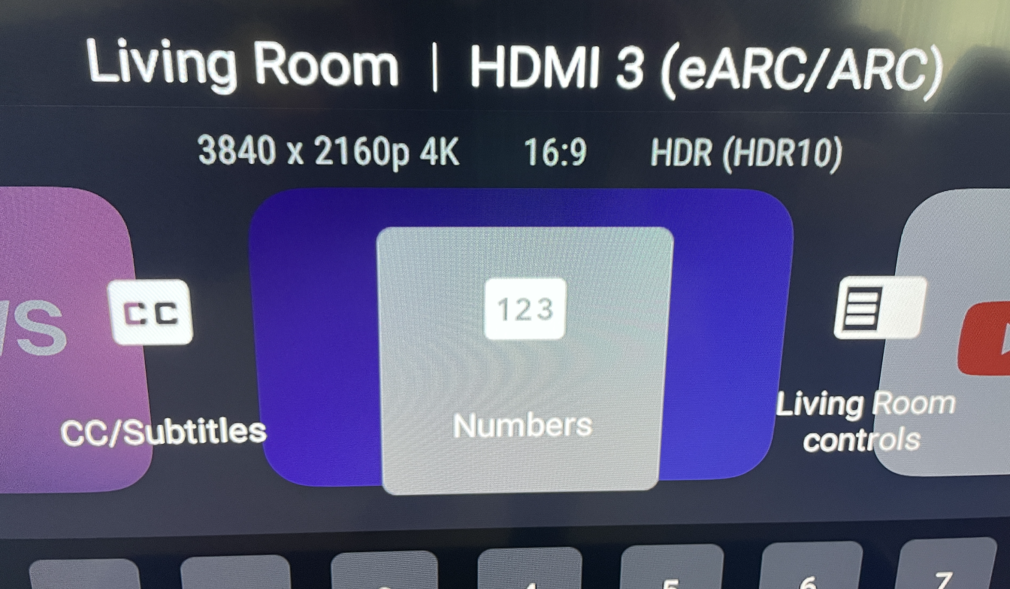

Héhé. I have Sony X90K with Dolby Vision and a 2021 ATV 4K DV. Never could get the TV to show a movie from Prime Video in DV. Neither on the preinstalled app or the ATV app. I know about YT. On my Sony remote, there is no "I" button too. No way to know details about the screen displaying. Something tells me newer TV and remotes don't have an info button anymore. Gave up on "I" button till next TV.
On an X90K you press the 123 button on the remote, a mini menu will pop up and the source information displays under the input information
