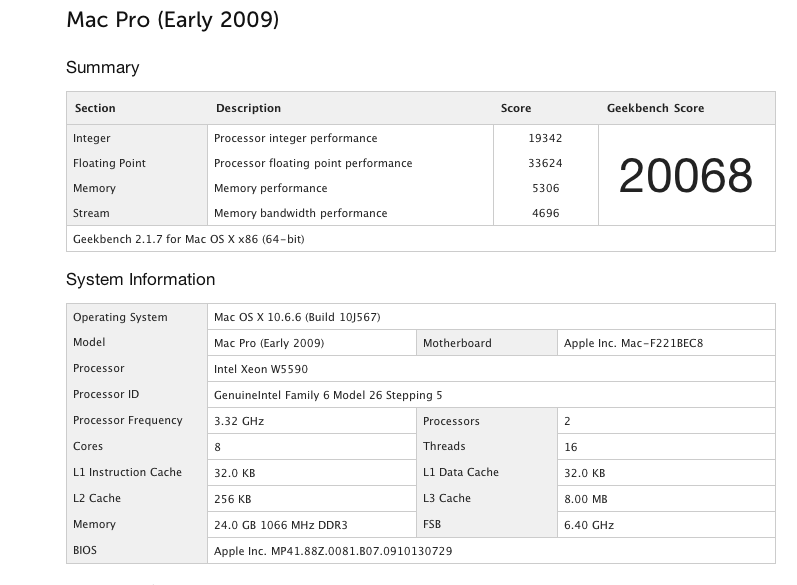

16451 in geekbench is that alright?
Seems a little bit too low. If you browse the geekbench results online you'll see that the general score for two W5580s is about 19000.
Even my E5520s score about 14000.
But than again, it's a synthetic benchmark. Don't overestimate it.
Yea indeed from the spec you got there its indeed a bit low. Maybe due to the amount of Memory you have there.
Here are my result.
OK finally got the 24gb of ram (Kingston KVR1333D3E9SK3/12G) and reran the geekbench to find that I was still getting 17000. I realized i was running the 32bit version not the 64bit. Not I'm getting 19336.
