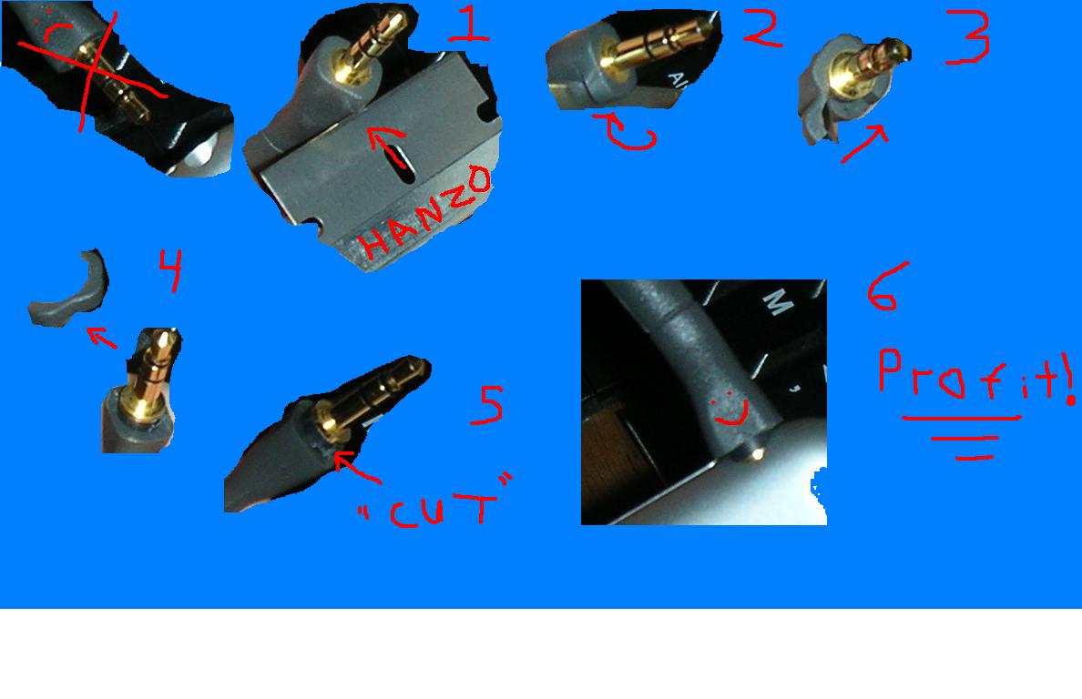

Now you do this ENTIRELY @ your own risk.
You could damage the headphones, iphone, yourself or any combination thereof.
Hanzo Steel not required, but reccomended.

I was afraid to take a knife to my noise isolating earphones, but I over came my fear and took the big step!😱 It was a lot easier than I thought and the end result works great and it doesn't even look like a hack job. I have Ultimate Ears Super.fi 5's.

It was a very difficult procedure, and a LOT of work went into the this Aero-Space Ceritified Process.
I just wanted to make it so easy, that even Nasa could do it.
The following survived this procedure with minimal complications:
Ultimate Ears Super Fi 5EBs - success, but the rubber is glued pretty (#*$ing good, so required a bit more work.
Computer audio cable ("practice run") - success.
Sony MDR-EX90LP - success. *** To you all who love sound isolation / deep bass - these BLOW AWAY my Ultimate Ears Super Fis -- the secret is an incredibly easy / effective modification. PM me if you actually have these and are willing to operate. I'll only make my next "procedure" on demand. I need to get back to moon-landing documents now.

Nice! I did the same thing to all my other headphones. I refuse to pay for a headphone adapter.
I did this the first day i got my iphone...
I cut off all of the plastic\rubber on the outside of the connector and covered it with heatshrink...works great.

I just used this technique on my cheapo skull candy headphones and it worked really really well. I used an extremely dull hobby knife with no casualties. Finger nail clippers also help alot.
