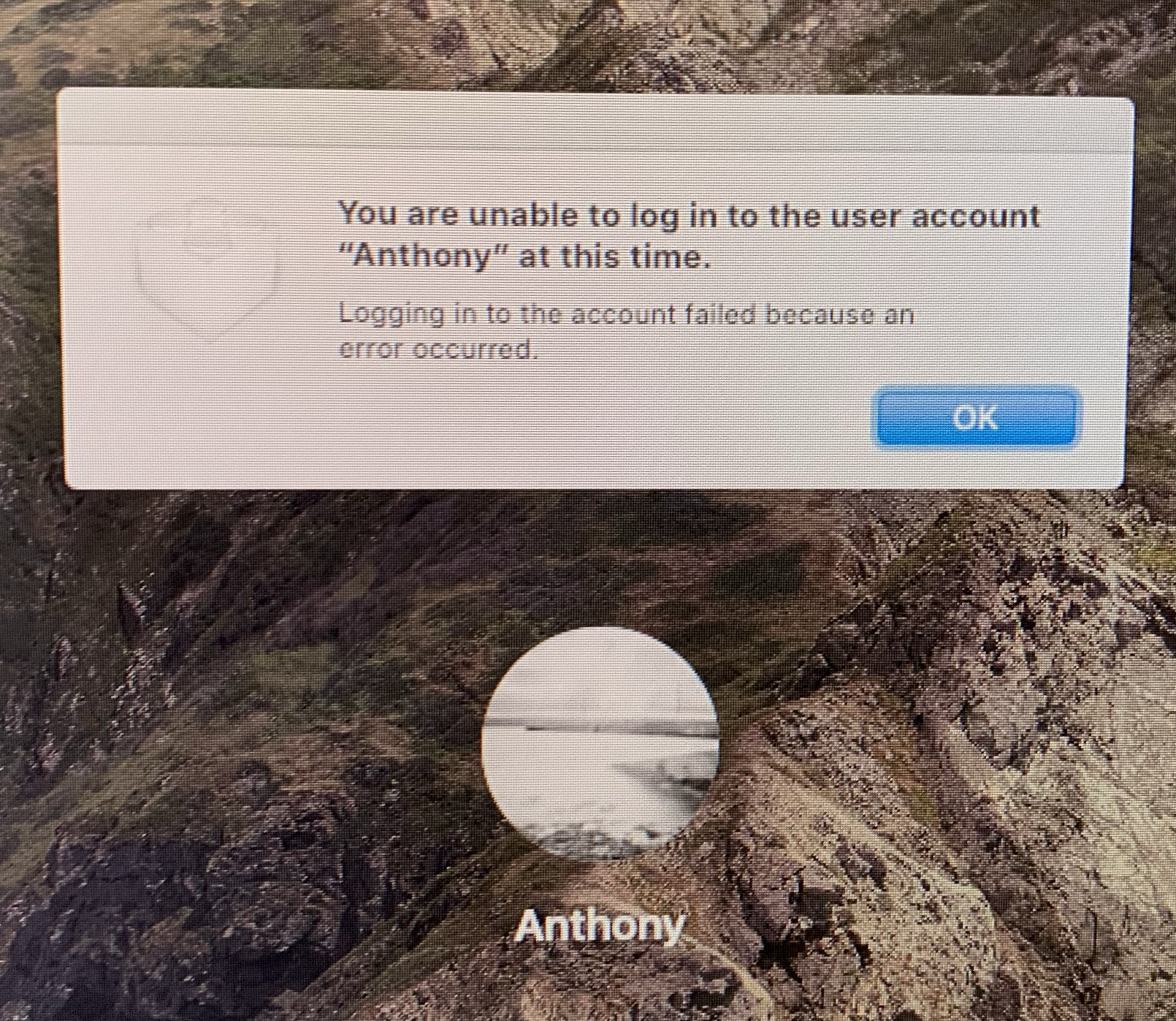

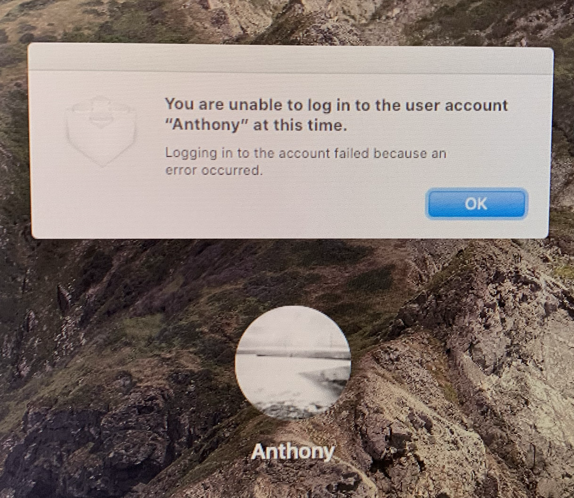

Hi,
I recently used the Catalina patcher on my 2009 MacPro and the installation went fine until I tried to log in. I got the attached message at the login screen and don't know what to do.
