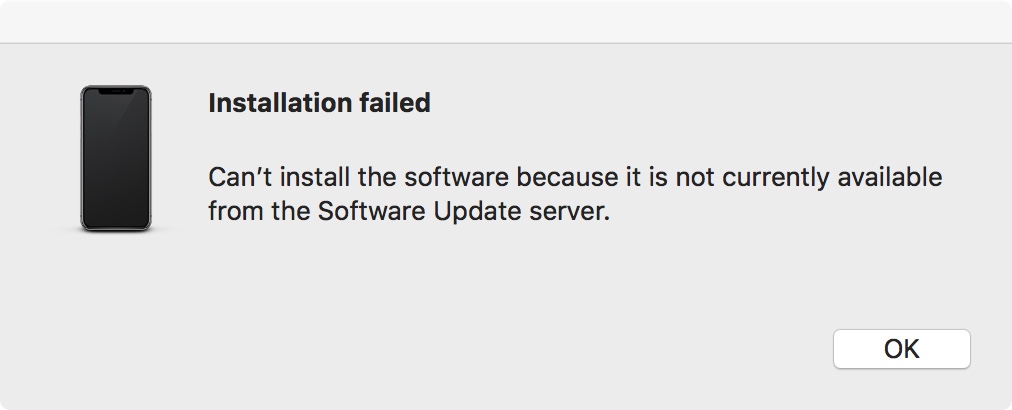

I'm trying to downgrade from PB 13.1 to PB7 (?) 13.0 using High Sierra. Using Cmd and Check for Update didn't work so I tried Alt and Check for Update. This looked to be working as I was able to select the already downloaded IPSW, however I then got this error. Could this be because I need to install Xcode? If so, which can I use on High Sierra? Or is it impossible to downgrade now? I only went to 13.1 because Automations was said to be working, however it still won't let me automatically switch wifi off when I leave home and I miss the share sheet options that were present on previous beta so would like to downgrade.

I downloaded XCode. Had it open. Clicked on Option/Update, selected the ipsw, it attempted to Install/Download, and then it gave a message saying it wasn’t currently available from the software update server or something like that. Can’t remember exact wording. Maybe I didn’t open the ipsw with Xcode the correct way?

You don’t use Xcode. The update process is via iTunes. Hold the option key and click on Check for Update, select IPSW and wait.

He’s not saying that he’s using Xcode to do the updating, just that it is open i the background. The same is happening to me, even when Xcode is downloaded and running in the background while I’m doing the rest in iTunes… :/

And still getting this same
Message as the person above:
Then why does this message keep coming up? Is the update contained within the ipsw or is that just something that is like a conduit to connect to something on a server which is no longer available?
After googling around, I solved the issue by downloading the latest beta version of Xcode. Currently running 13.0 beta 8! 🙂
