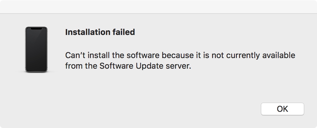

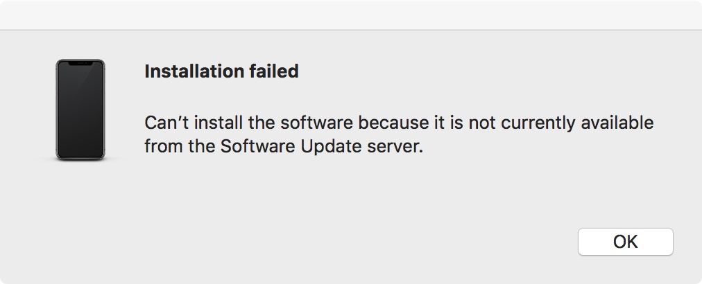

FINALLY figured out the issue for those of us receiving the message (screenshot attached) about the Software not being available from the Software Update Server.
The problem seems to be that iOS 13.1 is something that isn't recognizable by the OS on your MAC. It works with CATALINA, though. I had Mojave on my MacBook Pro so it wasn't recognizing 13.1 in order to update (downgrade) to the 13.0 ipsw I had downloaded. I took a chance and downloaded the Public Beta of CATALINA and then followed the instructions recommended by others regarding having Xcode open, holding Option and selecting Check for Update, and selecting the 13.0 ipsw...and it worked! It downloaded iOS 13 PB 8, and I'm all good...again.
Hopefully, this will help others having the same problem being unable to downgrade from 13.1 to 13.
Good Luck, and thanks all!
