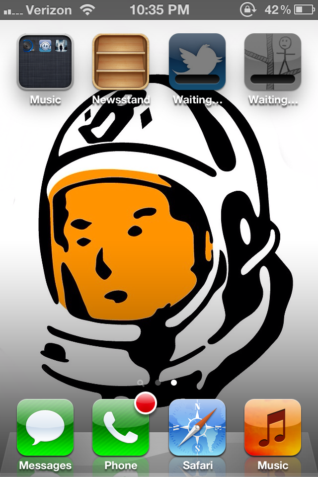

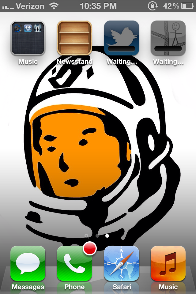

iPhone 4 - Apps won't download. Stuck saying "waiting" yet i can delete them.
Recently whenever I try to update my apps they all say "waiting" and won't download at all. Then when i hold down the app it allows me to delete it the app even though it is still trying to download.
My iPhone is not jailbroken
Someone please help!!

Try a "reset all settings" (NOT an erase all) and if that doesn't work then you're going to have to restore.
THANK YOU, THANK YOU, THANK YOU! This worked like a charm!
