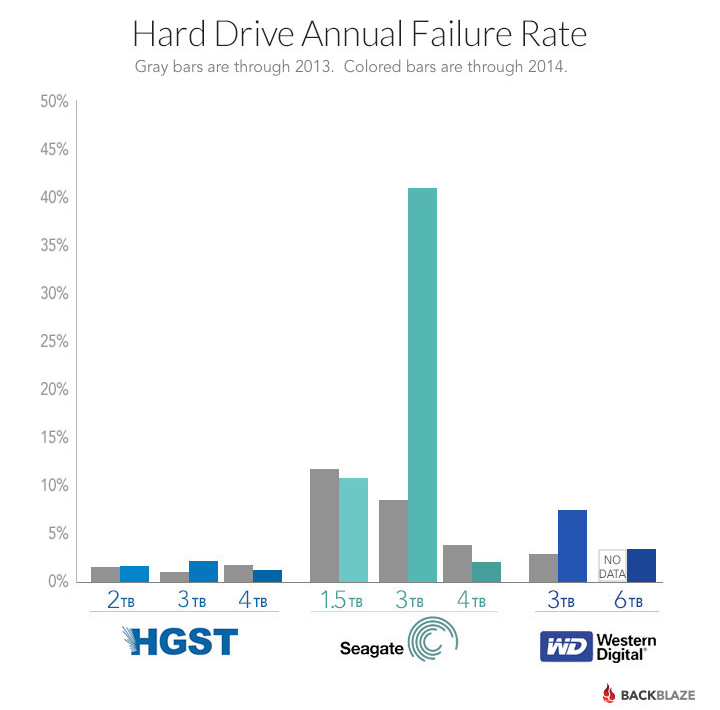

I came across this yesterday:
Original article link:
http://www.infoworld.com/article/28...n-digital-hgst-most-reliable-hard-drives.html
I assume problems with a "regular" HD might show up in hybrids as well. Now I'll probably find out that InfoWorld just got a big contract with WD/Hitachi…not that I'm cynical or anything. 😉
I guess the moral of the story here is to stay away from Seagates with sizes less than 4TB.
That's their desktop drive line. The seagate laptop sized drives seem better.

I surely hope for Seagate's sake that data isn't true. Personally I'm a little suspect.

I think someone disputed the Seagate data in another thread. I don't have the link, but I don't think I'd give that report much validity.
However, they do seem to be having a fair amount of more problems than the other vendors quality wise. I hope they resolve their problems. I always used to like Seagate.

There are a number of critiques about that article on the web, like this:
http://www.theregister.co.uk/2014/02/17/backblaze_how_not_to_evaluate_disk_reliability/
Some of the Seagate's were apparently quite old.
The trouble with people who aren't prepared to read linked information …
From that February 2014 article – How NOT to evaluate hard disk reliability: Backblaze vs world+dog:
"… Henry Newman does a great job of digging into the guts of the Backblaze analysis and pointing out the shortcomings in their approach. …"​
From Henry Newman's January 2014 article:
"… This is never discussed in terms of: does Backblaze have a burn in period? …"​
That's really not a great job of digging into the guts of the Backblaze analysis. It seems that Newman did not follow the links offered by Backblaze.

I said it before and I'll say it again: He who lives by the third party review dies by the third party review.
Tha Back Blaze article has been criticized by more than one source, with one arguing it was a marketing stunt by the company to draw attention to themselves. The failure rate of Seagate's is abnormally high, and I think so abnormally high it draws attention and scrutiny to the article itself.
That graph showing Seagate with a failure rate > 40% seems just a weeeeeee tiny bit unbelievable to me.
There are a lot of critiques of the Backblaze article. Apparently one of the drive's they're basing the claims on was a Seagate drive that Seagate had problems with and may have warrantied.
A real manufacturers sample wouldn't be based on a single or few models it would be based on all product lines.
That "article" also seems to be missing a few brands. Toshiba and Fujitsu come to mind. How do you conclude that you've done decent tests on drive brands and determined who's the best when a few major brands aren't even included.
I did notice, however, that the Backblaze logo in on the graph (free advertising!)
