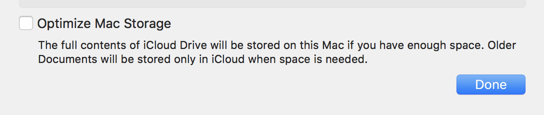

I think it was mentioned in the other thread, but where you went wrong was turning on this Optimize Storage setting in iCloud Drive. What that does is if your local disk starts to get full, it moves files off your drive and into iCloud Drive and just leaves that placeholder link in its place. Then if you need that file back, you just click and it gets pulled back in from iCloud. I have that turned off because I want all my files kept on the local drive.
