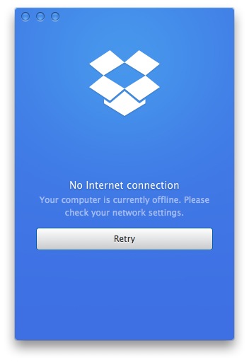

Hi, I came across a Dropbox app in the PPCAppStore, so I downloaded it and tried it - I make extensive use of Dropbox, and it would be just be too good to be true to have such an app work. I had to try it.
It is not too successful, reporting:
... and that is all. My Quad is most definitely on the net, via both WiFi and Ethernet.
Does anyone know what Dropbox is looking for that would cause it to emit this message, or perhaps any other workarounds, or perhaps even some other program entirely that provided access to Dropbox.
Thanks!

It could be any number of things, but I'd advise you not to get hopes up.
For about two years after Dropbox dropped support for PowerPC, we had a dev who was able to reverse engineer the app and keep things working. Then the difficulties just got more and more difficult and as this was not a full time job for them, that was it.
All you can really do is share the Dropbox folder (or your root drive) from a Mac or PC that IS capable of using Dropbox.
But for PowerPC. Sadly, it's long done.

Fileferry should work on 10.5.8 (it does with at least some supported websites on 10.4.11), but you do need PowerPC ports and it will be a pain to set up, though less so on a Quad

@Dronecatcher uses a free swissdisk online drive to access his stuff on his PPC boxes back to os9 using mac connect on OSX and Goliath on os9. Its not dropbox but is a functional alternative.
The last time I tried SwissDisk in OS9 it wouldn't connect - either the service was down or more likely it's no longer compatible.
As of today (03/09/25) Goliath and Finder/WebDAV still connect to SwissDisk on Tiger.
Last time I was dabbling, after SwissDisk failed, I used myDrive - which was even working on Windows 98!

Hi @Dronecatcher, I created a SwissDisk account and waited until they emailed me that it was ready. Then I tried various ways of connecting to it from Goliath under Sorbet Leopard. Nothing seems to work. I tried putting the following into the Goliath URL box:
swissdisk.com
webdav.swissdisk.com
Neither worked, although the last of the two didn't fail explicitly. Instead, I got a spinning gear progress wheel inside the app that simply never stops.
Can you respond back here with what exactly you typed into the Goliath URL box to get it to connect to SwissDisk?
Thanks!
For SwissDisk, URL is:
**** being your user name
I just tried myDrive in Goliath and it wouldn’t connect, however through Finder’s Connect To Server function, the URL is:
https://disk.swissdisk.com/****
Thanks @Dronecatcher, it worked! Using Goliath 1.0.1 on my Sorbet Leopard Power Mac G5 Quad, I was able to login to the SwissDisk account I created a day or so ago. This is an excellent result, and I thank you again for the help! This is cloud storage accessible from Sorbet Leopard, which is wonderful!
It gets better though! The same URL, put into Finder's "Connect To Server" dialog works perfectly too, and from both Sorbet Leopard on my Power Mac G5 Quad and from macOS Monterey on my Mac Studio! So, we now have not just cloud storage for the Power Mac G5 but also shared cloud storage between that Power Mac G5 and my Mac Studio. This is even better!
