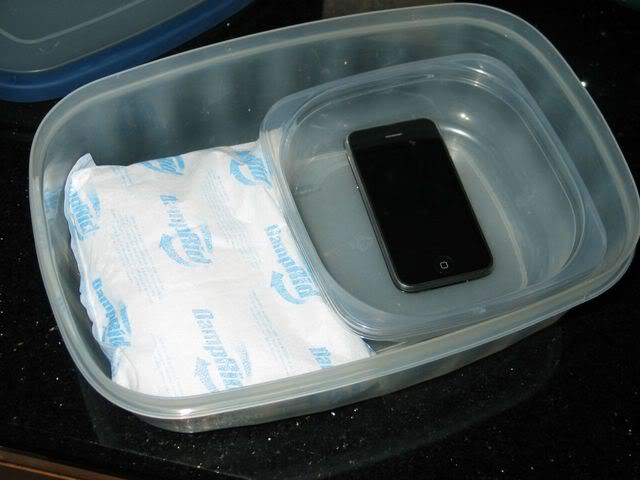

After reading through the thread, I'm going to go get some DampRid and seal it in a tupperware container for the next couple days.
Here's a pic of the setup.. luckily I have a girlfriend who cannot collect enough containers 🙂 She reminded me that DampRid will actually turn to liquid once it's collected enough water, hence the container within a container scheme I have there. I don't really expect there's that much water in the phone, but you know, better safe than sorry. Picked up the DampRid at Target for $5 for a 2-pack.
Will let everyone know how it goes.. I love this thread.. seems to be a lot more success stories than I was expecting..
Don't want to jinx myself, but, after leaving it in the DampRid for just shy of two days, today I plugged my iPhone into the connector cable attached to my computer, and voila! Apple logo, a bunch of missed messages, and two voicemail. Interestingly it couldn't find AT&T until I rebooted (it might have found it on its own eventually but I got impatient).
Everything works, including the mic, speaker, touchscreen. I am so happy! 😀
