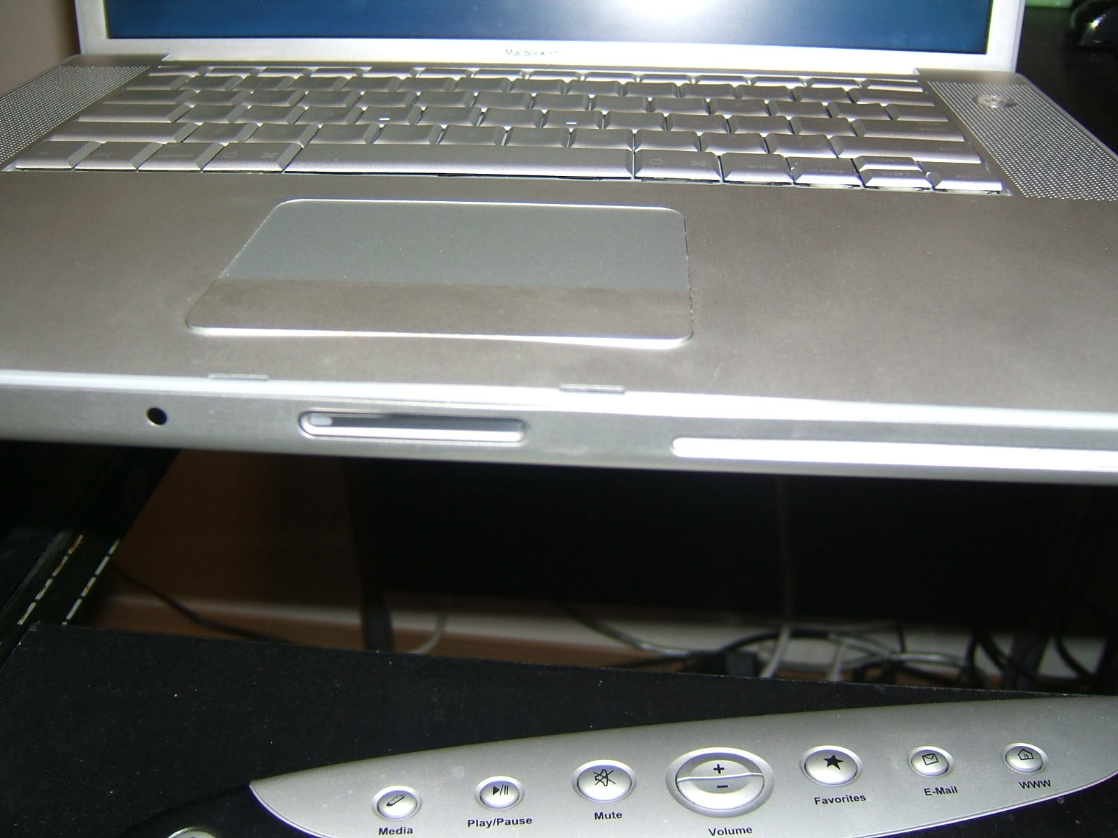

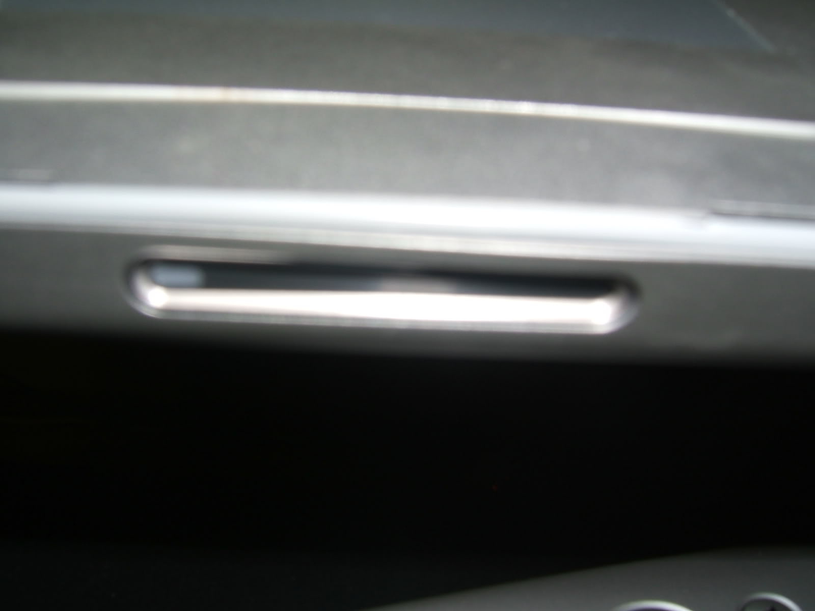

You can see where the case bubbles up a little where it fell, almost aligned with the center of the trackpad.
Thoughts?
If you removed the bottom casing, you could to a little bit of gentle bodywork, but I would NOT have the cajones to try that myself. Or maybe I would, if I new I had to take it in for repair anyways. Ultimately, if you have Applecare coverage that can be voided by the above or similar advice, take it to the shop.

Before you take it apart, I'd try pushing down on the plastic "bubble" while pushing the latch button IN to see if you can get it to realign itself.
Otherwise, its about a 20-30 min project to take the casing off and put it back together.
Check out the Hard Drive upgrade video for the Macbook Pro to get an idea of the work involved to get the case off.
