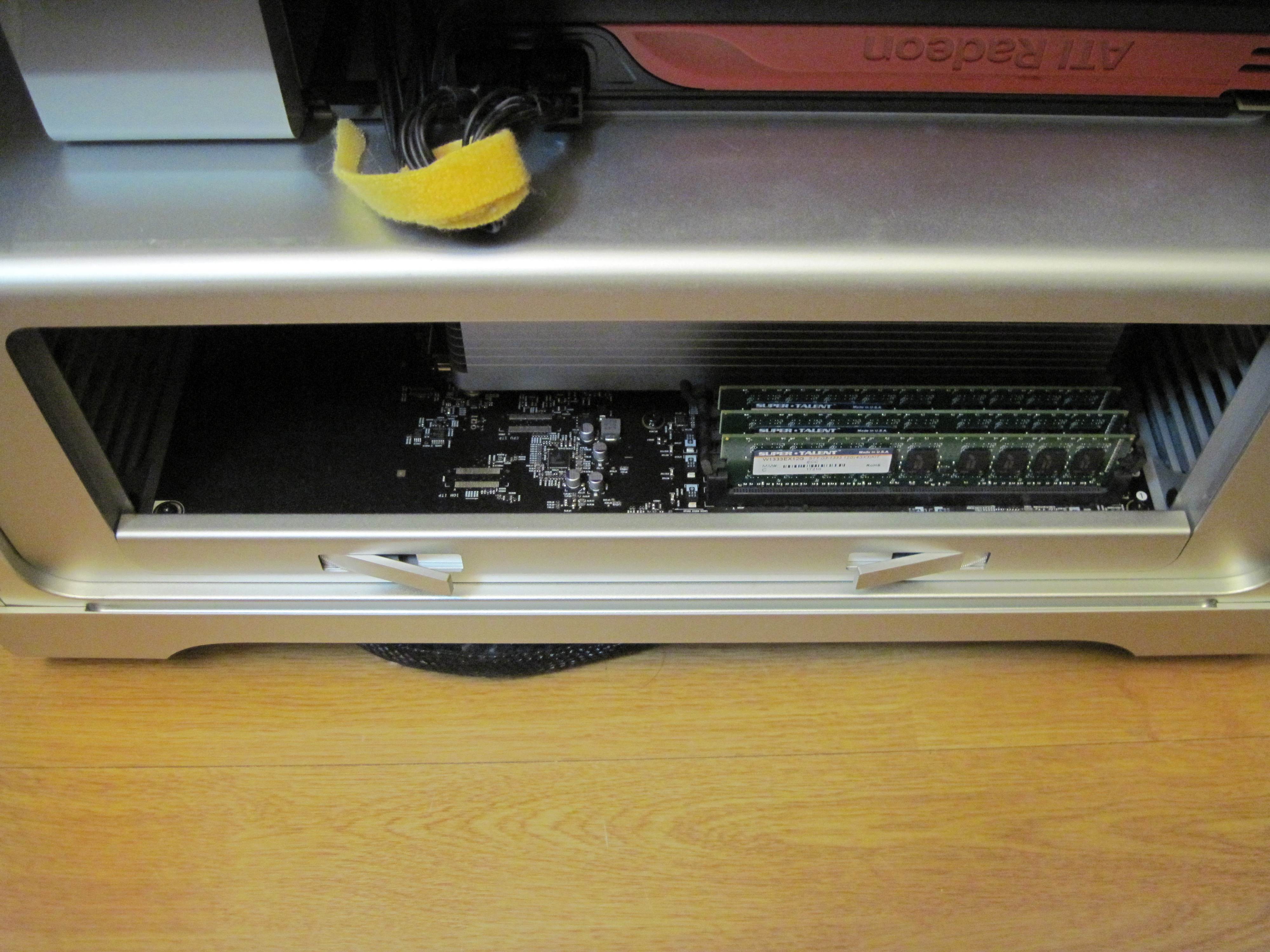

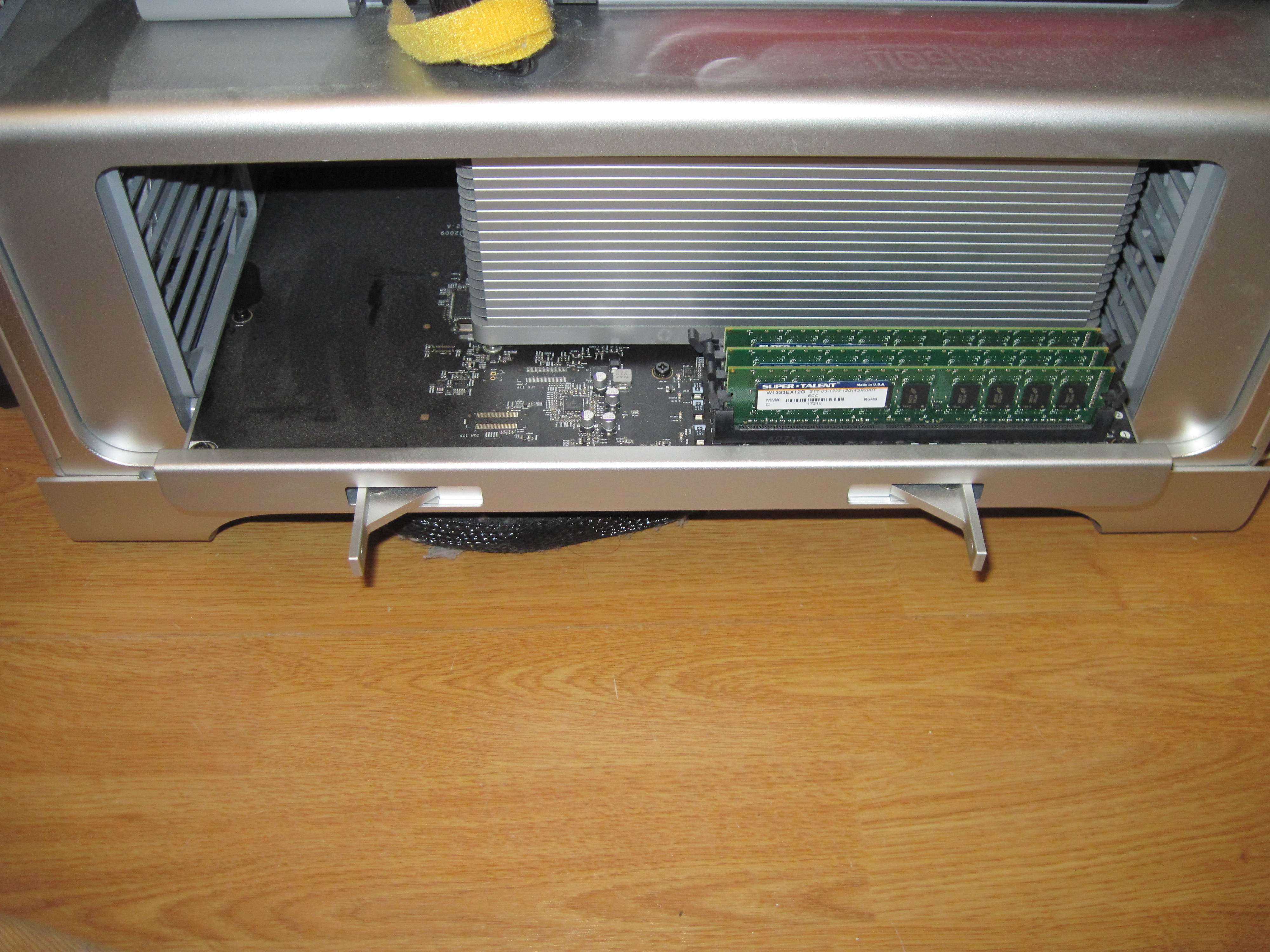

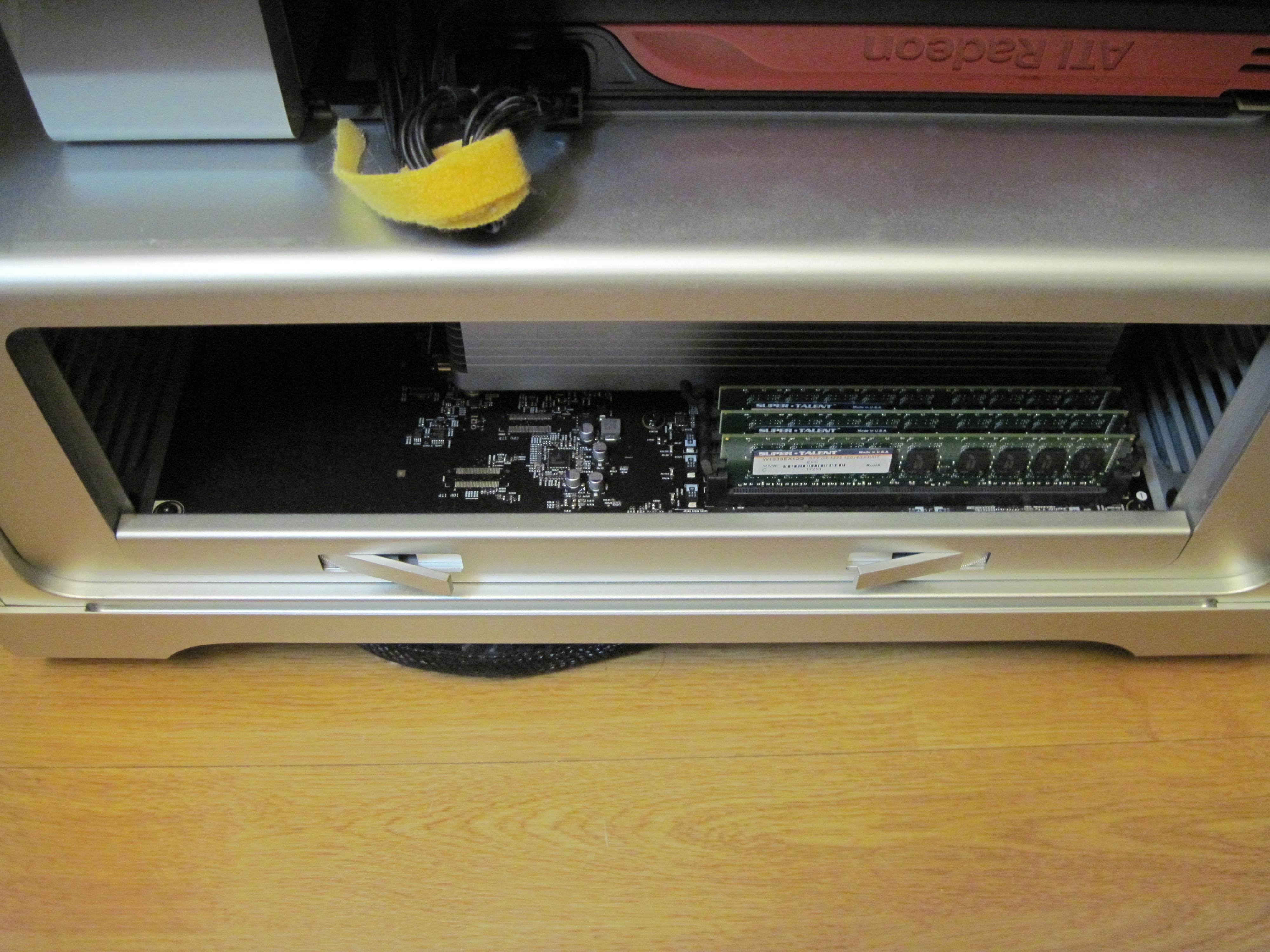

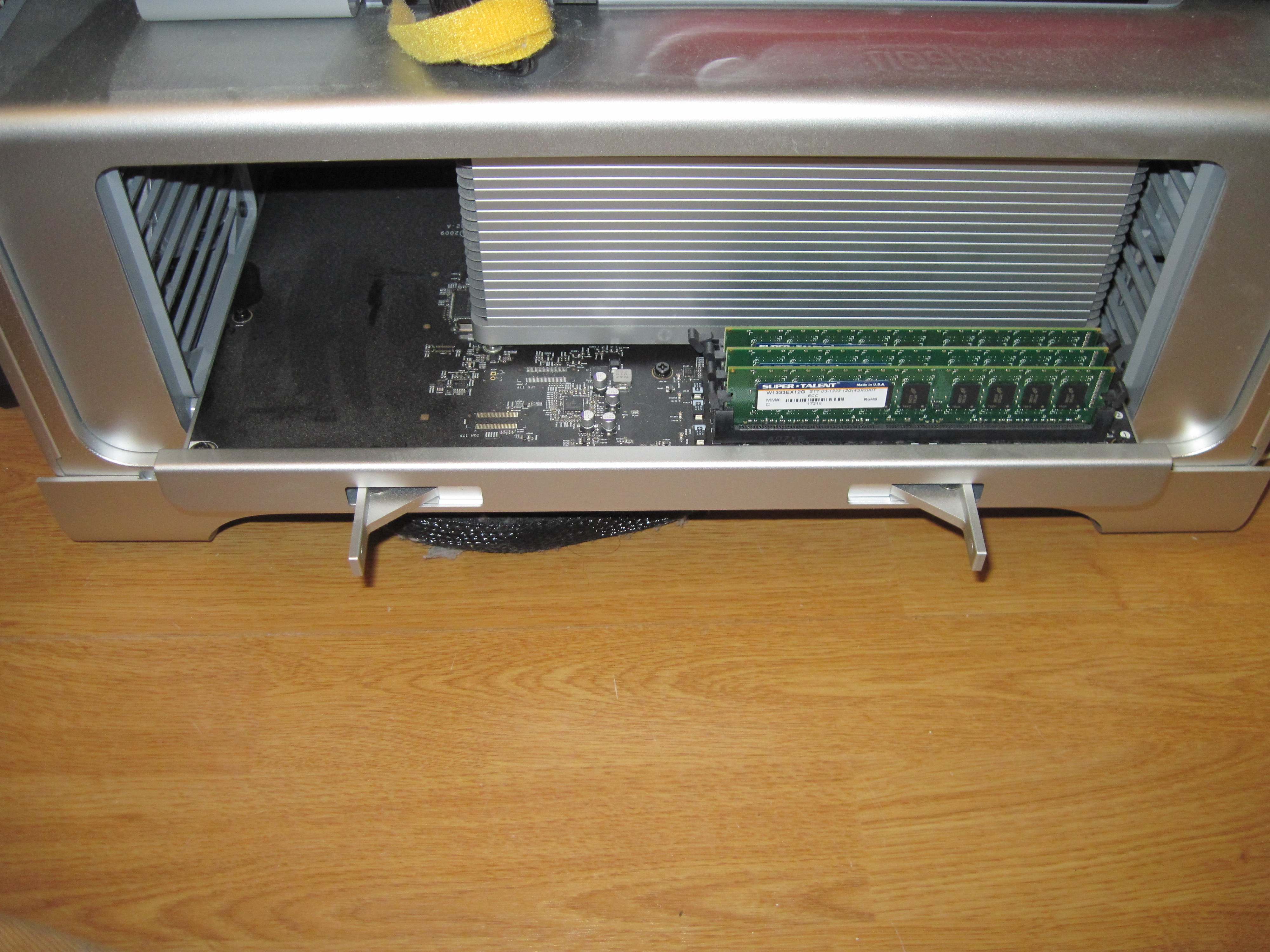

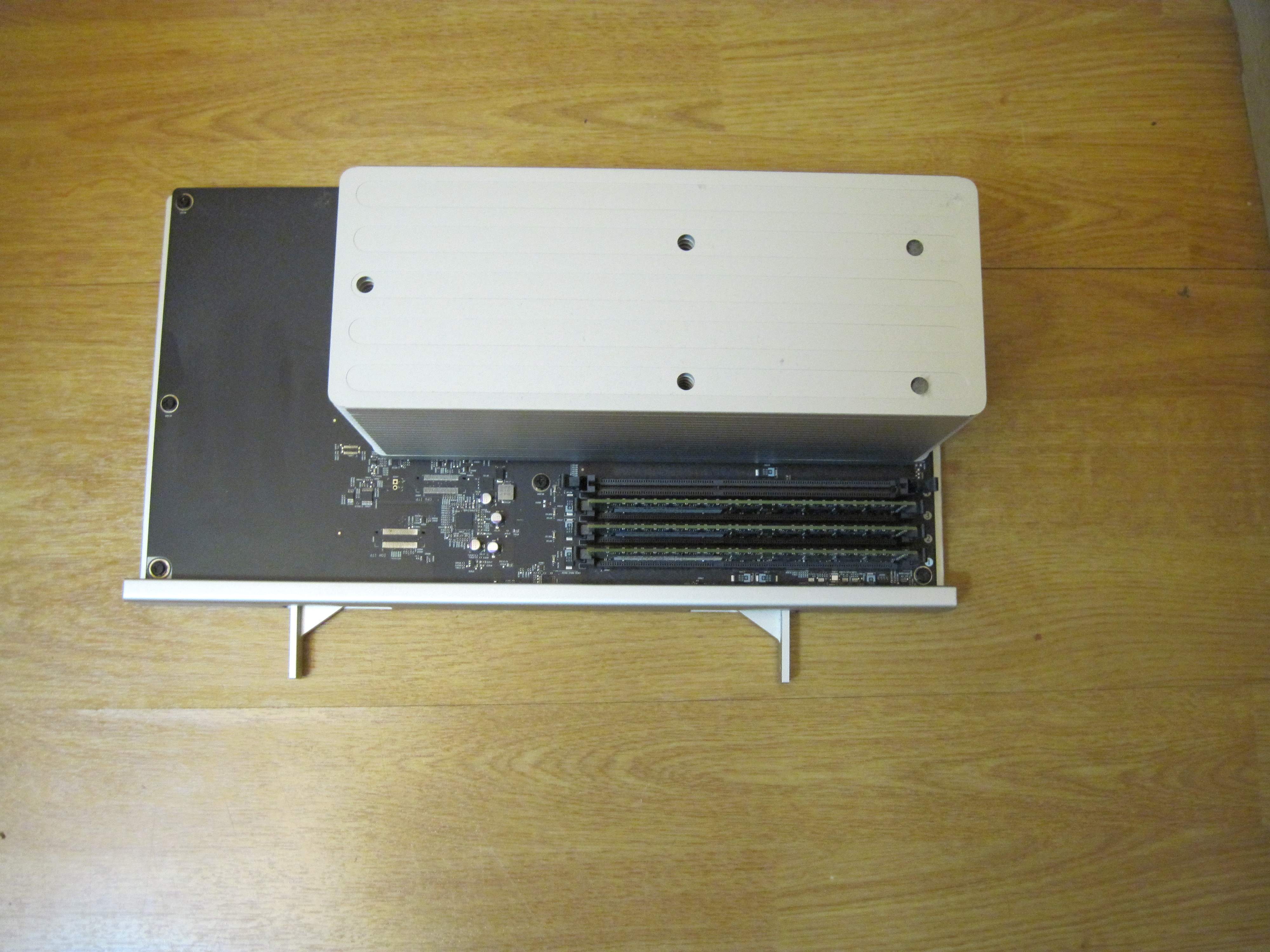

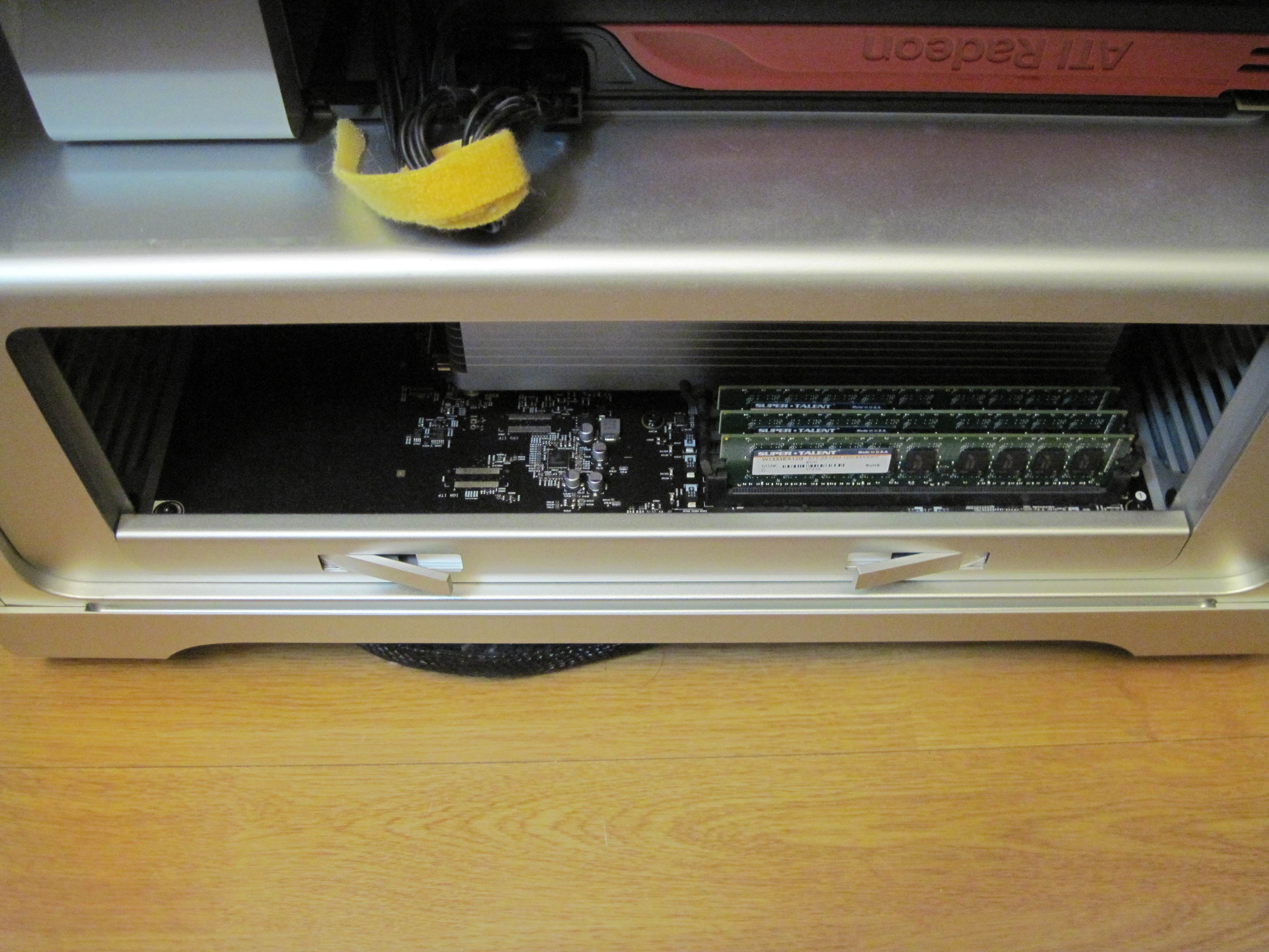

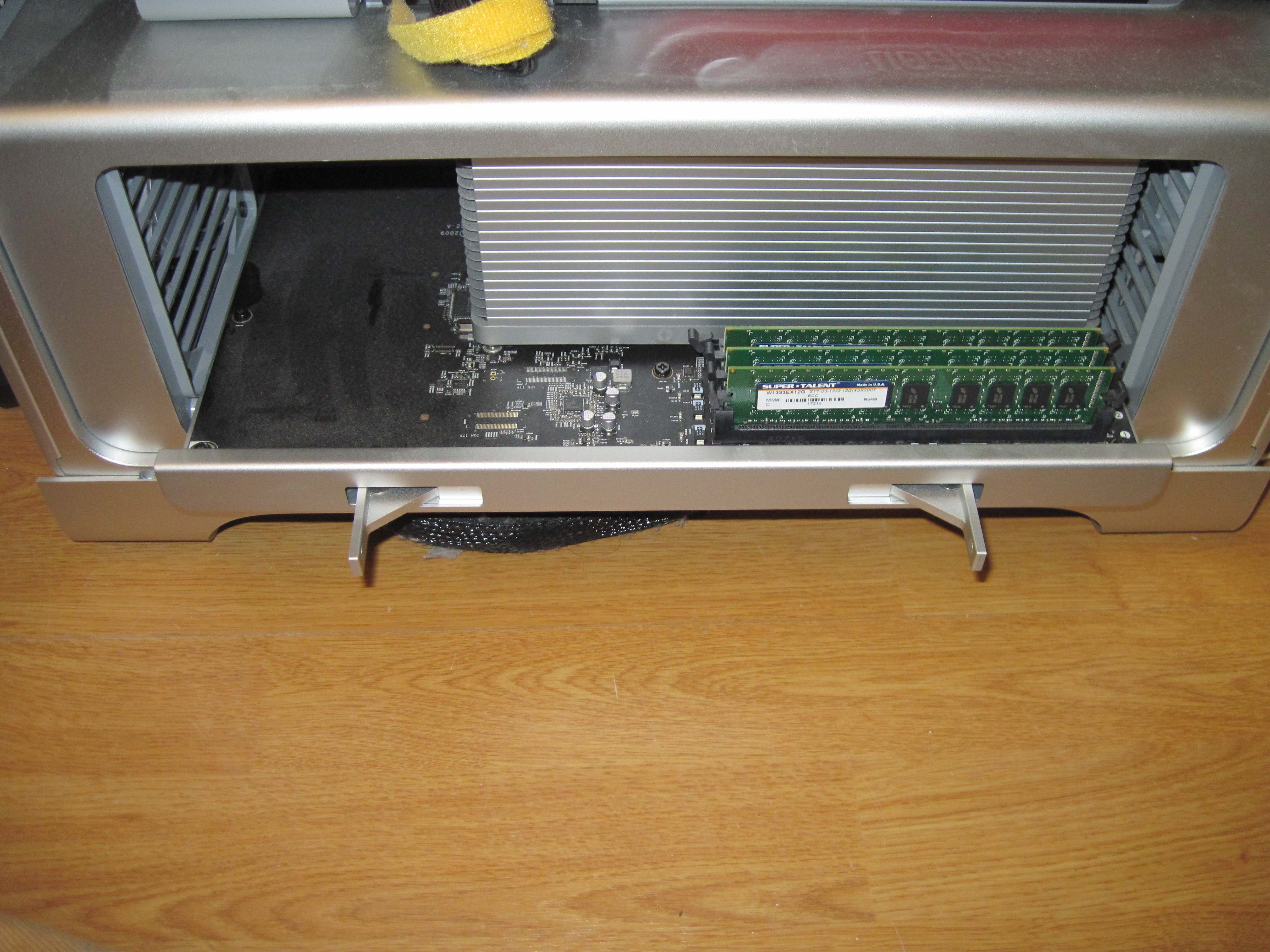

Okay I never did a cpu install on a mac pro so today I did a dry run. I simply opened the quad 2.8 Ghz 2010. Open the latches pulled the tray dusted with a canned spray and put everything back. Then booted and started this thread. some photos.
This is the first photo second photo third photos.
1) Open two latches.
2) start to pull tray out

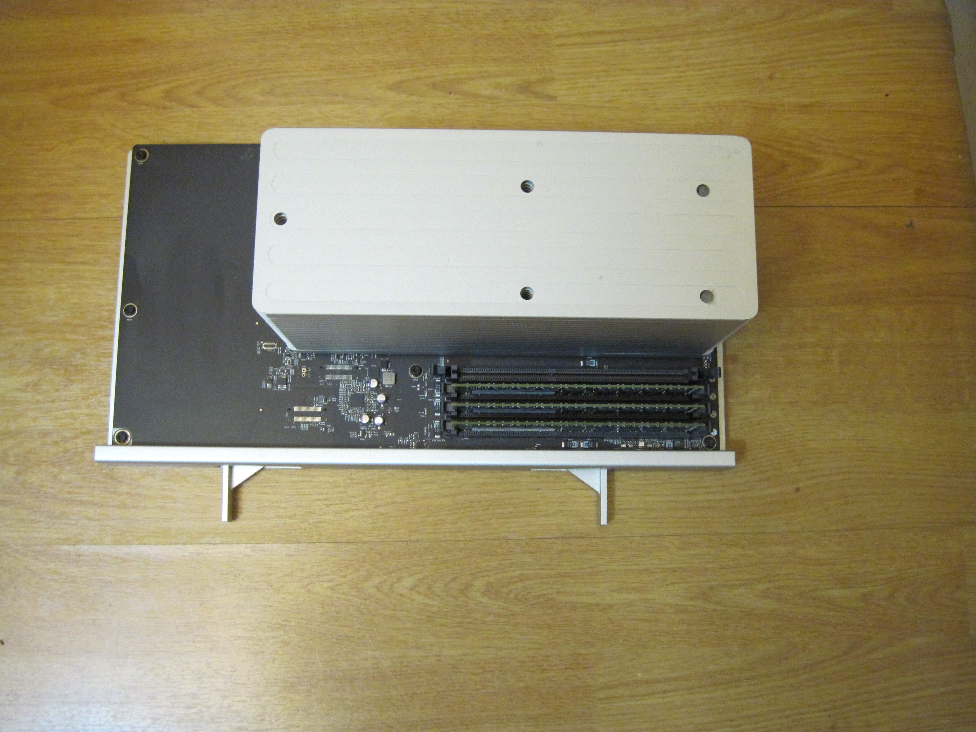

3)pulled the tray out
At this point I saw that my hex wrench needs to be of extra length. So I dusted the pro out and reassembled. The view of the pulled tray shows 5 holes all need a hex wrench same size but a longer type. Not to worry I am not looking to rush this. oh a shot of the cpu and a nice fan which I will get to sell on ebay making the project cost less.

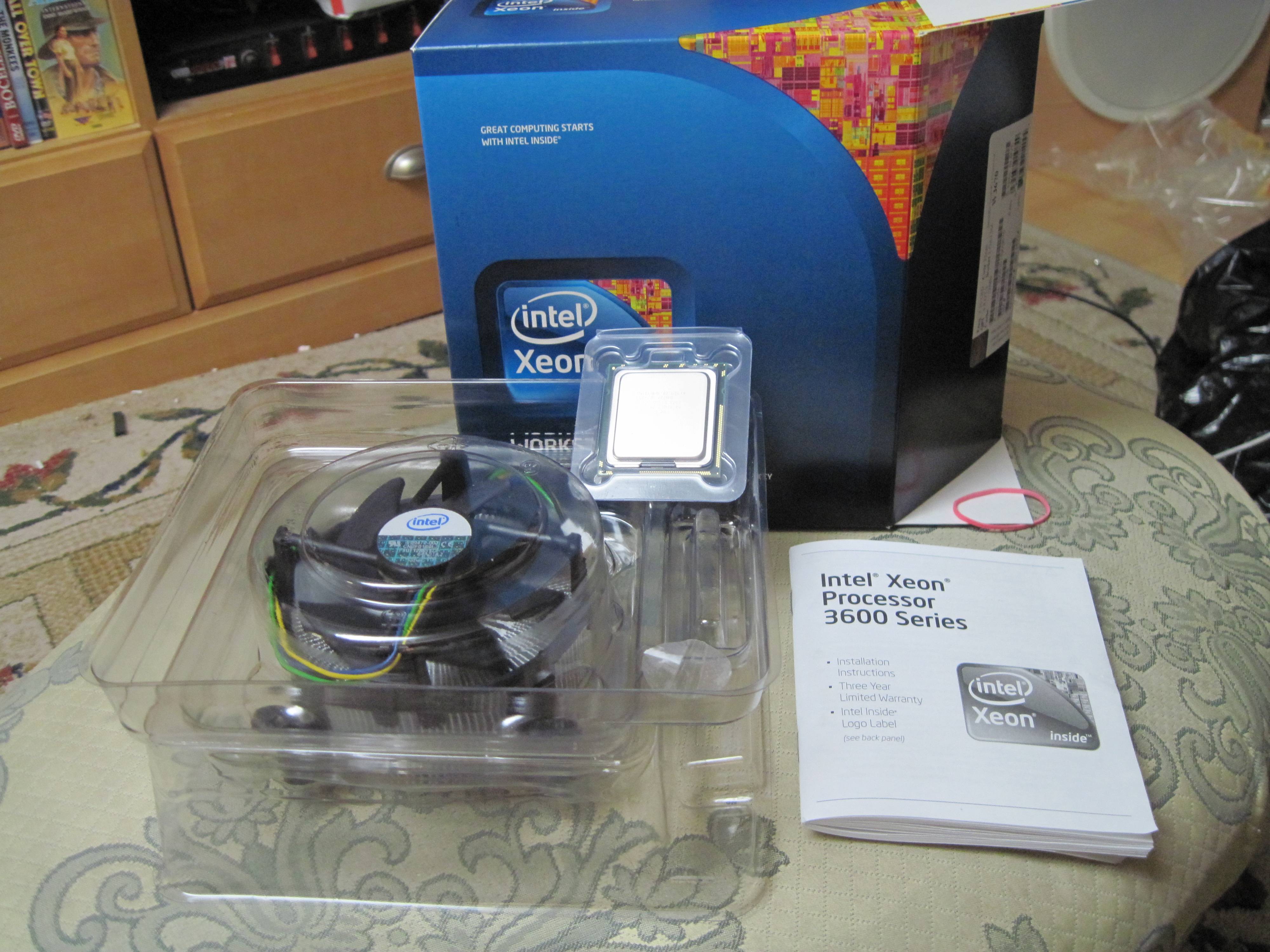

I don't think you'll be able to use that heat sink that came with your CPU. I did some research while exploring new fans. Exploring the stock heat sink is something I did too. Apparently the CPU board has 3 contacts that the fan connector mates up against once the stock heat sink is properly secured. Just an FYI.
It's too bad too I'd love go put a different heat sink on my 2010 Pro!

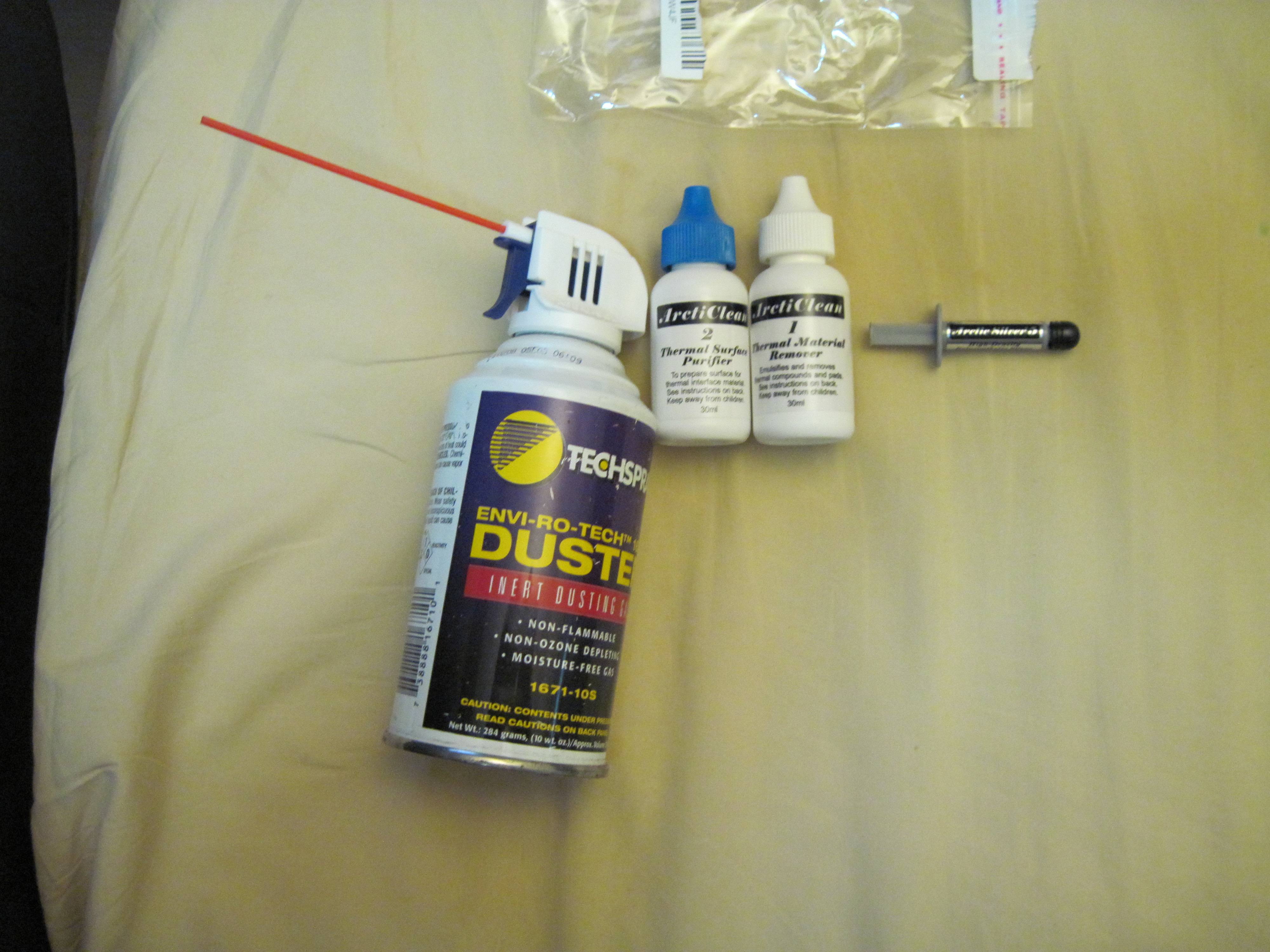

phillipma1957 - just make sure you clean off the old thermal paste well (rubbing alcohol is all that's in the ready-made wipes, so you don't need to go get a specialty product), and apply a new coating of a decent thermal paste (arctic silver 5 is a well regarded product if you don't already have something on-hand to use).

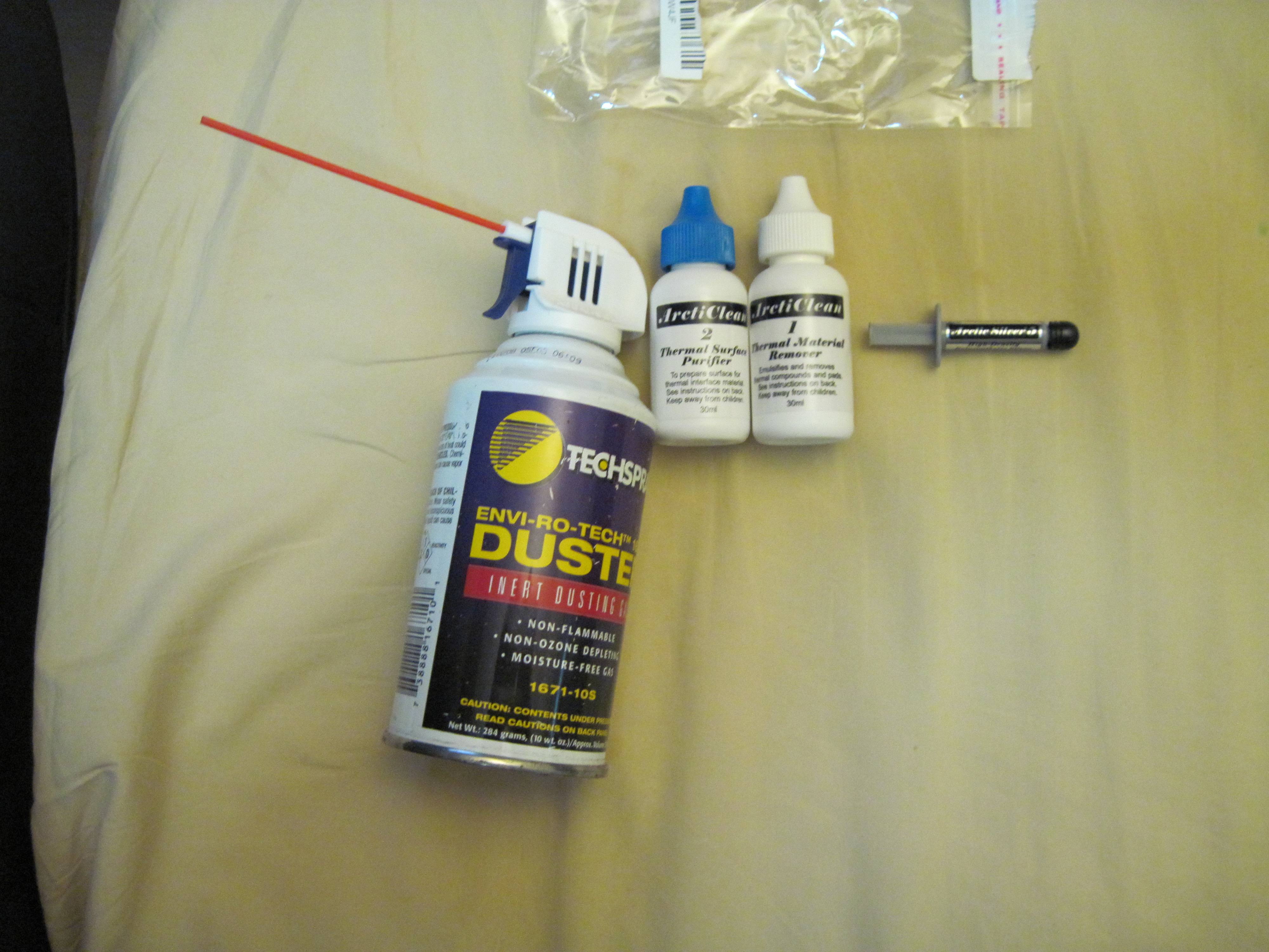

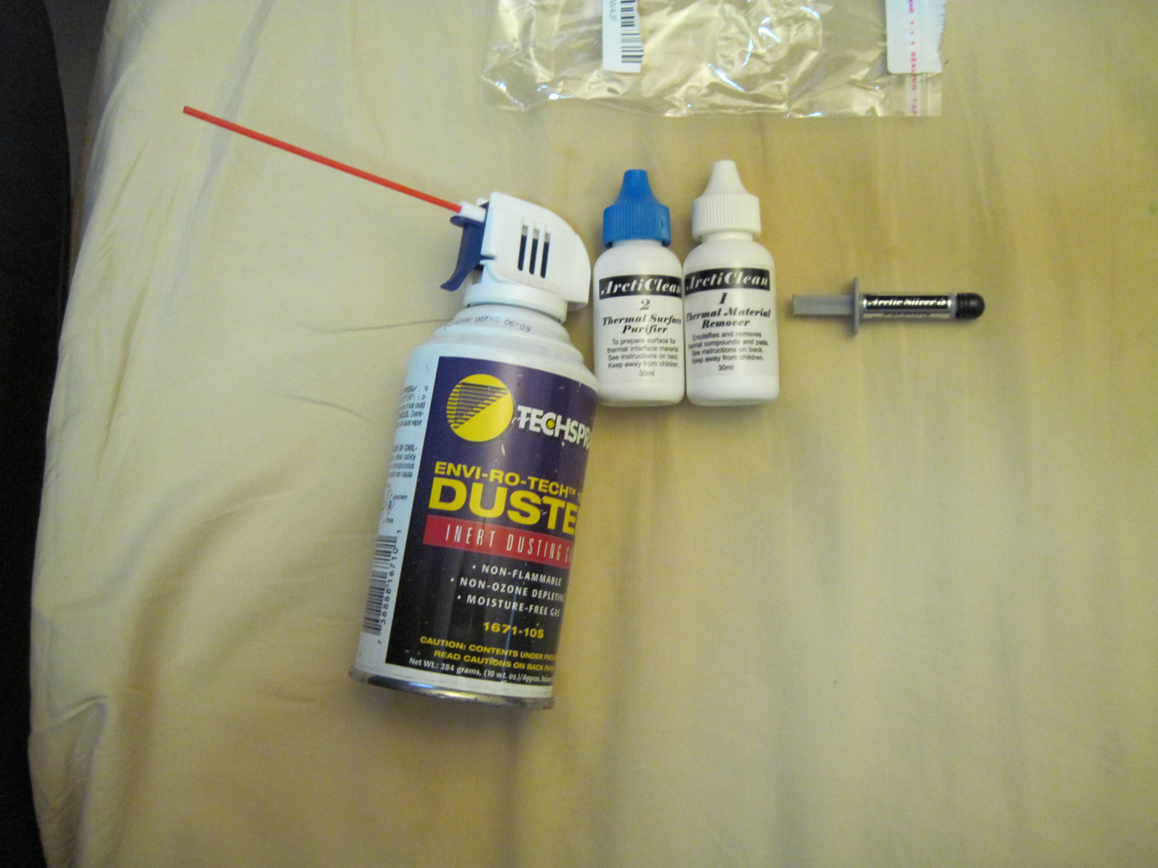

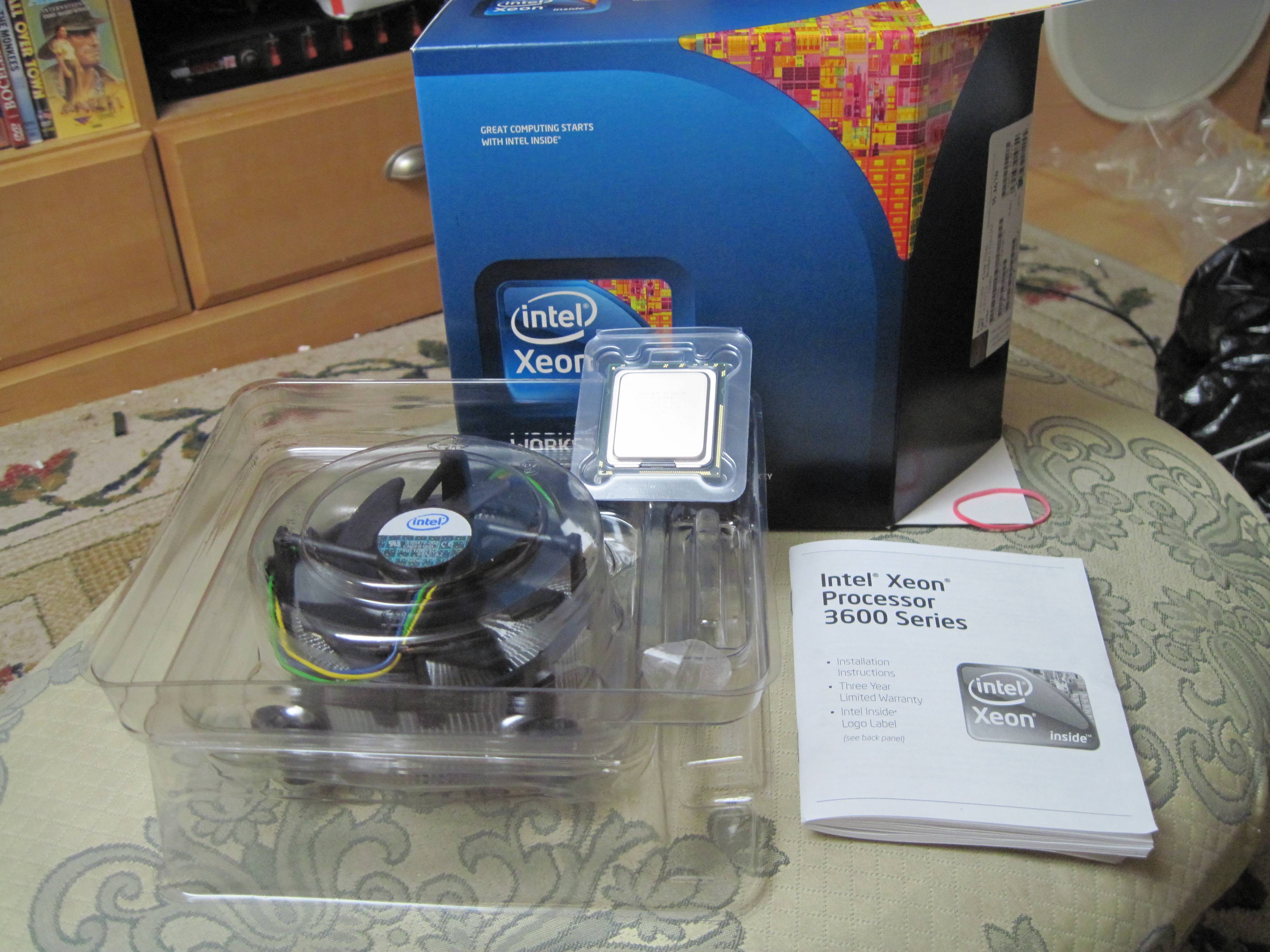

The fan heat sinks go for ten to twenty bucks on ebay. I just may hold on to it. here is the canned air cleaner and the arctic silver kit I am using.
(amazon sold the full kit for 10 bucks)

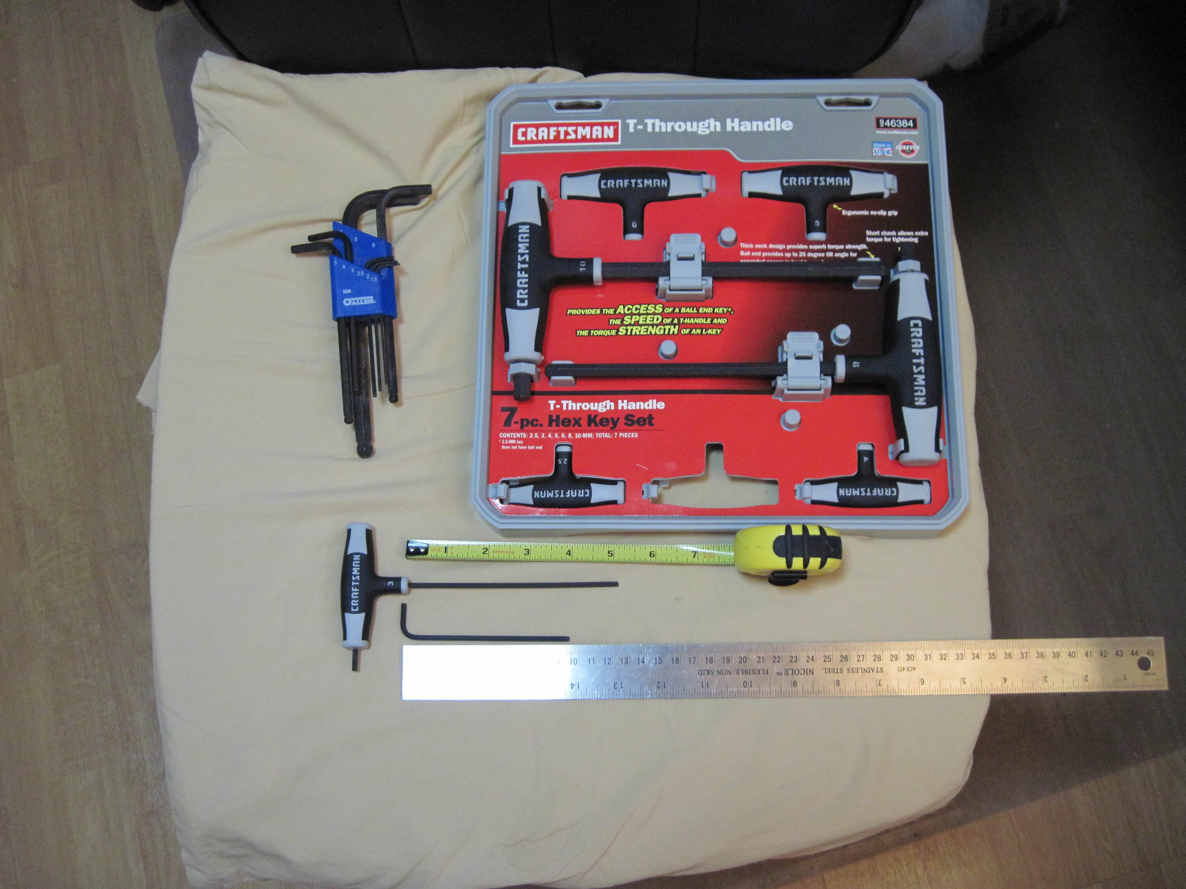

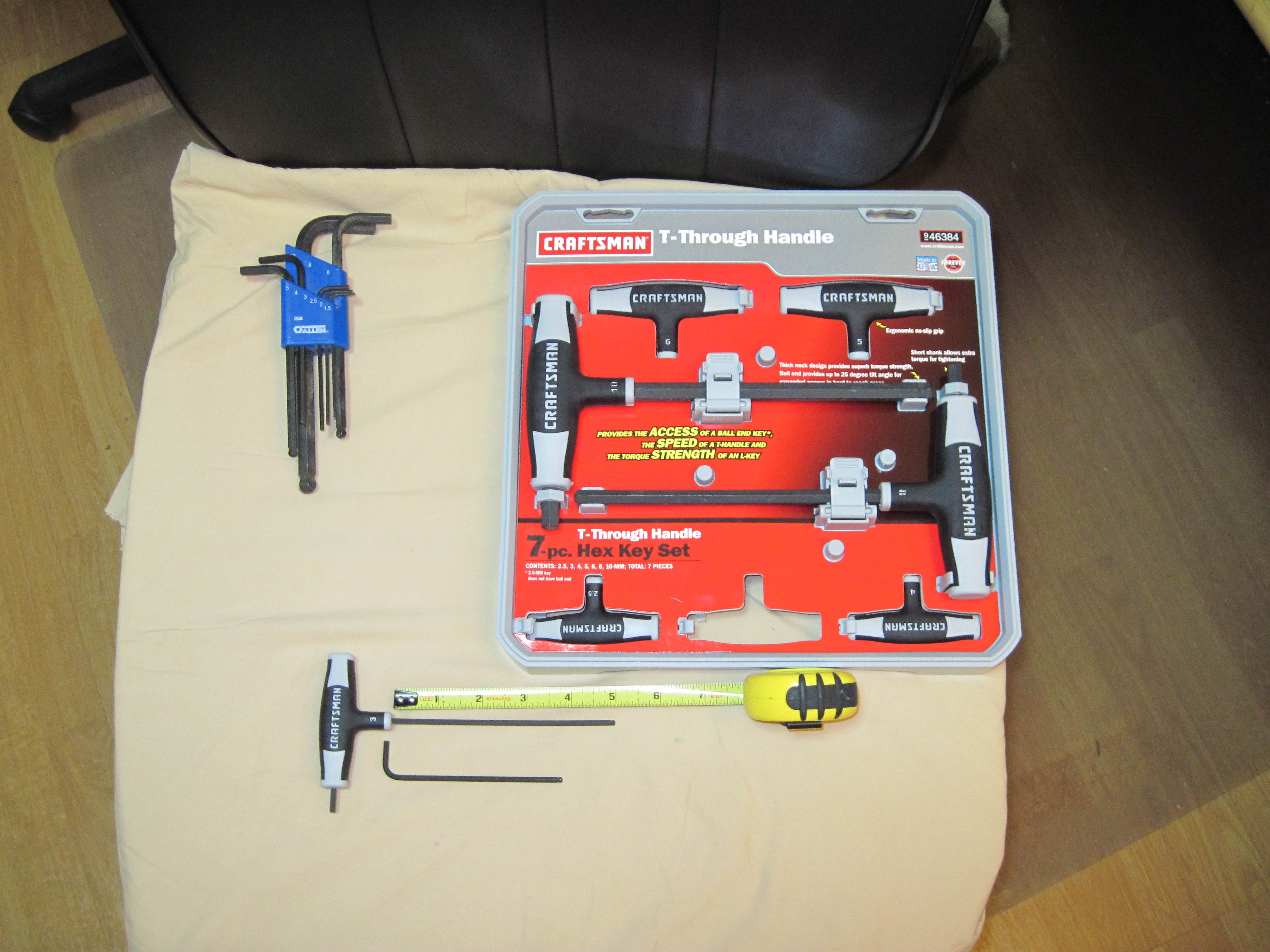

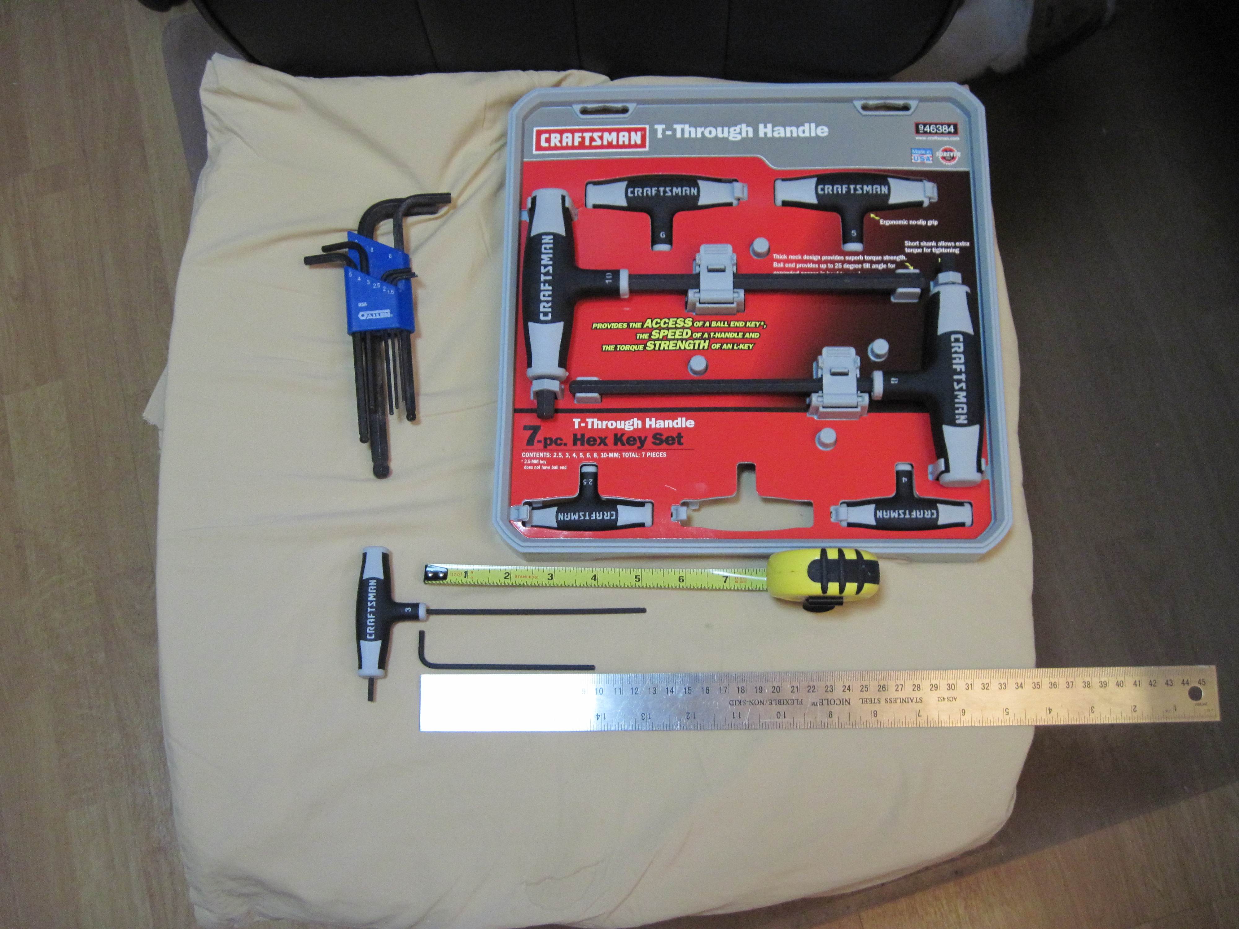

I will need a long hex maybe 5 inches to reach the hex head on the 5 screws. I will pick one up this weekend.

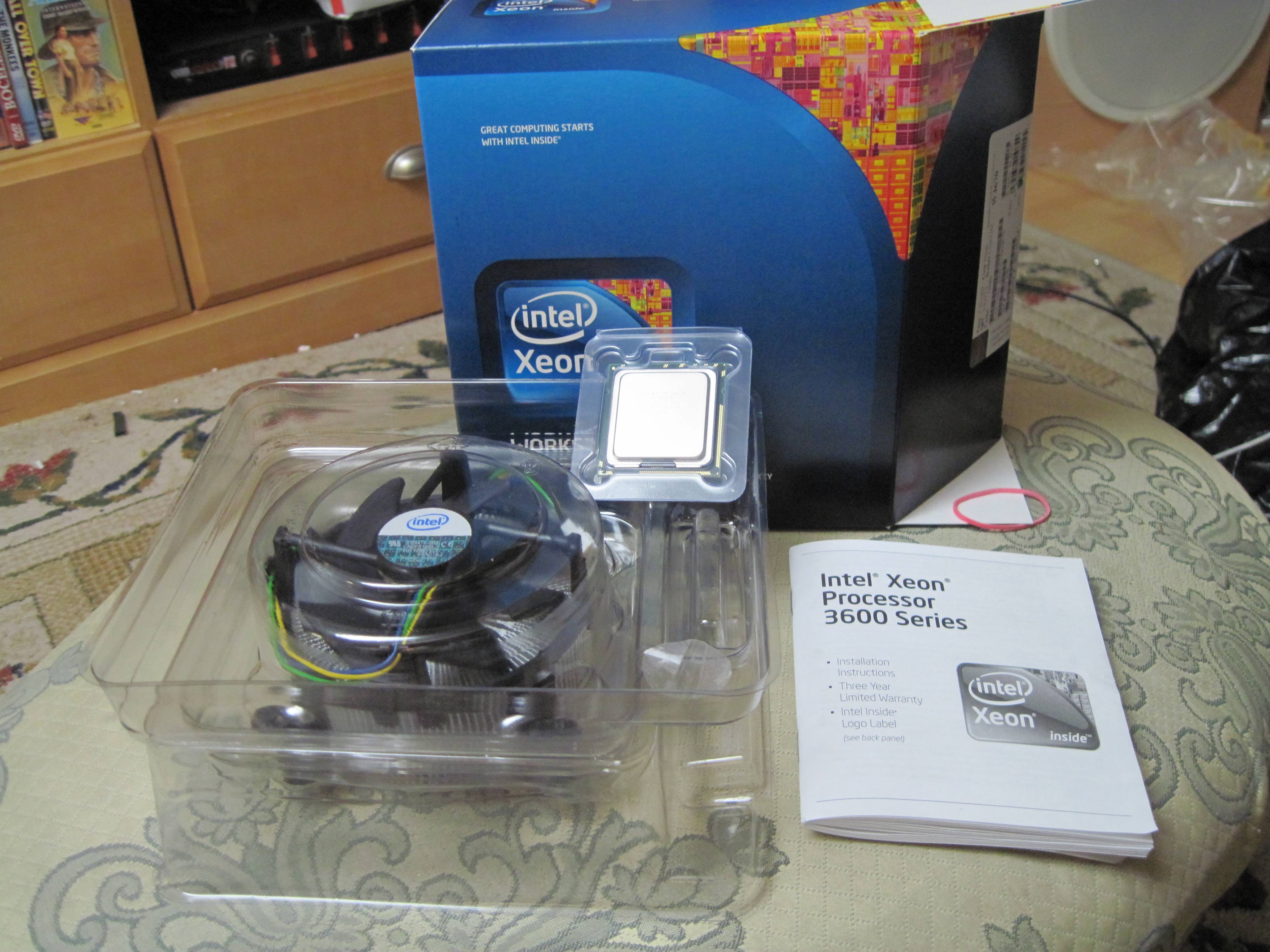

A quick update. this cpu
http://cgi.ebay.com/NEW-Intel-Xeon-...EN_Servers&hash=item230e914a2e#ht_3265wt_1250
from a real ebay seller with a real warranty for about 620

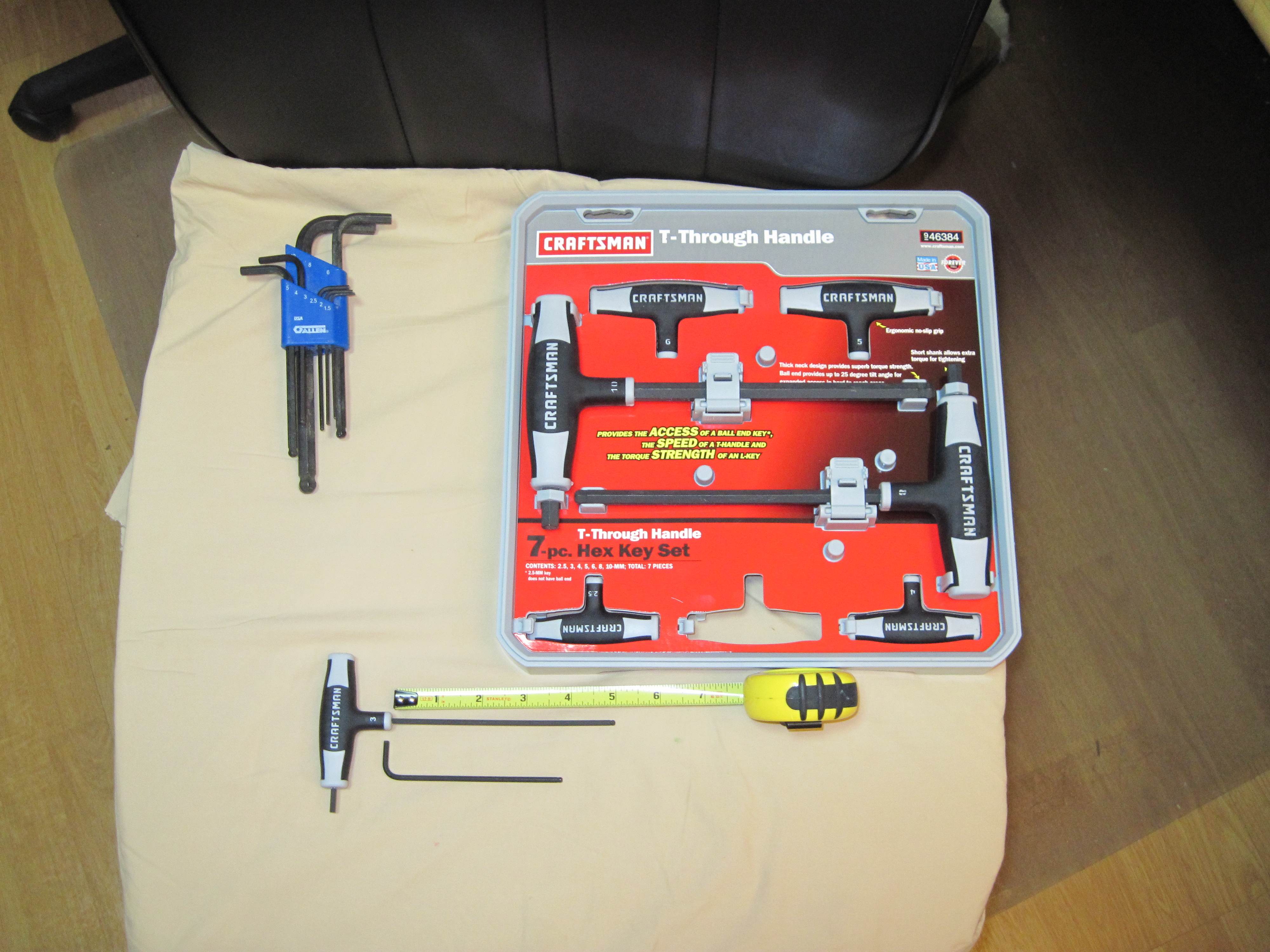

I purchased this set of allen wrenches
http://www.amazon.com/Allen-Wrench-...APCM/ref=sr_1_3?ie=UTF8&qid=1300662135&sr=8-3
this set of arctic silver
http://www.amazon.com/ArctiClean-3-...1?ie=UTF8&s=electronics&qid=1300662245&sr=1-1
about 25 more total of 645 (usd). Now I got some discounts (100usd) and if I sell the quad 2.8 for 200 (usd). the upgrade will cost about 350 usd.
the two of these (arctic silver kit wrench set) add to over 25 bucks and get you free shipping.

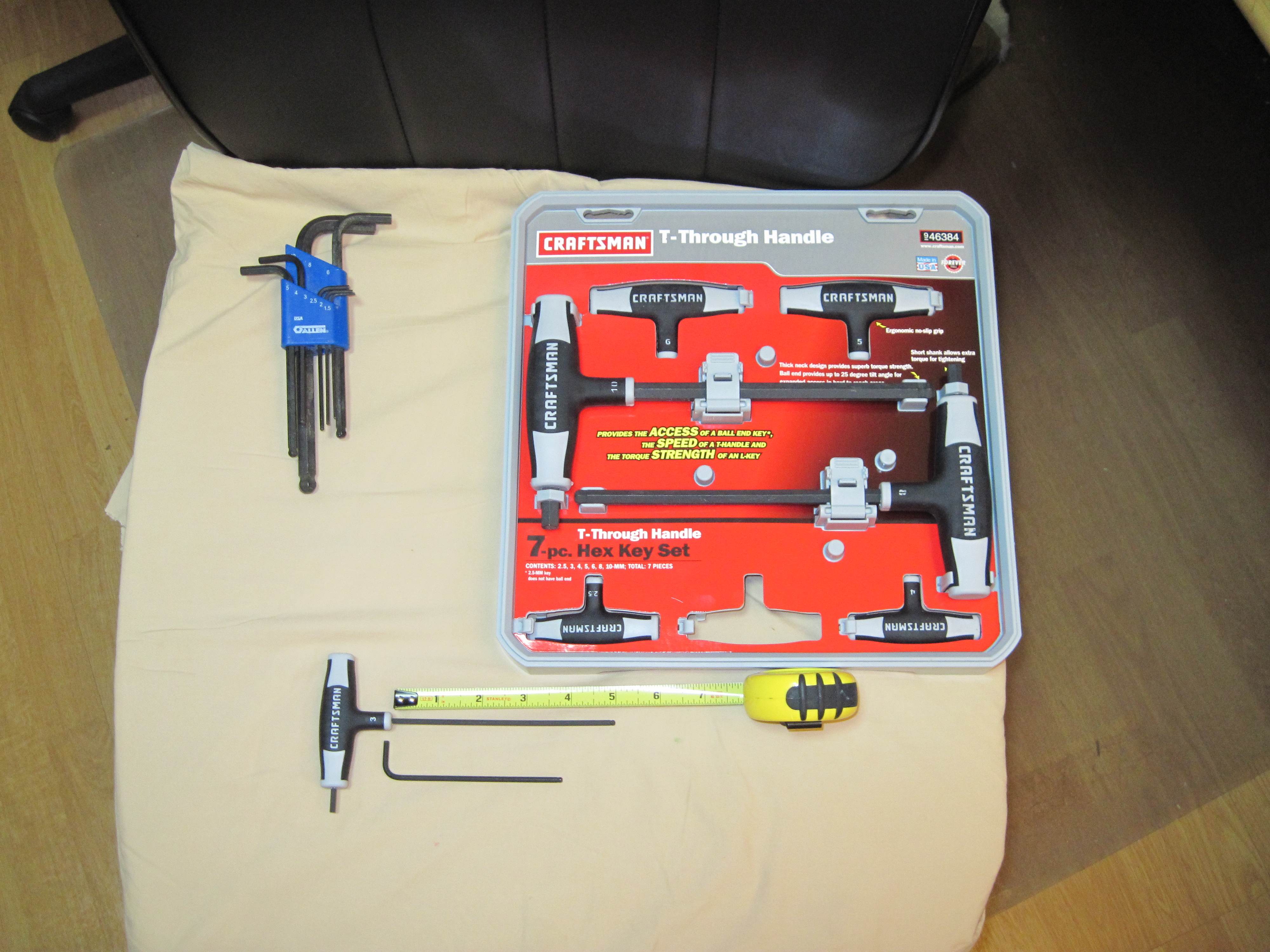

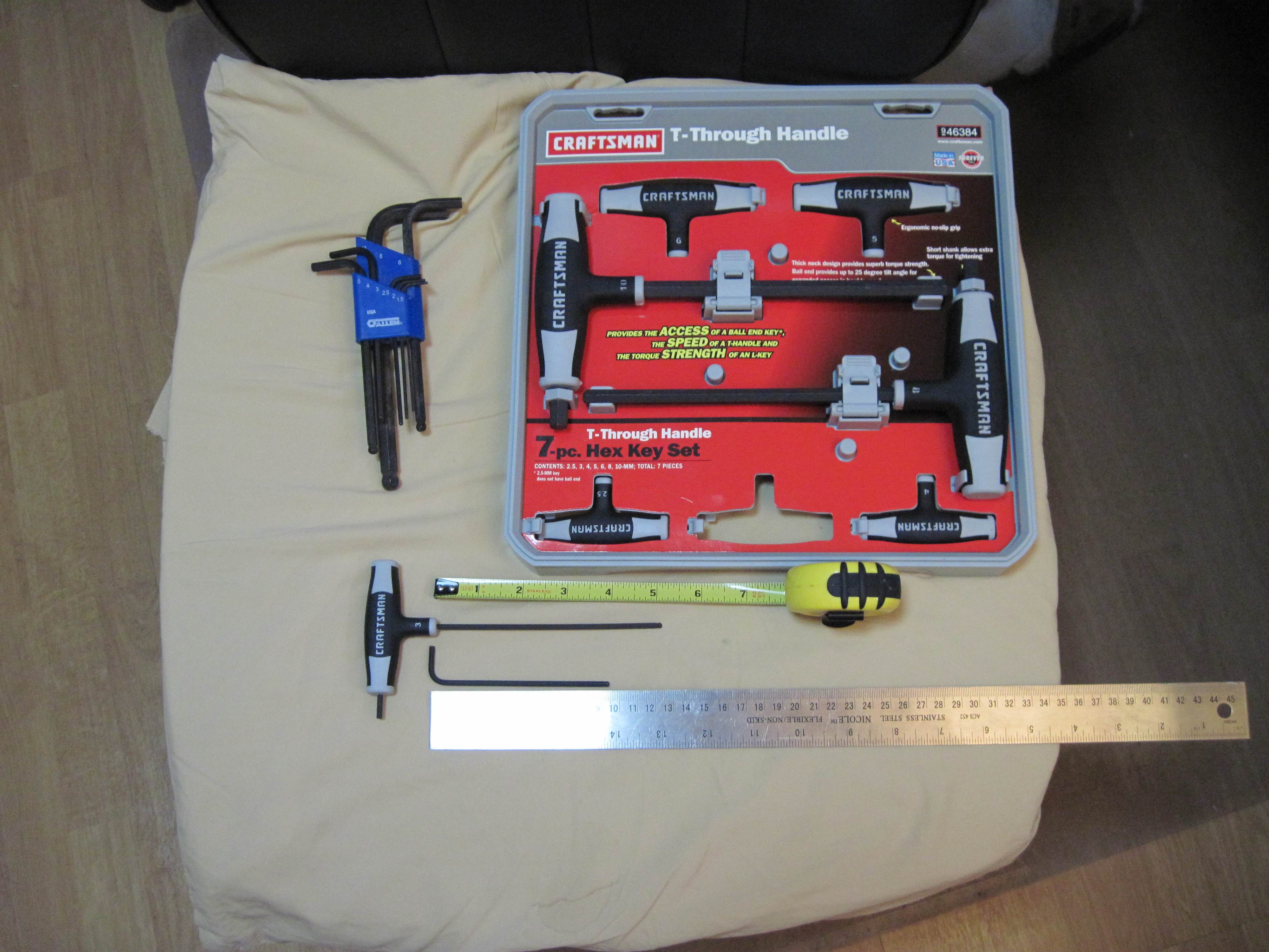

the heat sink needs a 3mm hex wrench see photos. the photo shows.
A short wrench set where the 3mm wrench which is just long enough to work.
about 92 mm or about 3 3/4 inches. that is the long part before the bend. I don't recommend using as it is just big enough.
the sears set is expensive 40 usd I am returning it but i know that the shaft is an inch longer and it fits with ease. Point is some people may just go to sears to buy the wrench set, But since you need the arctic silver just buy it with the wrench set and get free shipping. I hope to assemble this on tues as I need to do something this monday. It will be good to see and compare scores. I have a hex 6 set of scores for a machine with 32gb. I will compare this machine to it as I am curious .

For fans of quality tools: http://www.amazon.com/Bondhus-17099-Balldriver-L-wrenches-BriteGuard/dp/B000E80G7A/ref=pd_bxgy_hi_img_c
or this: http://www.amazon.com/Bondhus-12146-L-wrenches-Length-1-5-5mm/dp/B000E80CGA/ref=sr_1_17?ie=UTF8&s=hi&qid=1300666951&sr=1-17
