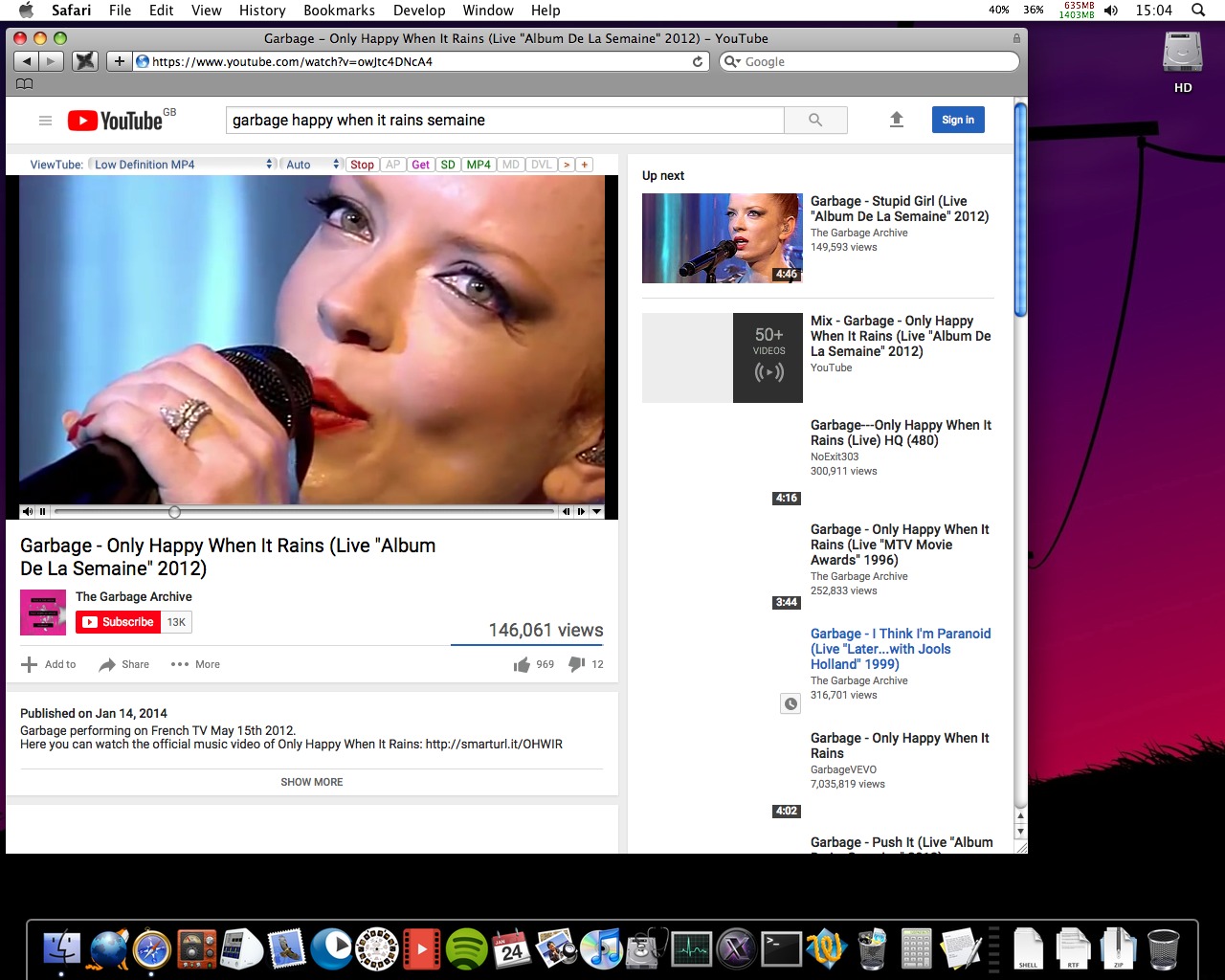

Well, I've been looking for one for a long time and now I've finally found one at a good price (£25).
I'm just blown away by how fast this system feels - apart from hard number crunching, it seems on a parallel with my Dual G5 - that double L3 cache really makes a difference.
It feels very comfortable on the web and amazingly it uses less CPU on Youtube with Webkit than my Core Duo iMac does in Firefox.
It's not as noisy as anticipated either - slightly quieter than my 933 Quicksilver I'd say.
It came with 2 hdds but I've removed one as I want to spare the power supply any excessive effort…but maybe that's just my paranoia 😉
It was originally running Panther and the previous owners appeared to be using it for graphic design and running a business in 2009 - an interesting parallel, as at that time I was designing too on a Dual 1.25 MDD. As ever, no attempt at data security on the seller's part....all safely eradicated now under a new Leopard install.

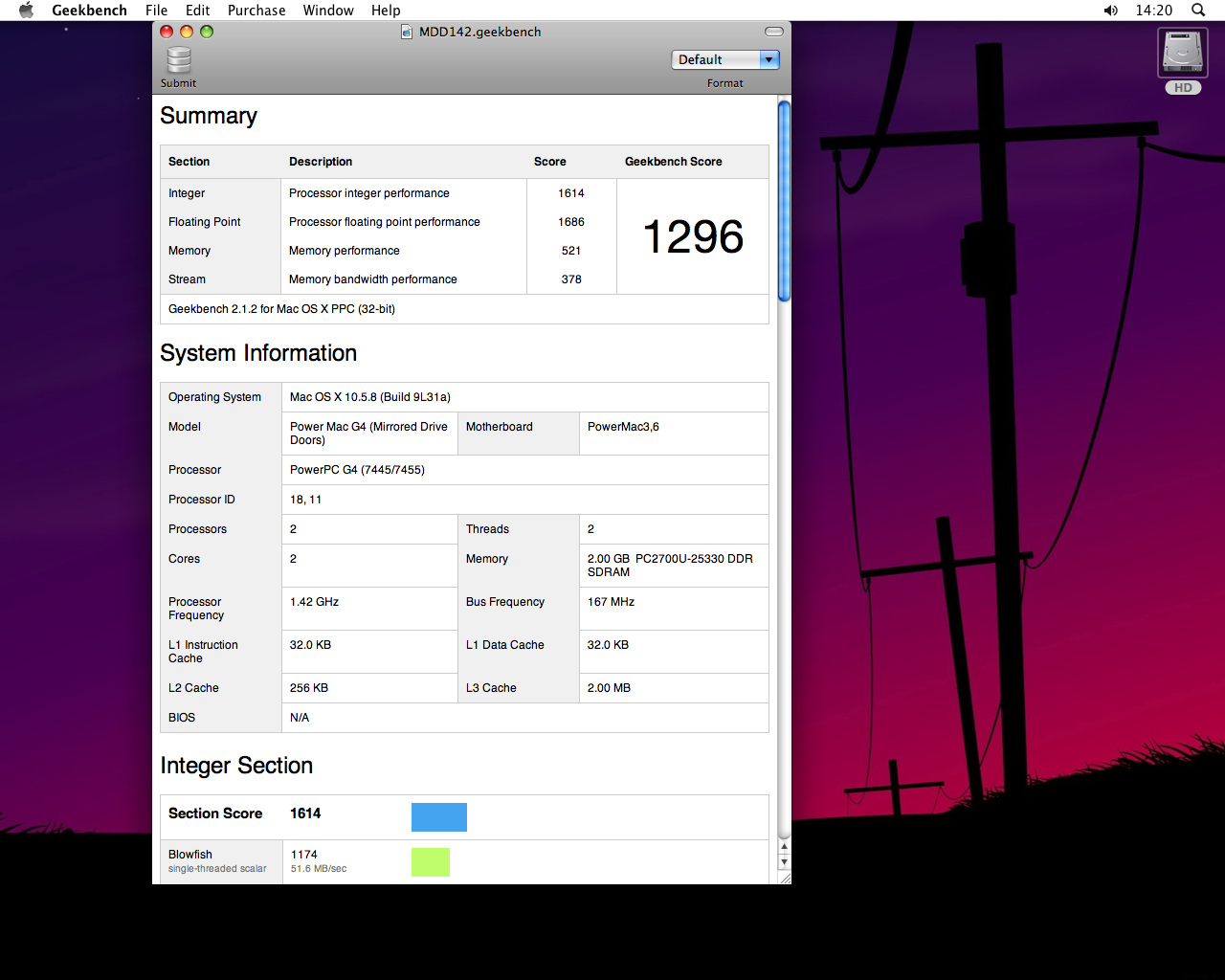

as I have said above, Geekbench aint being miss-leading here.
What I mean is, just using a slightly different Geekbench version can change as much as 200 points on the score.
Plus, if you look at tables on Everymac, there's no linear correlation between specs and Geekbench scores.

in my experience I have found GeekBench 2 to be quite the good/repeatable benchmark as long as you stay with in the same version
I use 2.2.0 for 10.4.11 PPC/intel and 2.2.7 for 10.5.8 PPC (which is the latest versions for reach respectively)
see for example my 1.67Ghz 17 and 15 inch DLSDs and my 1.67Ghz Mac mini all benchmarked with in 1 point of each other in Leopard GB 2.2.7 (its also a good demonstration of how the DDR2 on the DLSD is really just for show)
https://browser.geekbench.com/geekbench2/2636860
https://browser.geekbench.com/geekbench2/2630434
https://browser.geekbench.com/geekbench2/2601067
feel free to click on my username in those benchmarks and browse my other Benchmarks I have quite the library of Geekbench 2 3 and 4 results for many diffrent machines and setups 🙂
I use 2.1.2 - I'll run some comparisons with 2.2.7 later and note the differences.
iv noticed that 🙂
I do recommend sticking with the latest versions for any given OS release as they are the most mature and most likely to give accurate and repeatable results 🙂
but yes between 2 versions there can be some variance in the score on the same hardware/setup.
and this is why I recommend comparing/using the same version across the board (this holds true for any sort of benchmark or test)
Some quick tests between 2.1.2 and 2.2.7
Dual 1.42 MDD
2.1.2 1296
2.2.7 1232
Powerbook 12" 1.5
2.1.2 720
2.2.7 864
Powerbook 17" DLSD
2.1.2 873
2.2.7 972
This is what I mean about benchmarks, using 2.2.7 the MDD loses 64 marks, PB 12" gains 144 and PB 17" gains 99.

My findings have been that Geekbench scores much more generously on Leopard (v2.2.7) than Tiger (v2.2.0). This is on both G4 and G5 Macs. Sometimes there is a variance of ~10% or even 200+ points. I’m not sure if this is an indication of underlying improvements in Leopard for or just a shift of the base score.
You’ve got to also remember that any background tasks will have an impact on the results as they will interrupt the benchmark processes. It’s best to switch off any Sharing services and kill background apps and extra menu items, disable the screensaver (and screen dimming) then run the test without touching the mouse or keyboard. It wouldn’t be a bad idea to also disable Spotlight and Dashboard, but I haven’t done that.
I would typically run the testing with the Highest performance Energy Saver options. This should prevent any throttling or stepping of the CPU, bus and RAM speeds.
