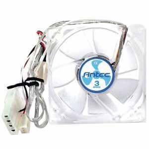

Heads up - I don't know if Netstor has upgraded those chassis, but up to a couple of years back, the cooling solution was absolutely inadequate for 4 hard working GPUs.
Maybe not even for 1.
I have my 980ti in a Netstor with an additional fan something like this one.
So in that small box I have
1. The Netstor fan
2. 980ti fan
3. A fan something like this on the side where the Netstor PCIE is slotted. Blows directly onto the 980ti
