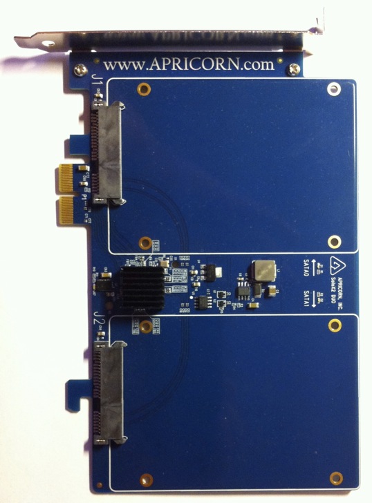

Just received a Velocity DUO X2 - beta. Very excited!!!
Preparing for testing on my Mac Pro 3.1 this week!
Keep you posted...

Wondering how long the card is, particularly how close it gets to the fan on a reference gtx 680. Should be ok as the orientation is changed on the drives though, and hey Apricorn if you need another beta tester you can send me a pm, I did offer my services to you six months ago 😀

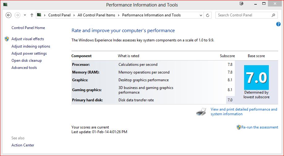

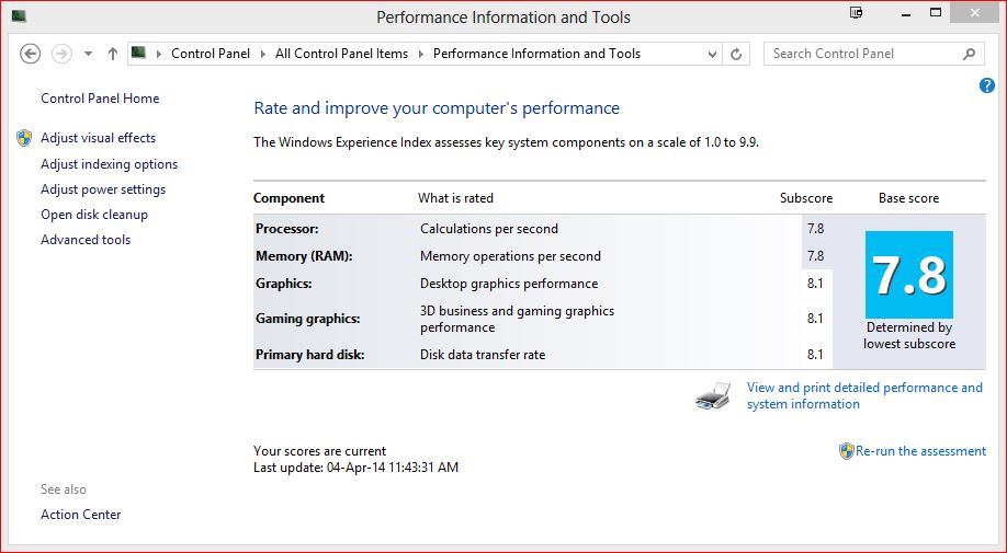

Windows 8 is now NATIVELY running in AHCI mode! Ran a WEI and added a 1.1 to the disk perfromance index, from 7.0 -> 8.1 Now the CPU and RAM are the limiting factors. 😕

180mm x 120mm
