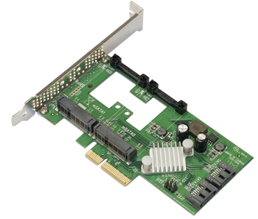

This is a bit more exciting. Many more products available like this. 4x interface. 2x msata, 2x sata. Only $55 from addonics. Description sounds like a Marvell chipset.

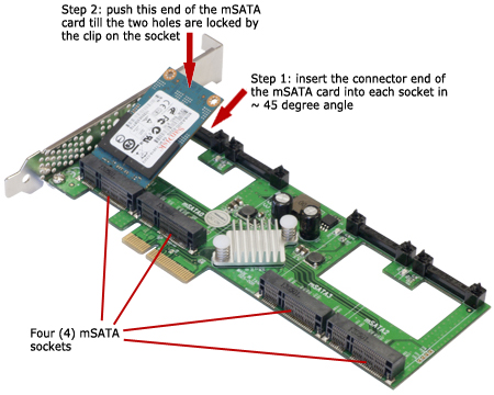

Missed this one with 4x msata.
Even better!
Even better!

The cards appear to be based on Marvell chipsets based on their description. The same vendor supplying current Apricorn cards, although running on the 4x interface makes them more exciting!

I have bought the Dual Hybrid HDD model:
http://www.addonics.com/products/ad4sahmsa.php
I am using a 2009 Mac Pro with firmware 5.1. I have 2 bootable drives - OSX Mavericks and Windows 7 in my Bootcamp drive. After installing on slots 2 and 3, I find that you can install and boot OSX. But the drive appears as an orange icon on desktop instead of the internal drive icon.
It doesn't support bootcamp - meaning if you clone a Bootcamp partition/drive onto an Msata and install it on the PCI-E card, it won't work. However, if you have a Bootcamp drive in the Mac Pro (using the internal SATA II), on boot up the card will detect the drive in the BIOS and you can then enter into Windows as per normal.
Now I am thinking of getting the Quad because the marketing copy says it can be "used as an OS drive". I really would like to get Windows 8 to boot off PCI-E instead of the internal SATA II.
