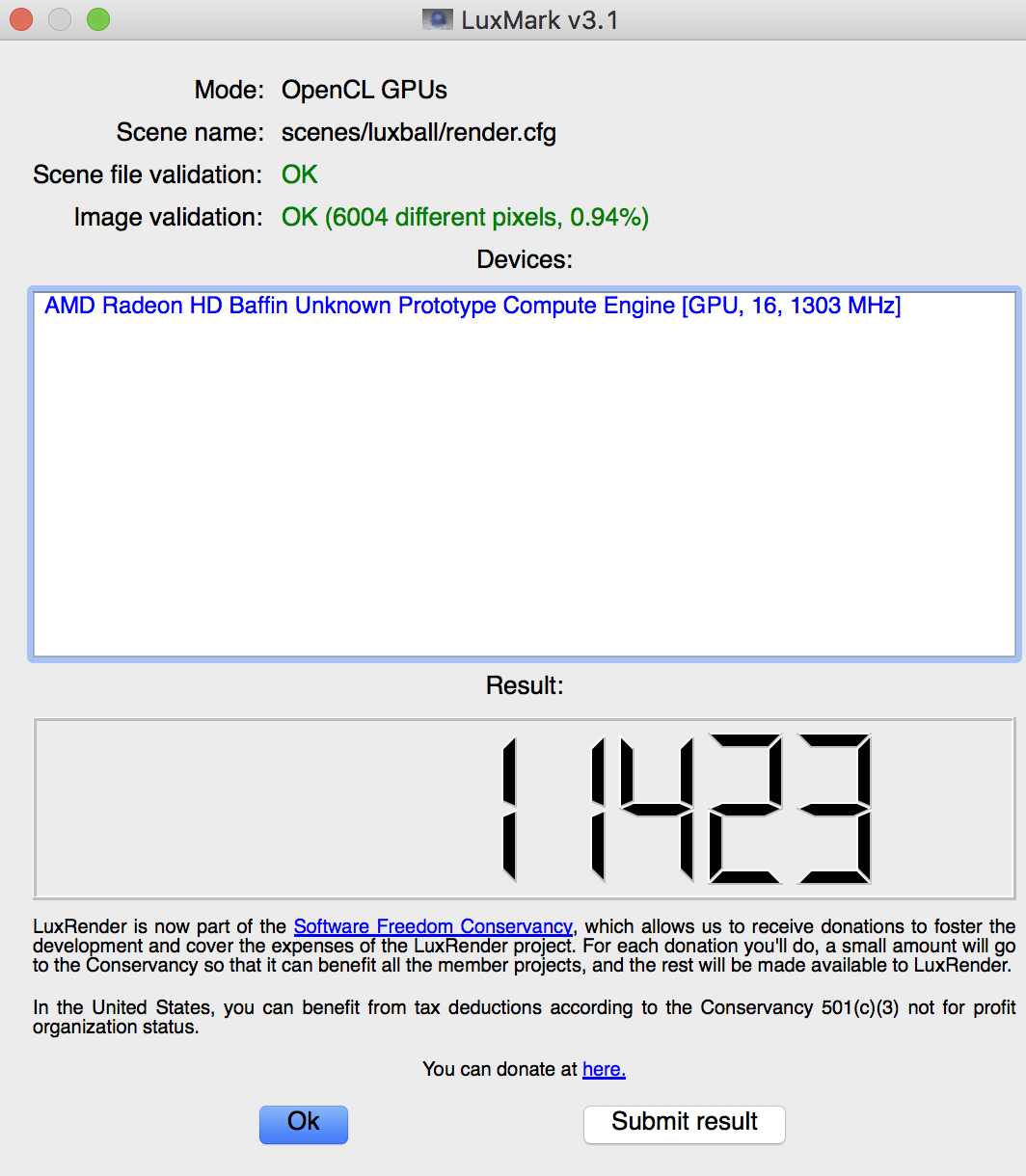

UPDATE:
with macOS Sierra Beta 6 I see a significant improvement in the RX480 performance.
To be sure, I run every test 3 times.
Heaven is exactly the same, but Luxmark scored 600 extra points (all the benchmarks had more or less the same improvement)
Btw, I know this might be old news for those on the developer beta - only posted to have a reference to the public beta as well
