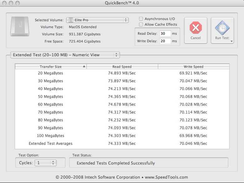

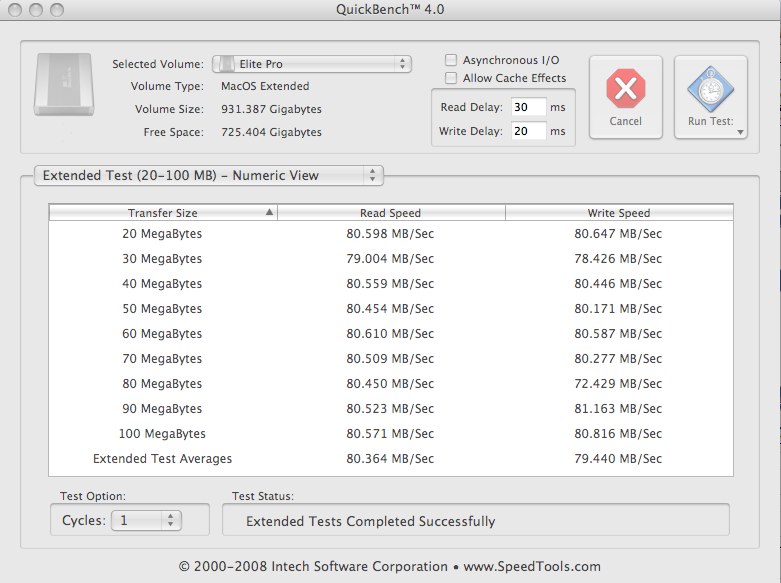

I just got a BC368 but on ebay says BC338, what's the difference between the two? I just did a quickbench on BC368 and it's somewhat slower/on par with FW800 when I should be hitting 100mb/sec
I thought there would be more of a difference between the two🙄
BC368 eSATA (left) - FW800 (right)
