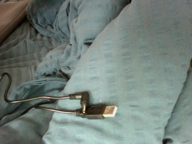

there are USB to DC kind of cables. i got it too with my drive. so you dont need to power it from an outlet.. or if one USB slot doesnt have sufficient power

I wonder, IS there a usb cable that JUST does power?
cable
the cable looks like a straight USB to mini usb cable, it has a B on the other side of the mini adaptor - that I haven't seen before.

i meant this kind of cable for USB power... 🙂
