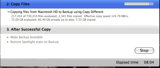

I put together an eSATA external usng a Kingwin Z1 enclosure, a 7200 RPM500GB Seagate SATA Hard Drive. It's connected to my MBP via a Vantec Express Card and everything works great in Leopard and on my Vista Bootcamp Partition registering full speeds near the expected 3Gb/s transfer rate. This is a comparison of about 3000Mb/s for eSATA against 800Mb/s for Firewire800, 480Mb/sec for USB2.0, and 400Mb/sec for Firewire400.
I partitioned the eSATA drive into two halves - one that I use as a TimeMachine backup in Leopard and the other that I use for gaming installations in Vista.
As a note... the Vantec card uses the Silicon Image chipset and registers as a generic eSATA ExpressCard device. This has caused no problems in functionality. But, the drive itself was a little cumbersome to set-up. Neither Leopard nor Vista would recognize the unformatted drive by eSATA, instead I had to connect via USB to establish initial formatting and partitions. But, once it was set-up the eSATA interface works great... and FAST.

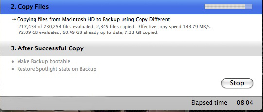

Just for reference, backing up with SuperDuper! also take note that this is a "copy different" backup, so it has to evaluate and compare files on the external and the Macbook's before copying. But 7 GB in 8 minutes is pretty good imo.
which would slow it down. Just copied a 6.66 GB file to the external in just over 3 minutes.
