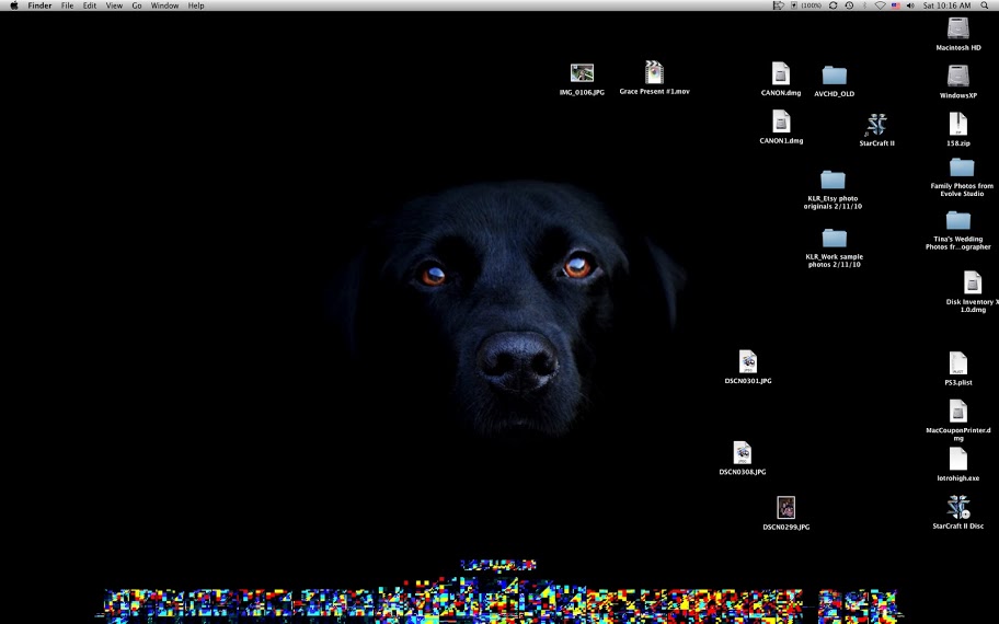

I've got an early 2008 iMac 24" C2D 2.8 GHz with the NVIDIA GeForce 8800 GS video card installed that has started acting up. Initially it was just the occasional hang or beach ball that never went away and now we are starting to see some odd graphic issues. See enclosed image below. The system locked up hard shortly after taking this screenshot. There was nothing particular running at the time (no games).
I can't consistently recreate the issue in the screenshot below, but if I load a game such as StarCraft II the system locks up hard.
I seem to remember that some of the NVIDIA chips had issues, but is anyone aware of issues with the GeForce 8800 GS video card used in the early 2008 iMac8,1?
Are there any graphics tests or benchmarks I can run to confirm there is an issue with my GeForce 8800 GS video card?
Have you tried reseting SMC and PRAM? Apple hardware check from the install disc? 8600M GT has had the most issues and Apple is even covering them but 8800 GS hasn't got any special treatment. I've seen few failures similar to yours before though
I sure hope not. I got one of those imacs with that graphics card last year, but it's 3.06 ghz. Ive done intense gaming and editing on it, and its always been smooth but the thing is, is that people who have had these iMacs have said that the graphics card has almost always failed which worries me. The question I have for you though is, why does it say 100% charged at the top lol?
Thanks for the tips Hellhammer. I've reset the SMC and PRAM and run the extended HW diagnostic test from my OS X install discs. No issues found. Starcraft II still locks up the system when it hits the loading screen. It has run successfully in the past.
I do have bootcamp and WinXP installed so next I might try running Starcraft II from there and see if I encounter the same issues. If I don't encounter the same issue under WinXP perhaps it is just an OS X issue and I can try reinstalling the OS.

Installed StarCraft II under WinXP and experienced similar issues with graphical anomalies under WinXP, so I took the iMac into the Apple store today.
The Apple technician ran some tests and found some things that made him believe there was a graphics card issue so Apple is replacing my graphics card under AppleCare. Should have the iMac back in a week.
Hopefully with the new graphics card everything will be back to normal.
