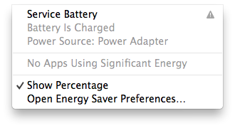

Same here
Does anything else annoying happen with this? Like popups saying replace battery, etc? Or it just says that there and that's it?
There are no pop-ups. It's simply that the battery status shows "Service Battery" if your battery health is below 80%. That doesn't mean that the battery is unusable, as long as it still holds sufficient charge to meet your needs.
