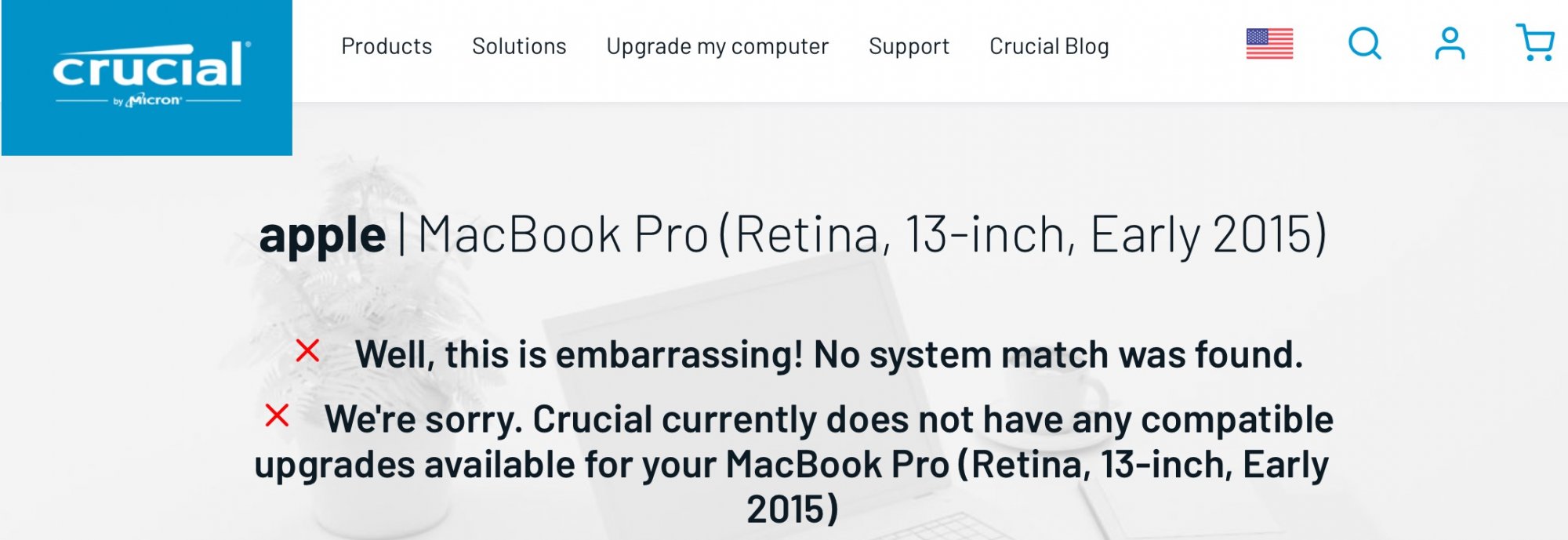

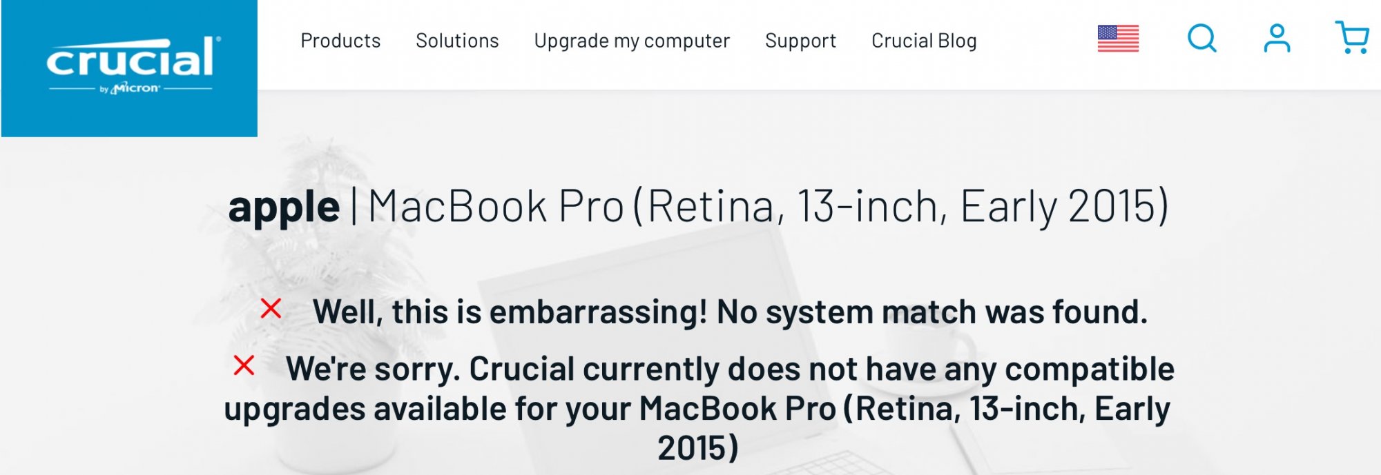

Just found this on the Crucial site for compatibility. Must mean it won't fit to proprietary connection (without the adapter)?
Just found this on the Crucial site for compatibility. Must mean it won't fit to proprietary connection (without the adapter)?View attachment 1923276
Correct. Sith the sintech adaper you should be fine I guess. For firmware upgrades you could temorarily swap in the original Apple SSD. Hopefully Apple does not care enough to sabotage the usage of mentioned adapers and/or third party SSDs
