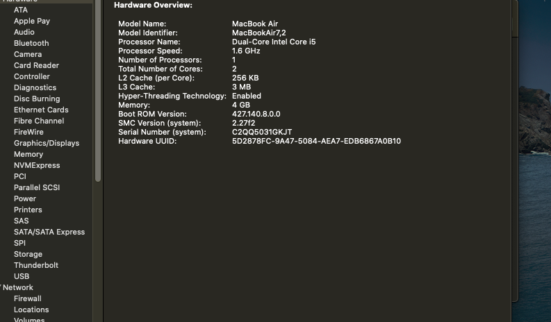

I have posted before on "my problem MBA", and have sorta limped since then but now have a better handle on what may be plaguing it.
This is an unmodifed base model 4GB early-2015 MBA A1466. I'm attaching system info. The 'symptom set' is that either under Catalina, or under Boot Camp, Windows 10 Home x64, the behavior is about the same. On a fresh COLD start [being certain that power was actually cut, all devices dead], performance is about what one would expect, for a short period of time. Pretty snappy with Windows 10, WITH mods.... i'll explain... and about what others experience with Catalina, with all.. ALL accessible background apps OFF...ruthlessly. Because of its issue I only use this MBA for troubleshooting other Macs, referencing, etc, not for everyday work. No important files stashed on it, and as said, everything that I know how to access turned off.
I have a few hardware and software checks stored - none of them turned up "errors" that the particular test app is made for.
At minimum I would like to overwrite the current firmware if such is allowed. First problem is, this model isn't even listed [unbelievably] at https://support.apple.com/downloads/macnotebooks
Only one vintage 2015 model even showing. Where do I find the appropriate BOOT ROM and SMC files?
Any/all advice you can provide is greatly appreciated. This is solvable.
Firmware is updated automatically when system updates are installed; you cannot manually install any firmware updates on Macs otherwise. It's also unlikely that firmware is the root of whatever problem you're having. Performance just isn't going to be good on this Mac due to the lack of RAM.
It does appear that your firmware isn't up to date so there is likely an outstanding security update to be installed.

Apple does in fact post some EFI, SMC, and a few disk-firmware updates, but no UEFI - I think that's what you may have had in mind. https://support.apple.com/downloads/macnotebooks
As I had said - I've done all the usual 'problem checks' and everything shows 'healthy', but those checks aren't extensive as you may know. Re RAM - The work I do on this MBA never even uses the 4GB RAM that's present - I've monitored it at length. If I were running multiple apps and complex graphics simultaneously, yes it would hit the limit, but the symptoms I describe are manifesting while the system is 'loafing'. Disk performance, measured with benchmarking tools, is pretty good for the default - its higher on many tests than my daily driver, which is about 10x the speed of the MBA while manifesting its 'issue'. As said, on a cold boot, the MBA has pretty decent performance under Catalina, but after a sleep/wake cycle or three, it is cut to about 25% of that 'speed' - with everything lagging, even one keystroke. Power-off [completely], restart, it performs acceptably until after being left dormant for awhile. All of this is exaggerated running bc/windows - It is faster vs. Catalina when 'freshened', but after a sleep cycle, it becomes so degraded, and throws significant errors.
Any clues? Maybe I should turn off all power management functions available?

OSX yes. I've been through all of them except Monterey. I always nuke the drive, use an installer disk on each - no baggage carryover. But, to your point perhaps I should go ahead and install Monterey if there are necessary firmware updates embedded. How could I look that up? Not sure Apple always makes EVERYthing in the update known to the general public. Like Microsoft, most updates are "security", even when they're not. Less resistance 🙂 Occasionally known bugs are addressed in the notes
Try with Monterrey, hopefully it'll clear it up. If not, perhaps a diagnosis visit to the Apple store might be in order.

Those standalone updates are long since superseded by the updates built in to system software installers. I am confident that having more RAM would make the computer work better, but of course it's not upgradable. 4GB Macs just don't have enough RAM.

IN fact...I need to post this in several places but miraculously, the current edition of 12.4 Monterey FIXED the issue. I had no hope whatsoever that I would get that flat lucky but it appears so. I wiped the drive totally and used Recovery to install over internet Saturday night. No hitches in install. So far, the creeping lagginess appears gone. Sleeps well, wakes well, no diff in performance after sleep cycle [before, the wakeup performance was unusable so always had to power off and MAKE SURE it was really powered off]. So what is now called System Firmware [the right way to categorize] is 430.120.6.0.0 - a big leap from 427.....
