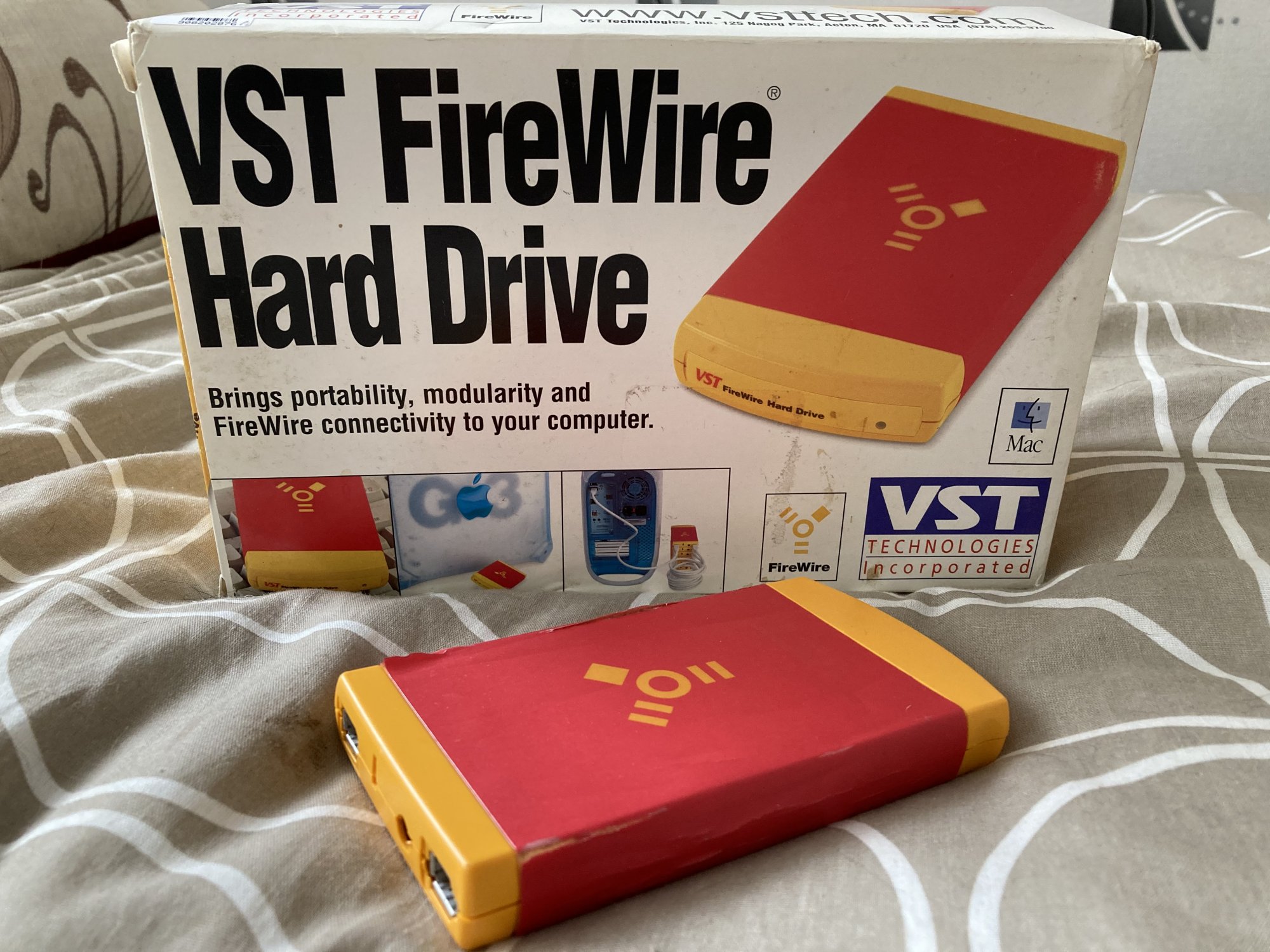

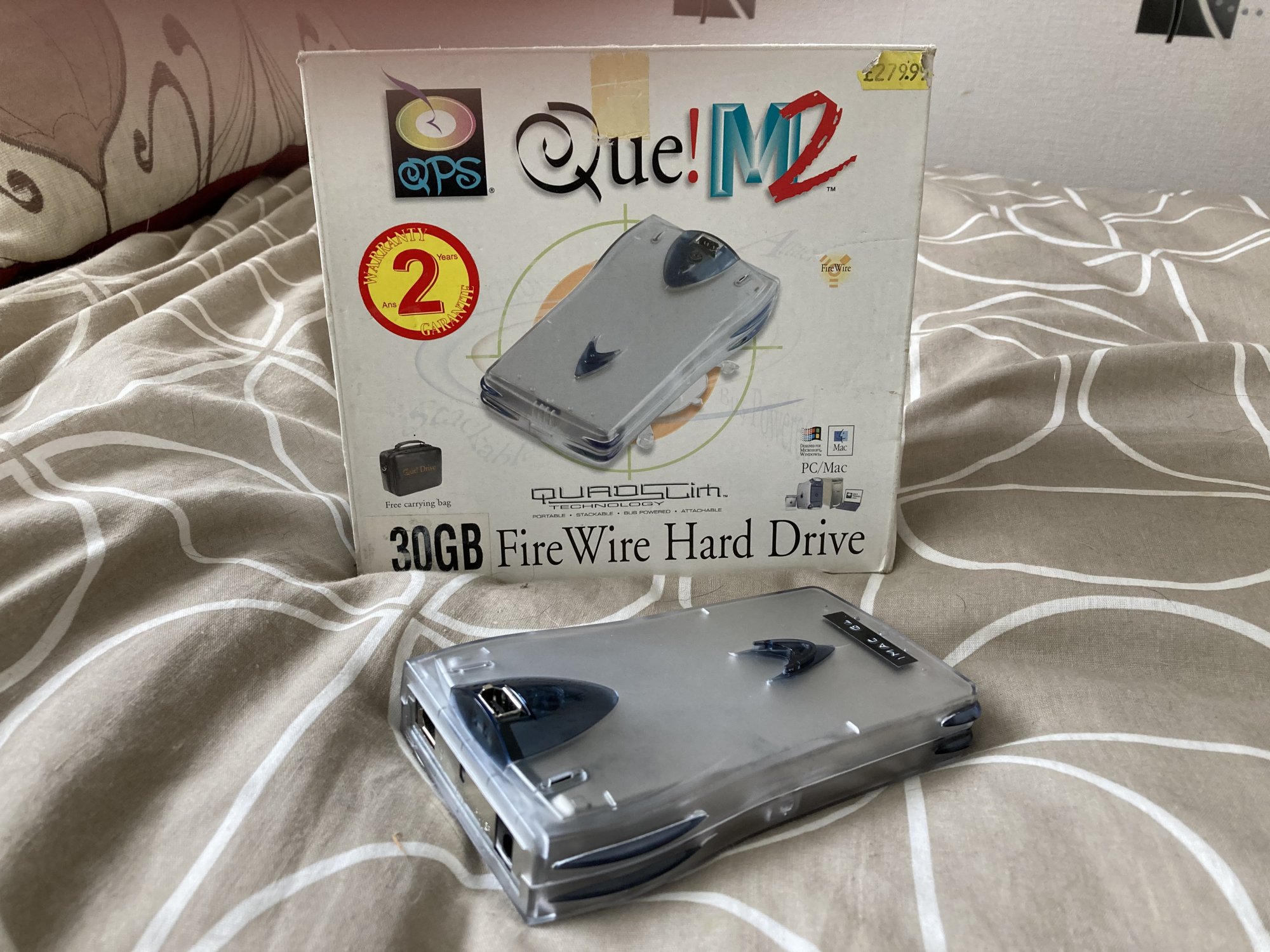

Last week I managed to buy not one but two hard to find portable 2.5" firewire enclosures.
They were marked up as spares/repairs because the seller couldn't test them, but I got one for £5 and the other for £10.
Both came boxed and with all the associated bits included.
The yellow and red drive had a 6GB HDD in it and was a pain to open up, but I managed to get a 128GB mSATA SSD to work, and now it's my backup drive for the Pismo.
The other case was also difficult to get inside but I finally managed to put an 80GB spinner in, which is now a backup for my iMac G4.
