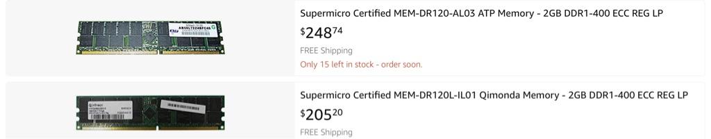

I found this stuff on Amazon.... unsure if it’d work or not in an AGP G5:
Those prices though...... I hate those types of people or those type of listings if they clearly have it in stock.

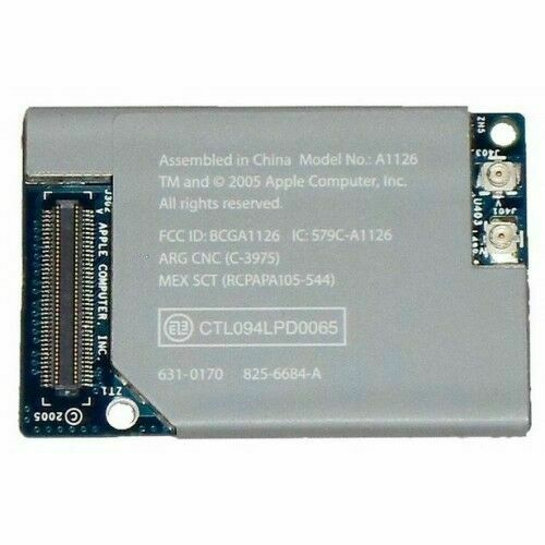

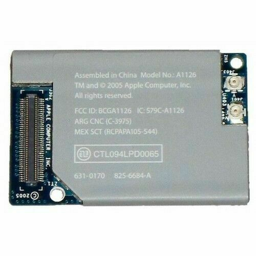

A little off topic now that I know you have a DLSD PB, have you upgraded the WiFi card on it ? I wonder if the airport card slot can be used with a more modern mpcie or m2 WiFi card with an adapter, also, can you use faster ram than 4200?
By the sound of it, you have never dealt with a DLSD PowerBook before.
The first thing you need to know about the final run of PowerPC Macs is they used an integrated wifi/bluetooth module for the first time. Note I said “module” and not “card”. It isn’t PCIe. It also has its own cable connecting receptacle variations, depending on whether it’s designed for the iBook, the PowerBook, the iMac, or the Power Mac multicore models. It looks generally like this, with the left area varying:
The only way you can bump a PowerPC Mac to something beyond 802.11g is to find an 802.11n Cardbus/PCMCIA card and use the slot on a PowerBook 15" or 17", or by adding a PCI/PCIe 802.11n wifi card to a Power Mac G5. I’ve done both.

I see...
And you are right, I haven't dealt with a DLSD yet, I will pick one (hopefully) tomorrow, but since I intend to max it out right from the start, I thought it would be a good idea to come here and ask about options...
Since you have experience with this kind of thing, If I remove the internal Wi-Fi module but plug a cardbus wifi card, I will still have wifi, right? not using the internal card shouldn't improve things drastically since I don't think it consumes much power or generates heat, but every little improvement is appreciated...
