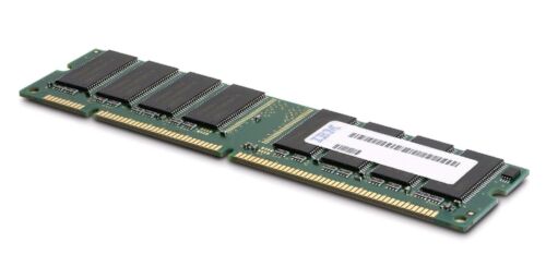

Perphaps this is the correct thread to post and ask this, but as a quad owner, I investigated to see which memory is compatible with the memory controller (no idea if it's the same on earlier G5 models...) and I believe I may have reached a conclusion, in one hand, the IBM memory controller PDF says that ECC registered memory is supported, but what isn't supported (according to users here) is buffered memory, in theory, you could use Registered ECC as long as it isn't buffered, but don't take my word for granted..
That link has a 8gb ECC ddr2 pc2-4200 registered stick, it's expensive yes, but what we don't know ifsaid memory is also buffered or not, if it isn't buffered and someone here have access to it, it could be interesting to see if a G5 supports it, if it does, the premise of a 64gb ECC G5 may be doable, if it isn't, there is another option I found:
There are other options in that publication, but note that they don't specify if it's buffered or not, yes, its ecc registered, but the IBM PDF says registered its supported... Maybe it works or maybe it doesn't...
I guess PC4200R is registered buffered memory and it definitely does not work. I have just tried it myself with 2x4GB unbuffered PC4200R sticks and it's a no go. I might have a go with PC4200P, but I guess what we need is low-density PC4200E or PC4200U or above but 4Gb sticks of this type of very onerous.
