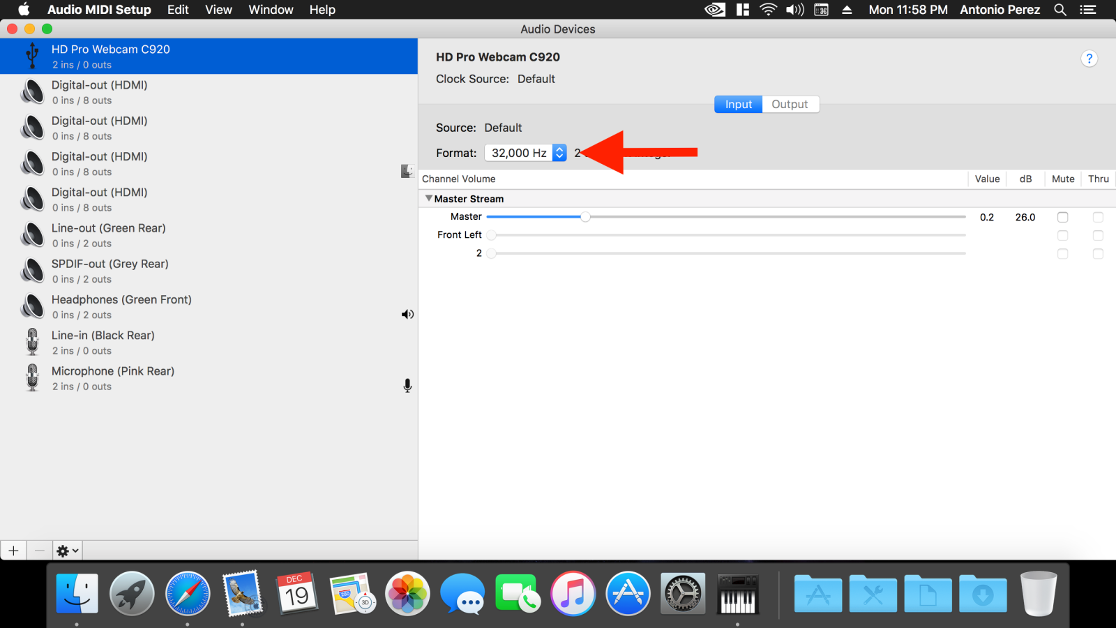

i know this is an old threat but i know what causes this issue and how to fix it, i can't let c920 look bad, so here it is go to utilities - audio mdi setup
look for c920 and change the format to the highest option available
now try it and it will sound good, like it normally does
i wrote this tutorial like 2 years ago in some other forum and all the users got the camera working good

it is the same thing, except that i did it on a hackintosh instead of a real mac but is the same process, right now i'm running sierra 10.12.2 and the method still works
[doublepost=1482206902][/doublepost]sorry for the typo
is not audio mdi setup
is Audio MIDI Setup
just like boast mentioned
simply change 16,000 for 32,000 and problem solved
here are some pictures
after you do this then try face time again

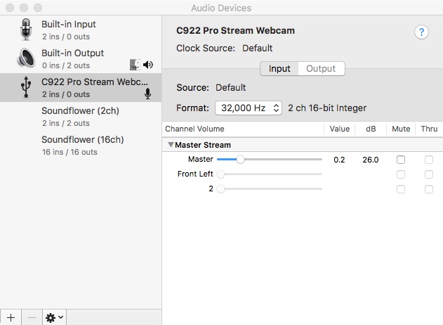

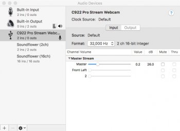

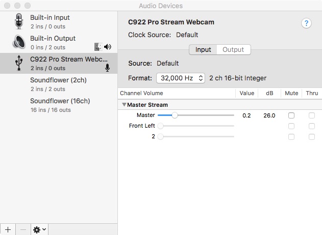

Thanks a lot. But this fix did not work for me. When I went to the Audio MIDI Setup (see attached) the format for the C922 was already set to 32,000 Hz the highest setting. Still getting the echo. Are you sure the c920 has echo cancelling capability? My MAC mini is connected to external speakers through the headphone jack out.
