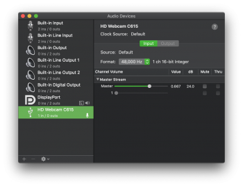

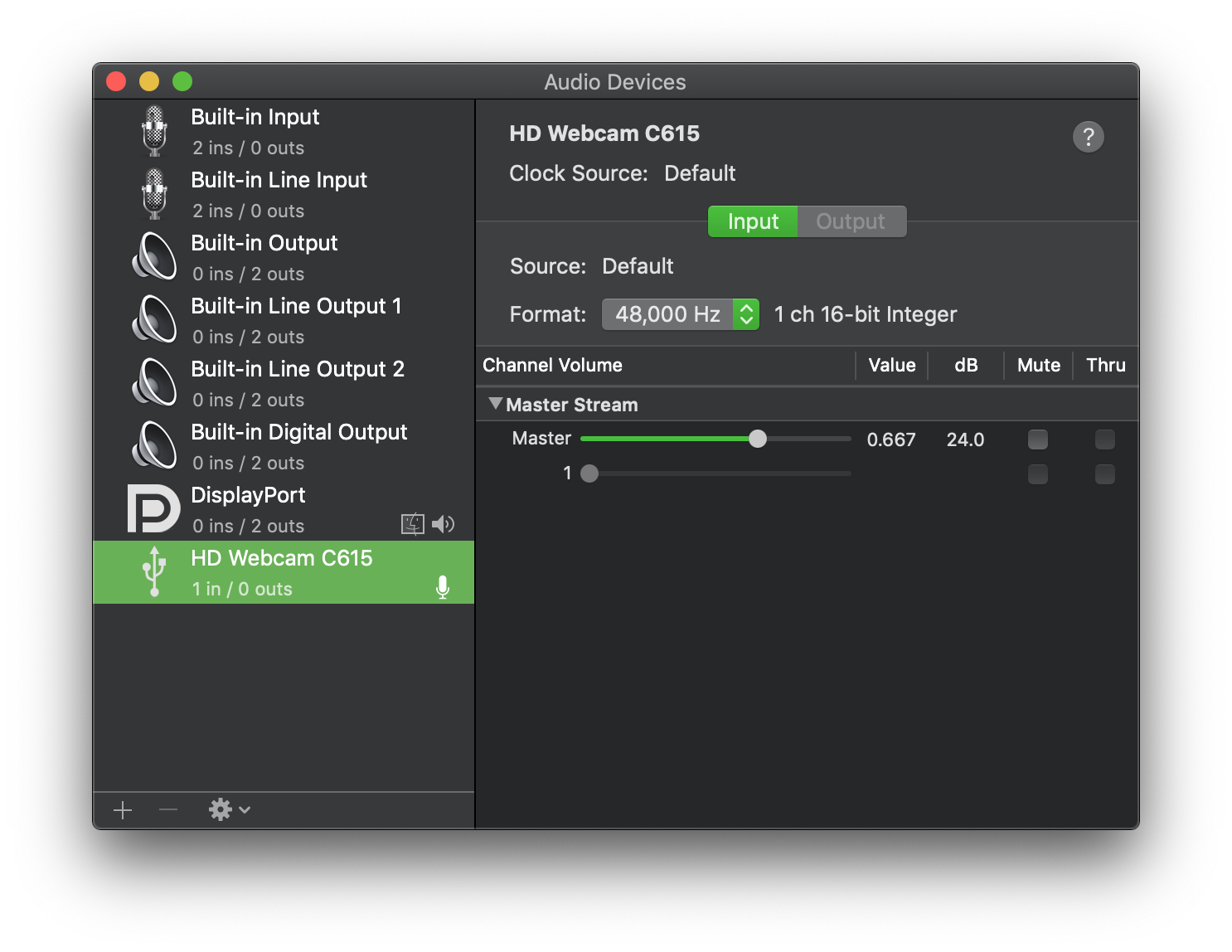

Another thing I noticed, if I go to the Audio Devices app, the C615 has an option that goes up to 48,000 Hz whereas the C922 only went up to 32,000 Hz. The C615 was defaulted to 48,000 Hz while the C922 defaulted to 16,000 Hz.
Maybe macOS needs 48,000 Hz to do noise cancelling? Either that or this camera just has better noise cancelling built in.
