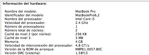

Can you post your Model ID and HD Spec. We're trying to figure out which it does install and which it doesn't.
Does not install
System:
HD:
I don't know what is the Boot ROM version before the update...
Model Identifier: MacBookPro6,2
Processor Name: Intel Core i7
Processor Speed: 2.66 GHz
Memory: 4 GB
Boot ROM Version: MBP61.0057.B0C
HD
Model: Hitachi HTS545050B9SA02
Revision: PB4AC60W

It wasn't installing on my 15" MacBook Pro (Mid 2010). I was able to install it by extracting the package with Pacifist and running:
sudo /usr/sbin/bless -mount / -firmware "/System/Library/CoreServices/Firmware Updates/MacBookProEFIUpdate19/MBP61_0057_0CB_LOCKED.scap".
I haven't had any adverse results (and the new Boot ROM version is showing in System Profiler). If you install it this way (and you almost certainly shouldn't), make absolutely certain that the firmware is applicable first 🙂
