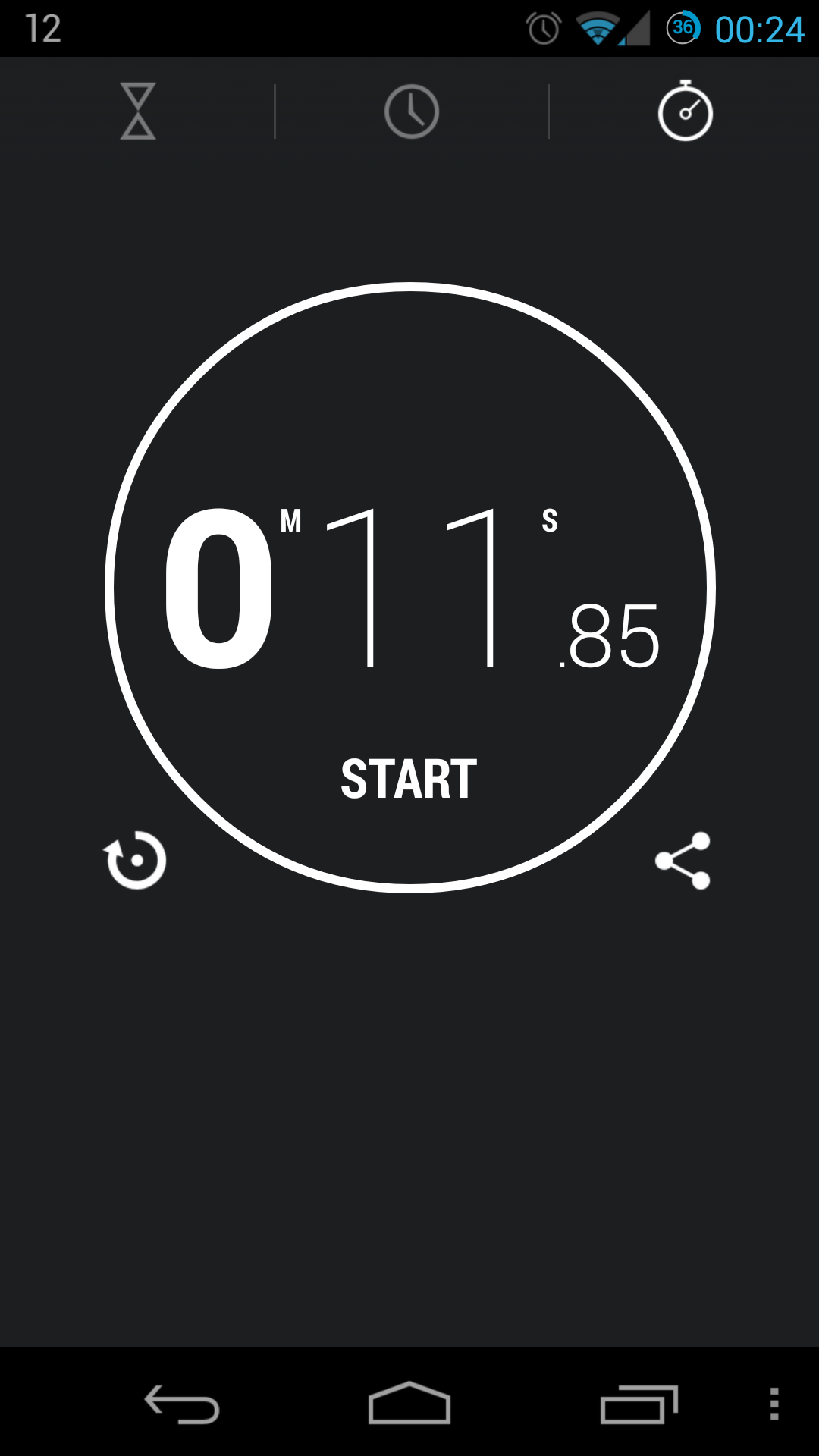

So ever since I upgraded from 10.8.5 to the 10.9 GM any external hard disk or flash drive take too long to eject. I'm sure it's not the drives because I've tested the same one on different laptpops on 10.9 and 10.8 but they eject within a second or two. I even timed it to show you I'm not being paranoid. I've tried USB 2.0, 3.0 and Thunderbolt drives.
Is anyone having this issue and does anyone know how to fix it? I would rather avoid having to do a clean install. I'm using a mid 2012 MBA.

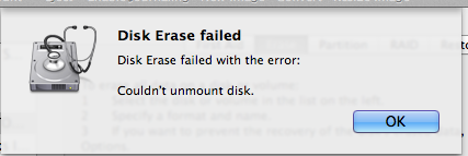

I also noticed that when I go to erase a USB drive in Disk Utility I get an error saying it can't unmount the drive.

What's the full error you get when you try and erase a USB drive? Something probably has files open on the disk which would prevent unmounting. The spotlight database is probably open on the USB disk and that could be what Disk Utility is tripping over in 10.9. If so this is a change form 10.8 behavior.

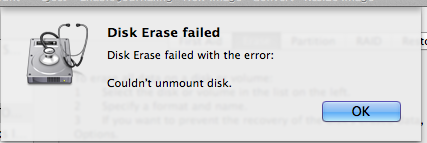

Here's the error
