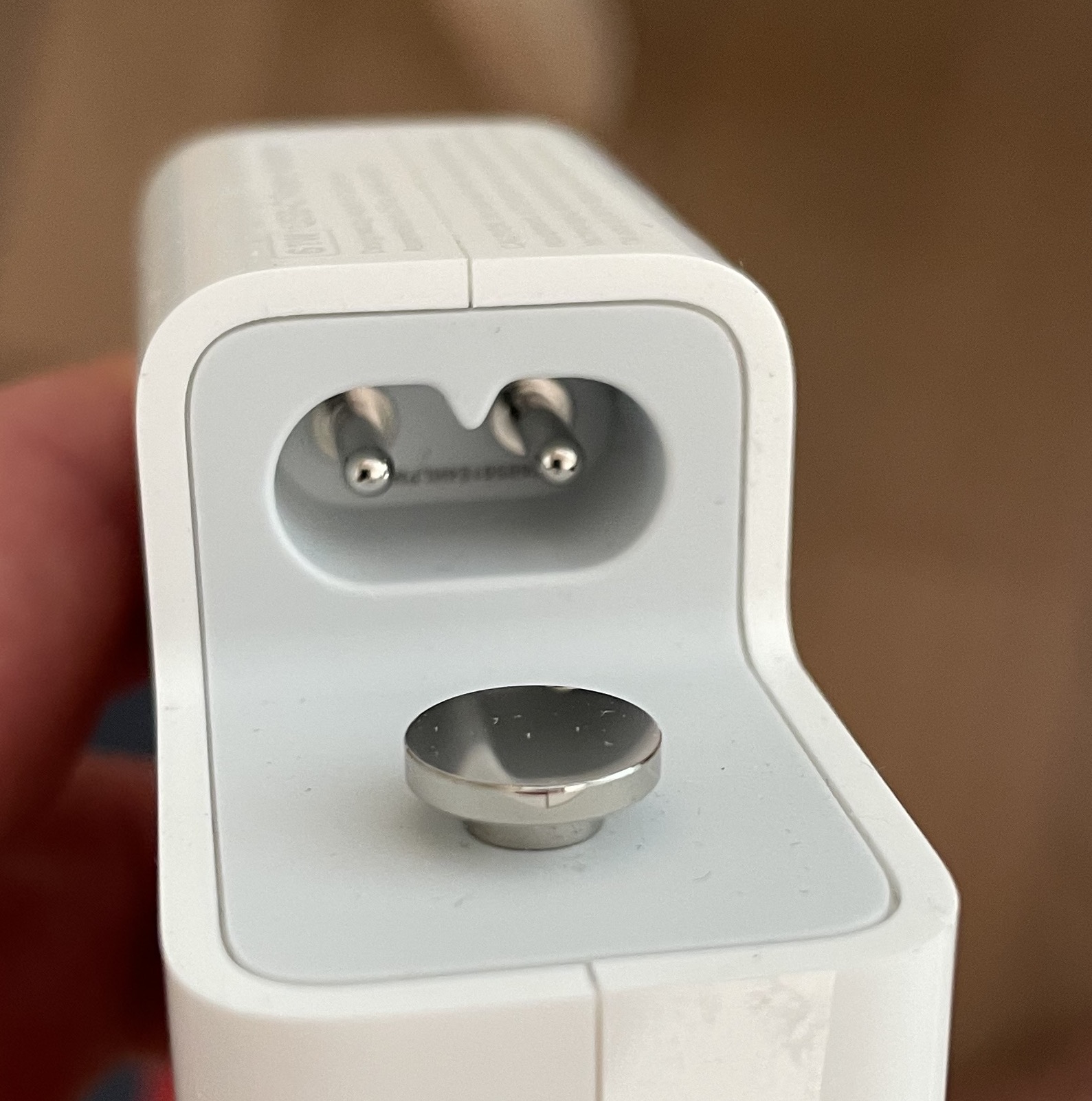

the Apple power adaptor only has 2 pins, so a 3 pin extension cord does nothing

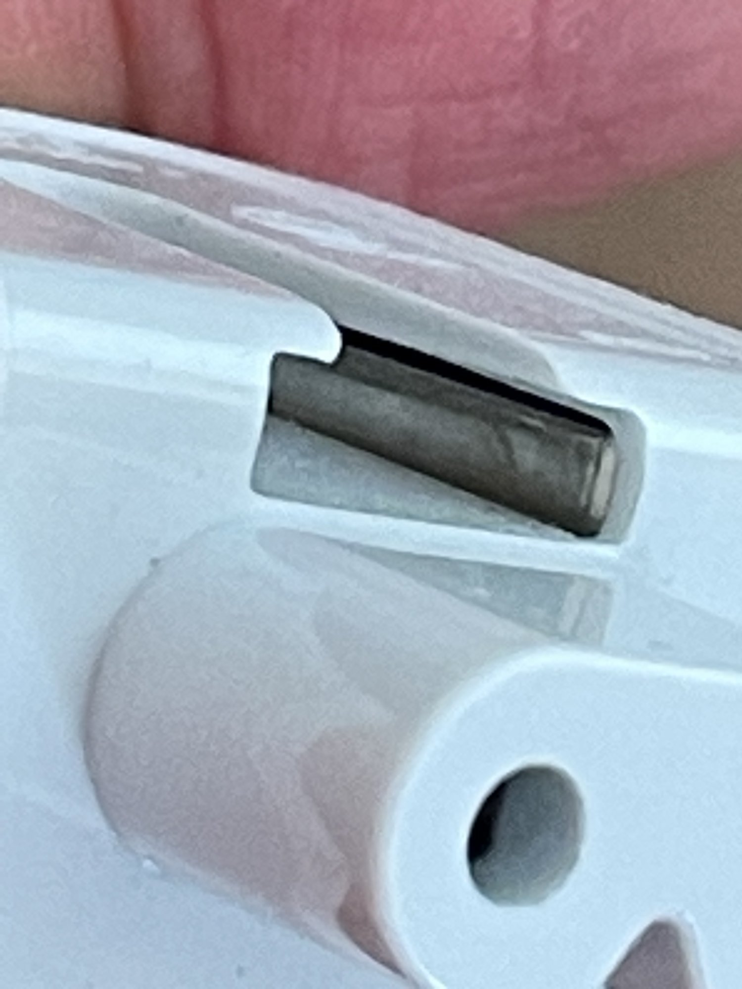

It terminates into an ungrounded TWO PIN socket that plugs into the ungrounded TWO PIN input in the mains adaptor lol
Please count again! or maybe you don't have a cable.
School day for me, all these years I admit I never knew the latching pin also acted as a ground pin...
...or does it? Have you ever checked continuity between the latching pin and the earth pin on the plug?
You'd be right that I no longer have one to check.
You live and learn. 👍
Just found my multimeter and did a check. There really is continuity, both through the extension cable and through the power-brick.
That I don't have many grounded wall-plugs at home, if any, is another matter. But years ago I worked in a lab, where ground mattered.
