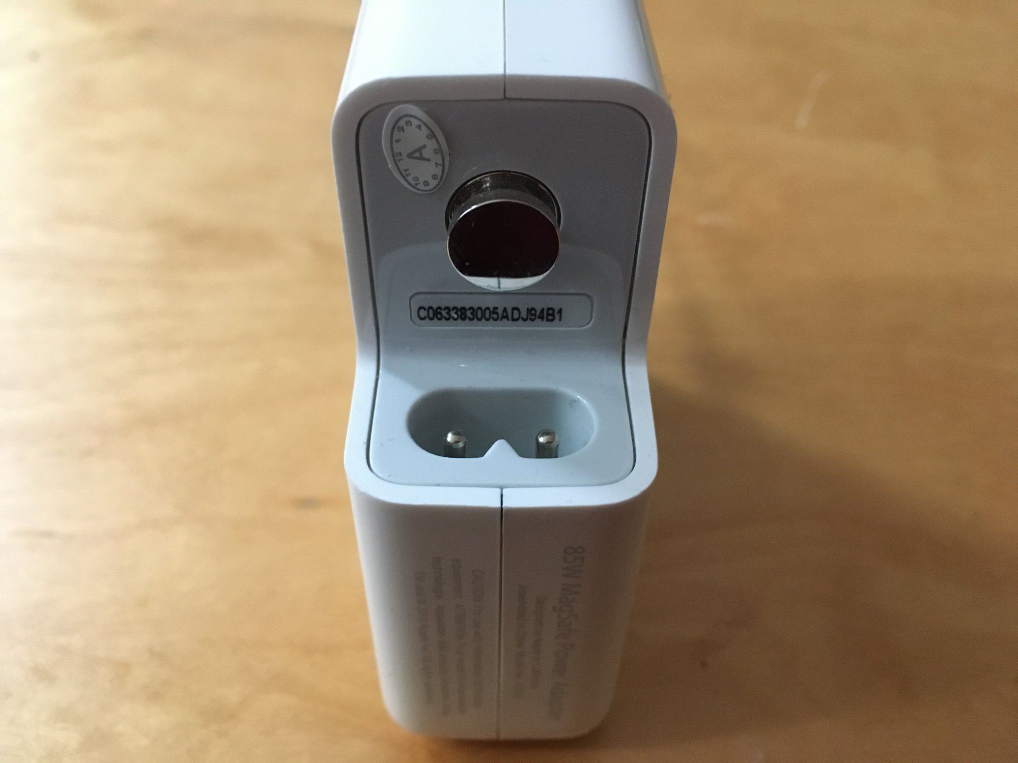

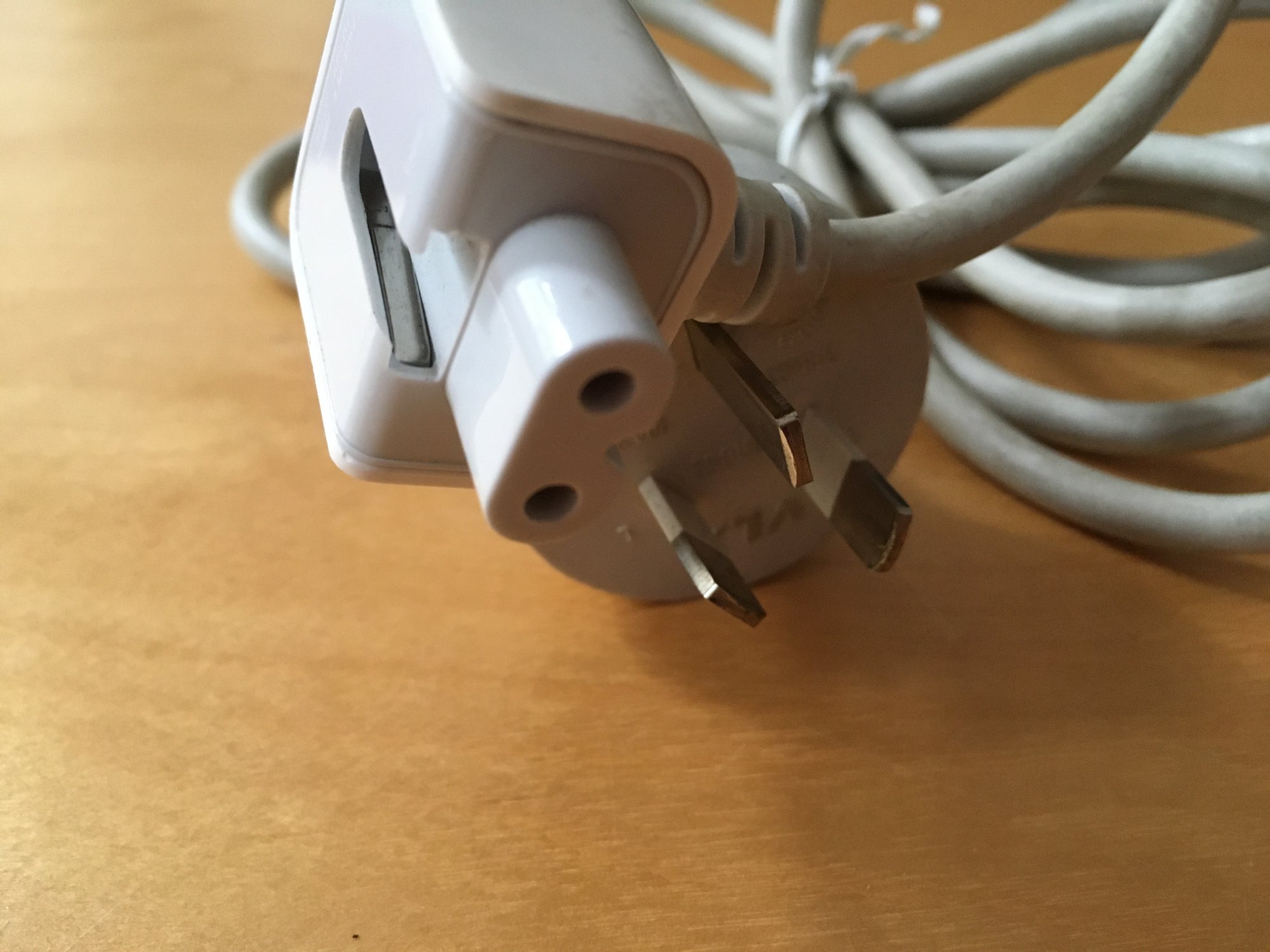

fwiw, I have 2x Apple plugs, 1x from Australia and 1x from USA. Neither of them have metal rails on the inside like the one above

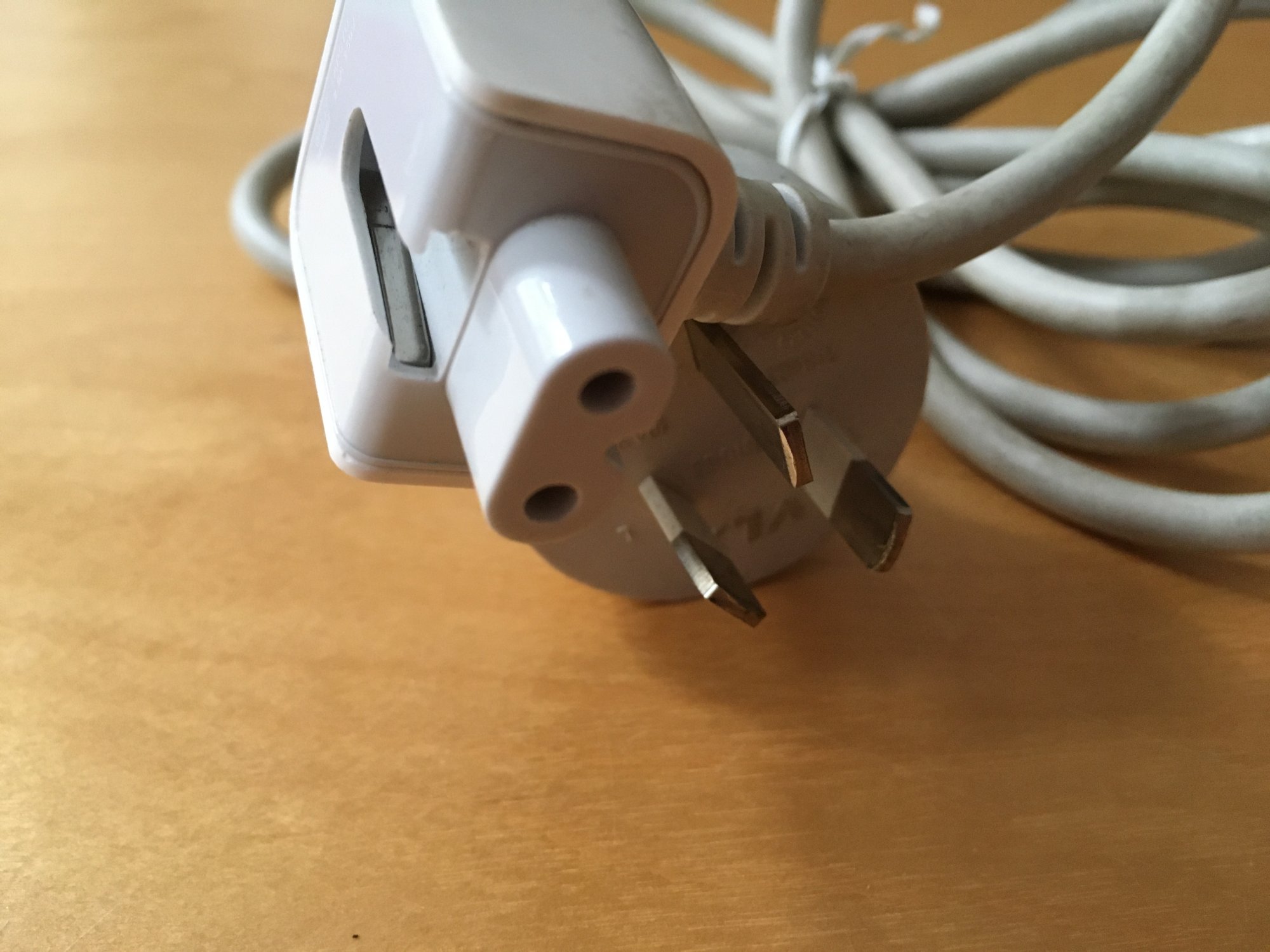

The Australia cord is grounded. I have one. See the metal rails in the slot.

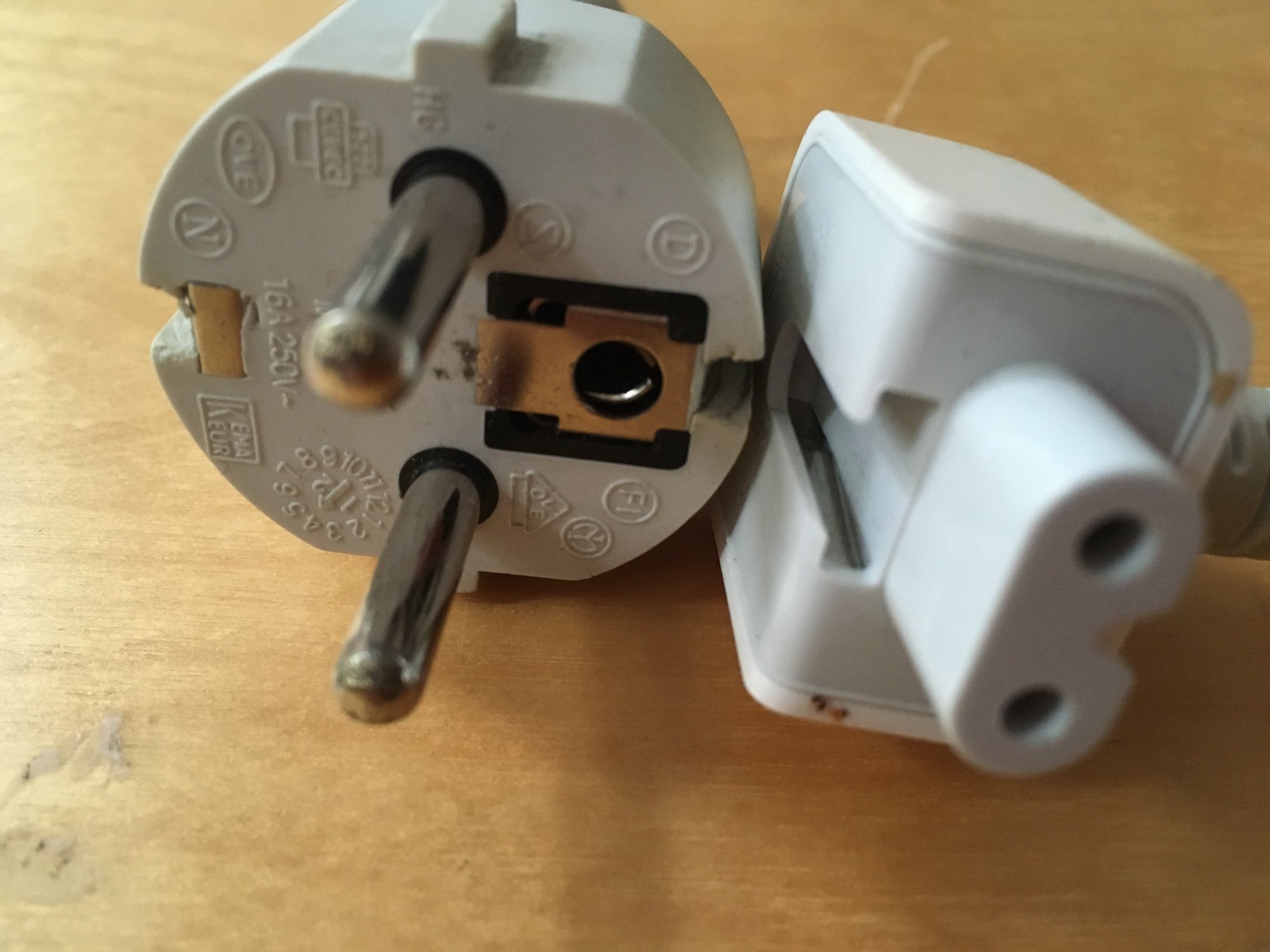

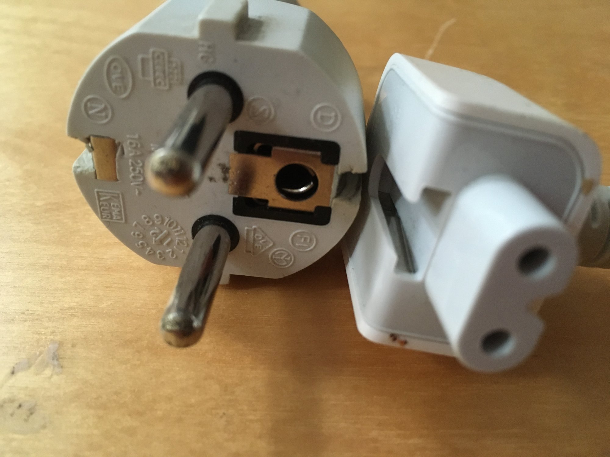

the Germany plug is cord grounded. I also have one. More metal rails in the slots
The transformer with a huge grounded round metal contact.

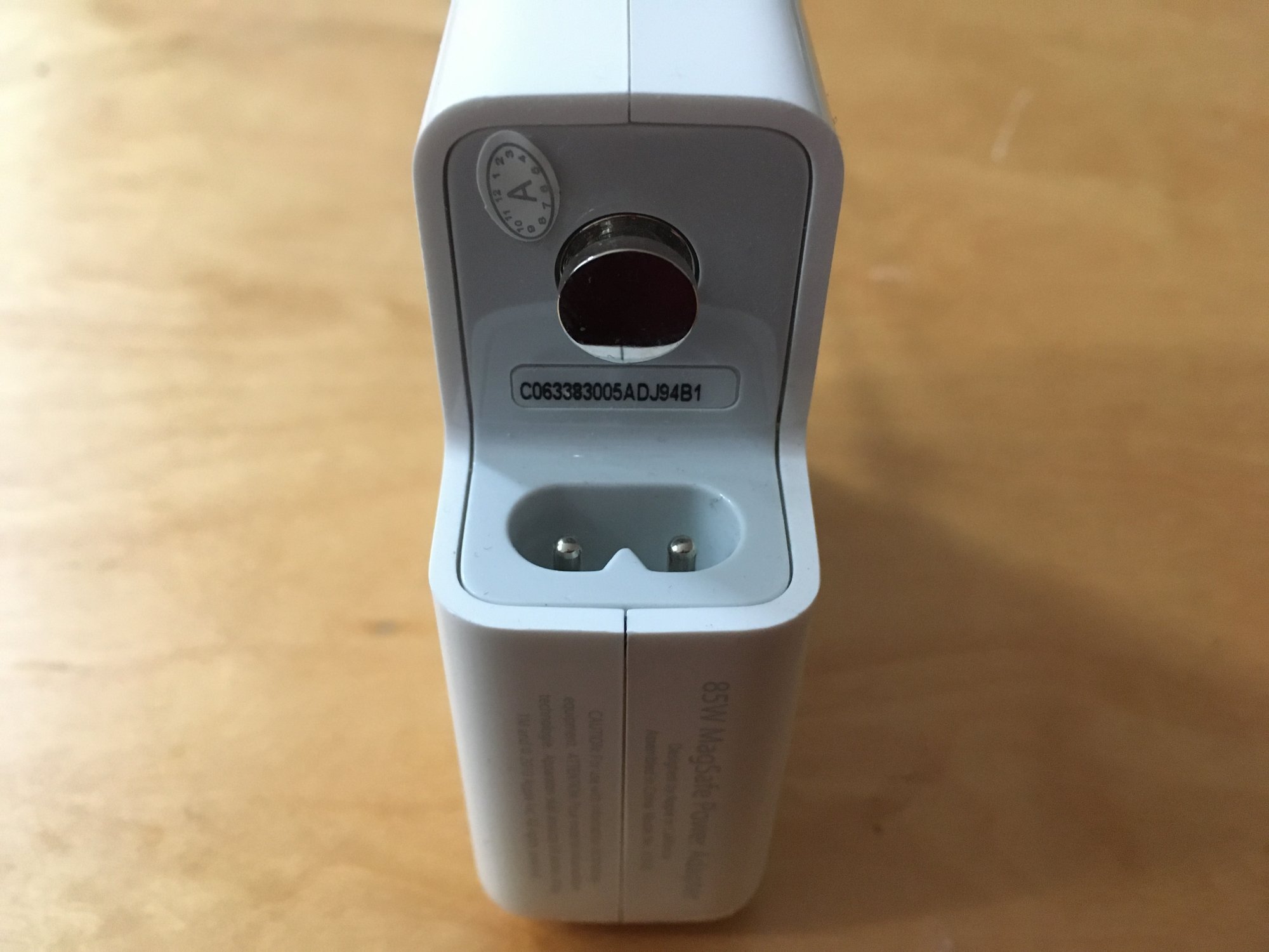

the Apple power adaptor only has 2 pins, so a 3 pin extension cord does nothing
Actually, if you take the short power connector out of the apple PSU you will notice that the notch contains contacts. If, for example, you use the extension power cable sold separately in the UK it actually connects these contacts to ground and the very noticeable buzzing that you feel disappears.
My recollection is that all MacBook Pro models I have used have given this tingly feeling unless I use this cable which sadly you have to purchase separately now.

Just found my multimeter and did a check. There really is continuity, both through the extension cable and through the power-brick.

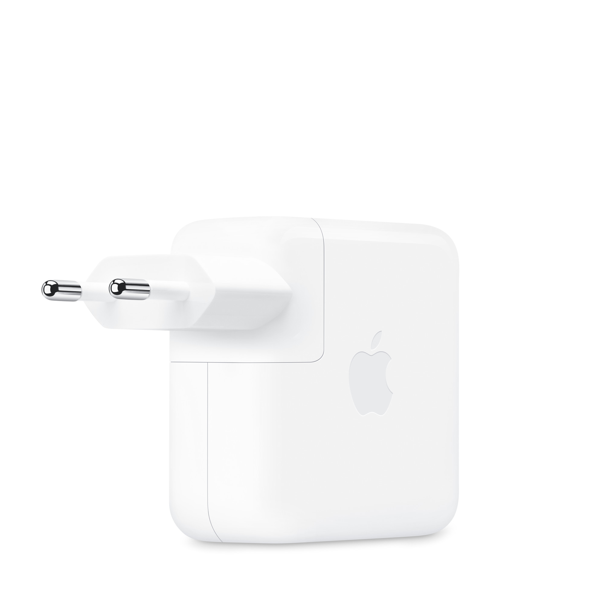

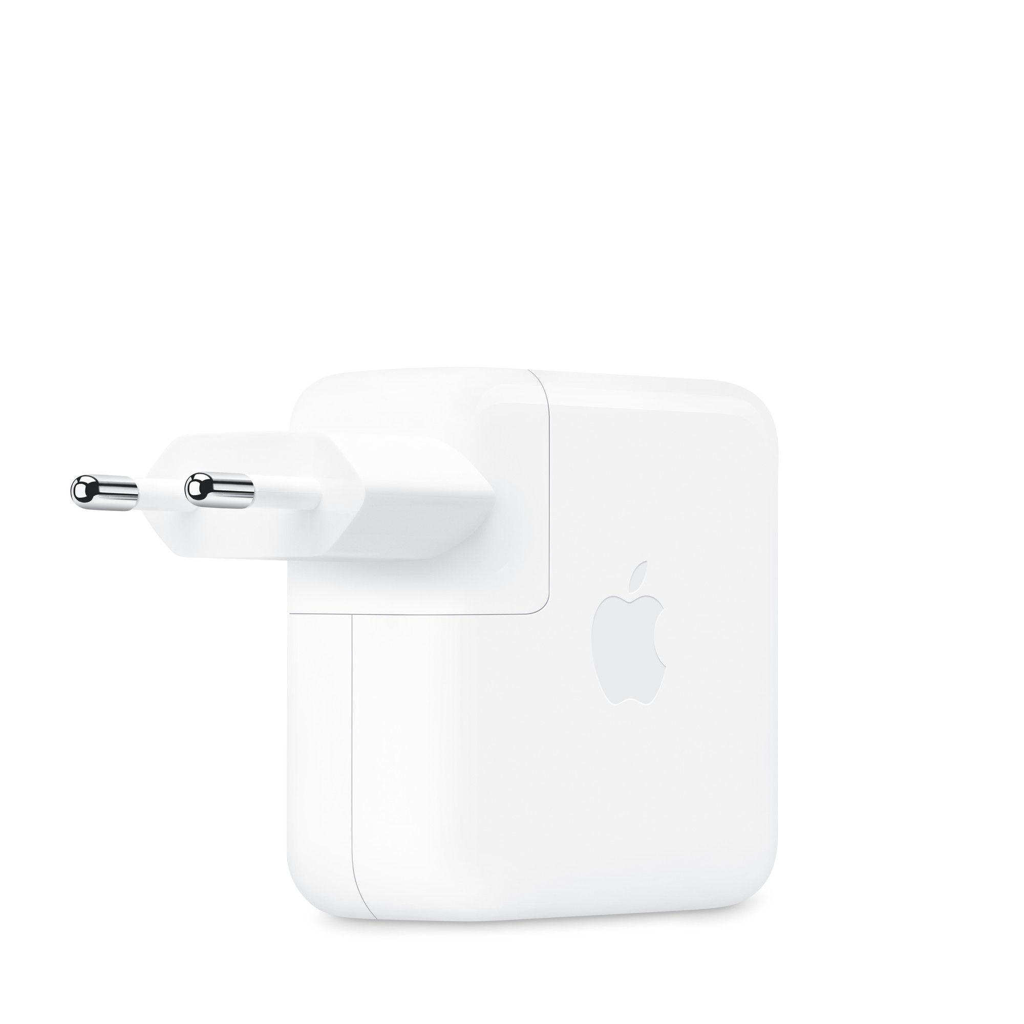

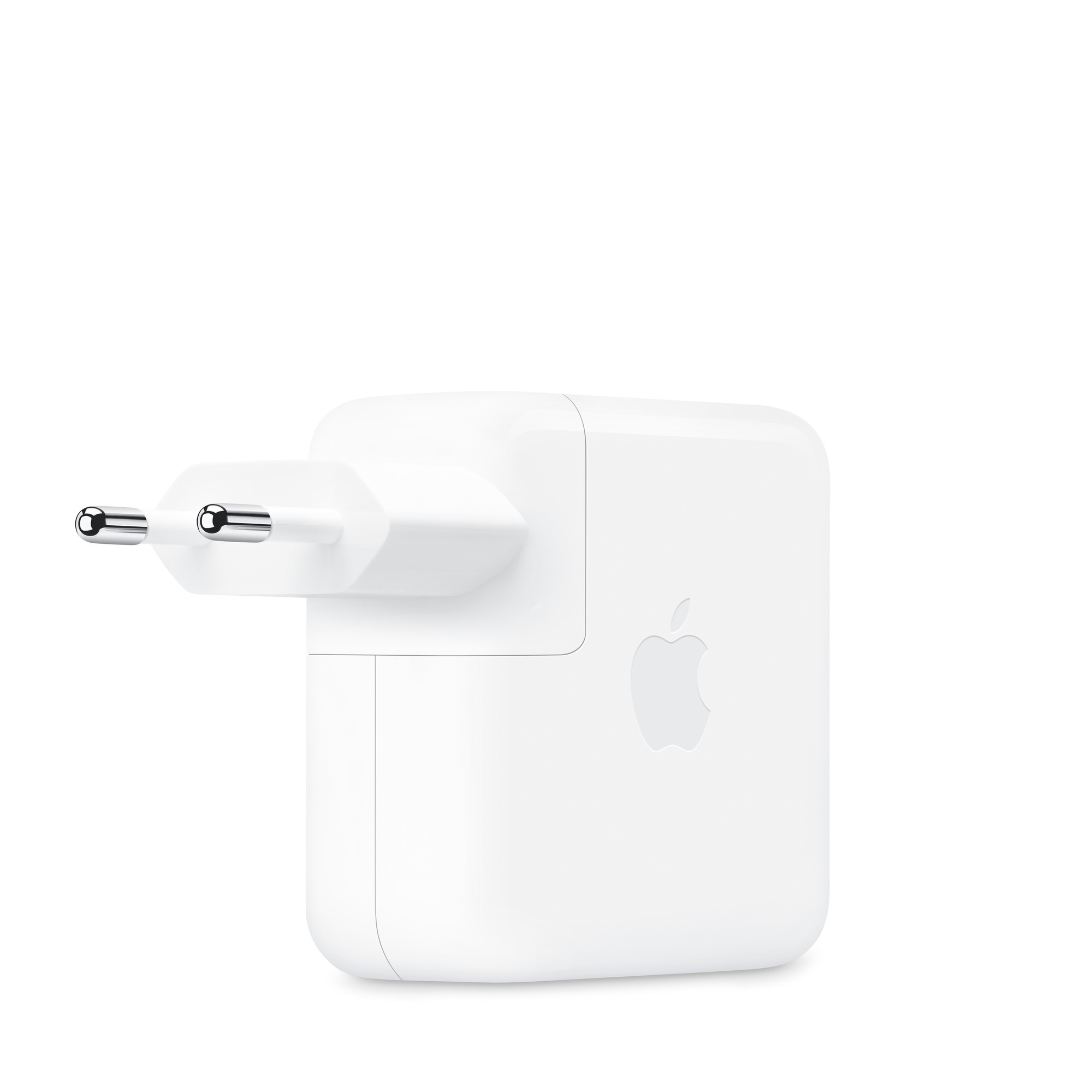

The charger sold in Europe is not grounded.
The shiny logo is live, but not the matte part. 🙂

Apple charger https://www.apple.com/fr/shop/product/mxn53zm/a/Adaptateur secteur USB‑C 70 W
Nothing new It requires the extension cable, which in the old days was also on the box as an extra:
That’s not the point. It should not happen anyway. The phase should not leak into the logo.
The grounding shouldn’t be necessary in normal operation. It’s there for short-circuits and surges.
