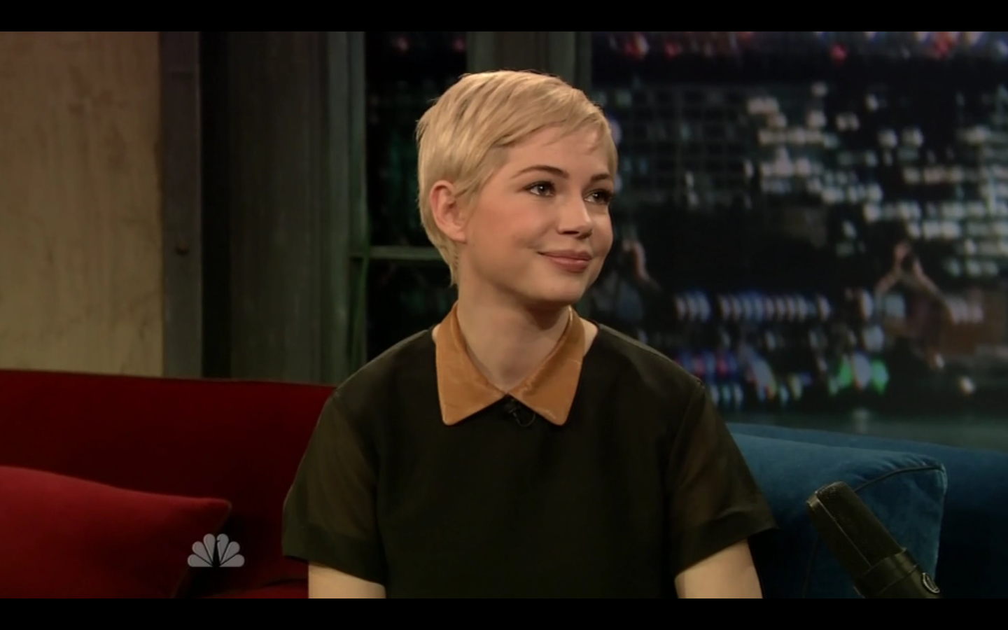

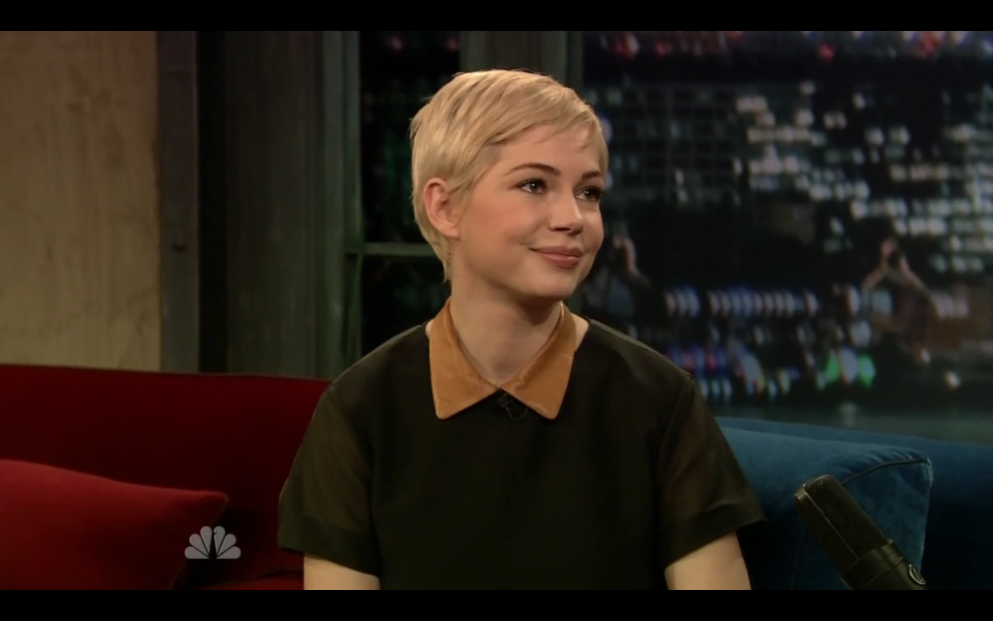

Here's a screenshot from my EyeTV HD. This is coming from a Bright House HD DVR with a 720p signal output. The EyeTV is connected via the component video cables included with the EyeTV. Software is set to "Best" and no interlacing. Not exactly HD quality, is it? Not even DVD quality, to my eyes.

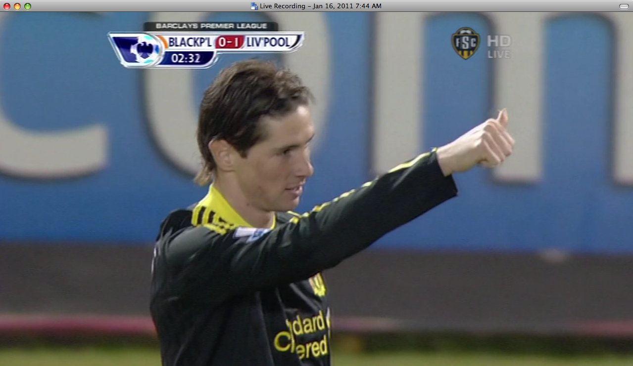

I get pretty decent quality (no ghosting or discernible dropped frames etc.) on two of my primary machines with Eyetv HD even though neither is quite up to the system requirements: iMac 2.0 GHz and MBP 2.2 GHz. (2.26 required).
The screenshot I've posted for comparisons sake is a recording (not live tv) at 1080i with progressive scan enabled at the "better" quality setting.

I think you might have ghosting on your NBC peacock there -- it should be flat grey, shouldn't it? But there's an outline as if the image has ghosted a couple of pixels to the right, just like I'm seeing on my picture.
It's not super-obvious but it does seem like something's out of alignment and that can't be good for the picture.
I do see what you mentioned so out of curiosity last night I checked the same channel and program again on my main HDTV (50 inch plasma). Oddly enough the peacock logo had some ghosting or similar-looking artifact but instead of grey with darker grey outline (like in screencap) it had grey with a brighter shade of grey outline. Again, though, nothing major.
