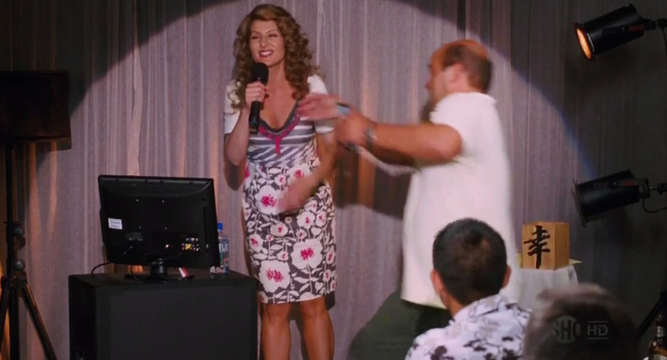

I've just looked at the actual EyeTV file and it seems to have the same glitches. Therefore, I suspect the problem has little to do with the export process, format, etc. Rather, I am suspecting (as did many others here) that it is the inherent limitation of the EyeTV acquisition/setup. Frustrating... was very excited initially. I suspect I will be moving to a HD download/streaming pay model rather than trying to record a personal use library...
Thanks for that. I guess these things are subjective, but to my eyes that quality doesn't look too great, and seems to exhibit the same problems as the rest of ours do. I've sent my test pattern to Elgato so we'll see what they say. I wonder whether the Hauppauge HD PVR is any better?
There's a lot of movement in that scene but other than that it's fine. As far as the other product is concerned, You could try it but I wouldn't want anything that's for a PC. Their Mac products use Elgato’s EyeTV Lite. I think I read somewhere that they are owned by the same company.
Yes, thanks for uploading that. I'm inclined to agree with peterjcat: to my eyes, that doesn't look like an HD image, even in the static elements of the image. The connectors on the back of the TV, the texture of the curtains--they look soft (as does the hair of the three people, including the two who don't seem to be moving much). It's not a terrible image by any means, but I don't think it lives up to what Elgato promised.
My captures look reasonably good on the iPad, and okay on a laptop screen, but they're deficient when viewed through an Apple TV on a 40" lcd. FWIW, I do have all deinterlacing off. I really ought to try to do a frame comparison of a capture vs. an iTunes HD download and an iTunes SD download--my sense, without having done such a comparison, is that the EyeTV captures are not quite as good as the SD iTunes files, and not nearly as good as the HD.
Yeah it's a shame, I quite like the EyeTV software and streaming to the iPhone/iPad works really well at the moment (though the ghosting remains noticeable on the iPad). But the image quality really isn't good enough for playback on a proper TV and so it's not suitable for archiving. I really hope they can come up with an explanation and hopefully a fix.

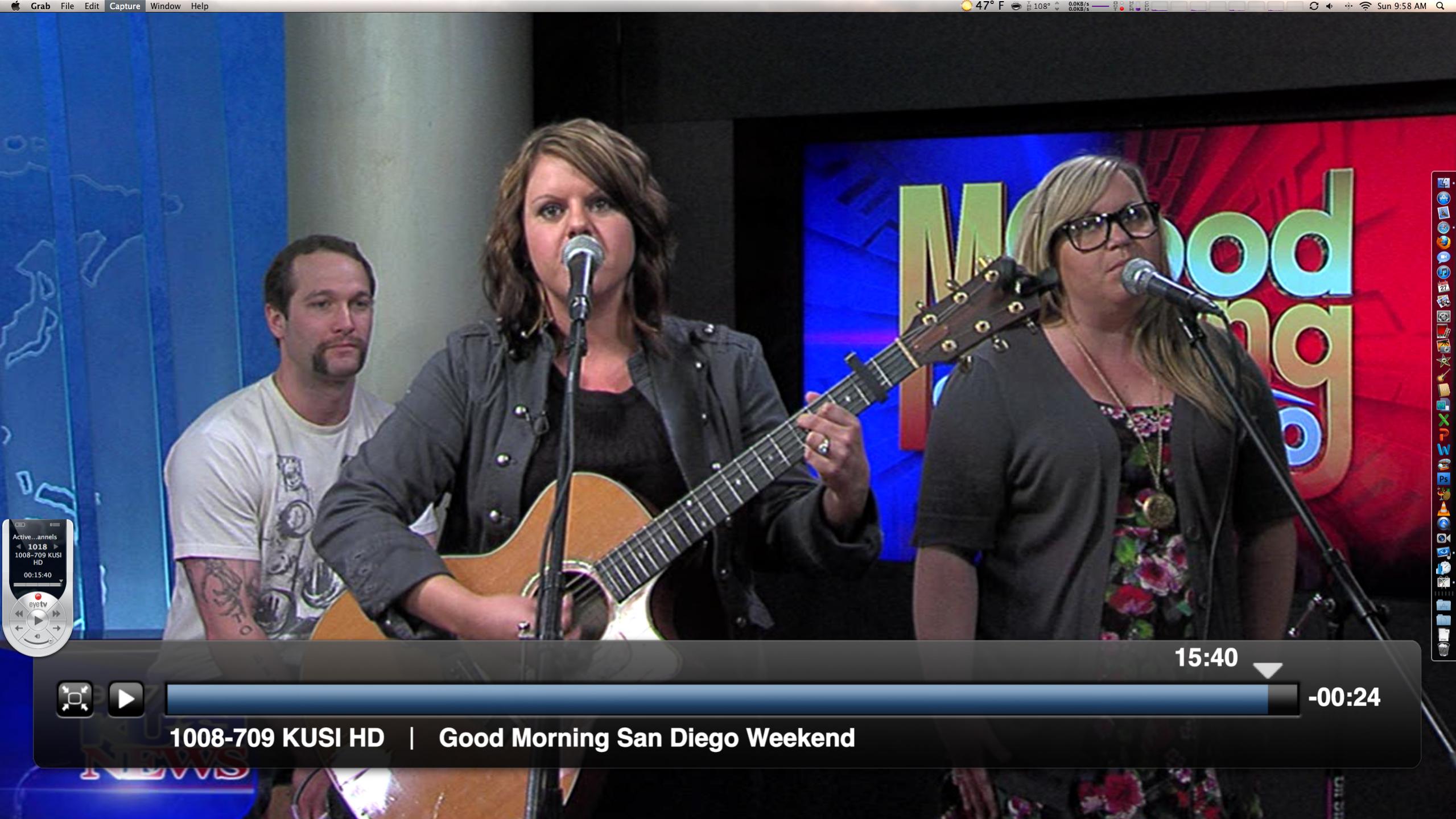

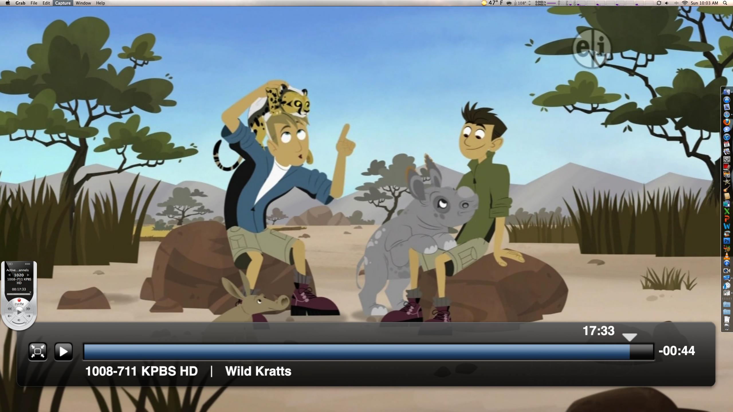

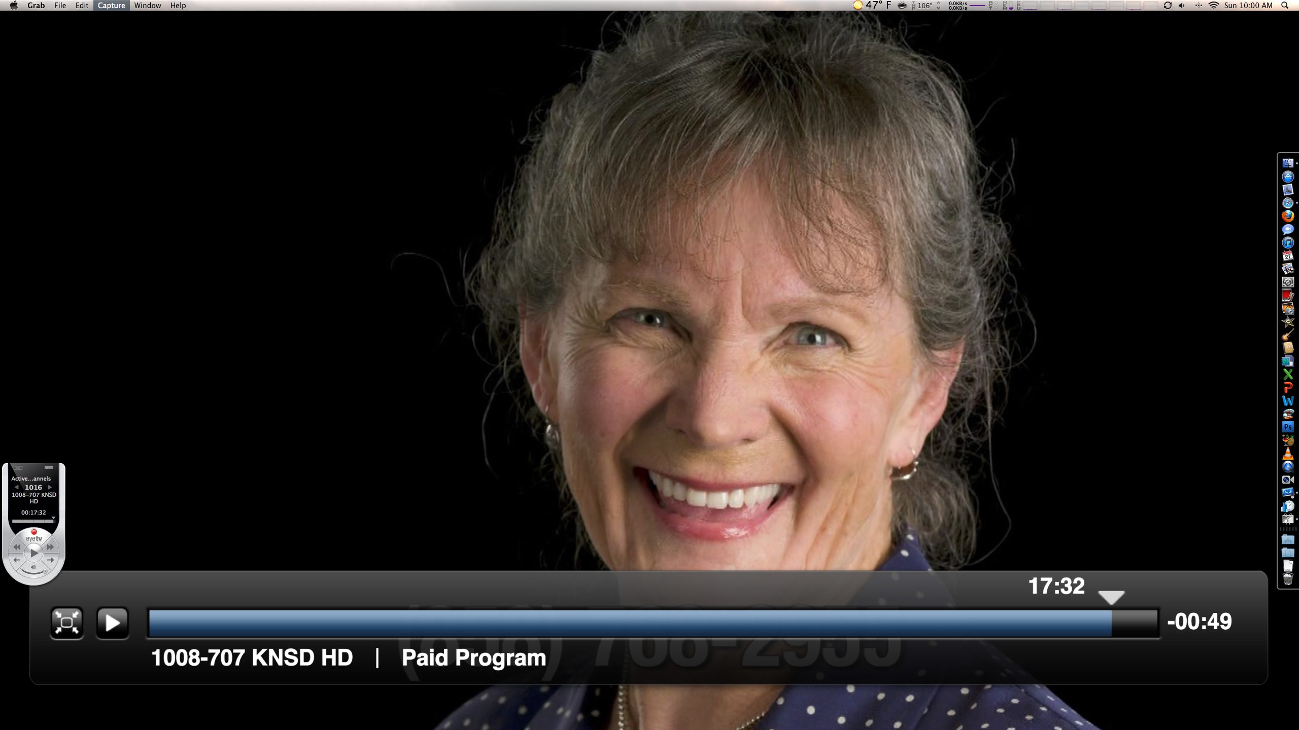

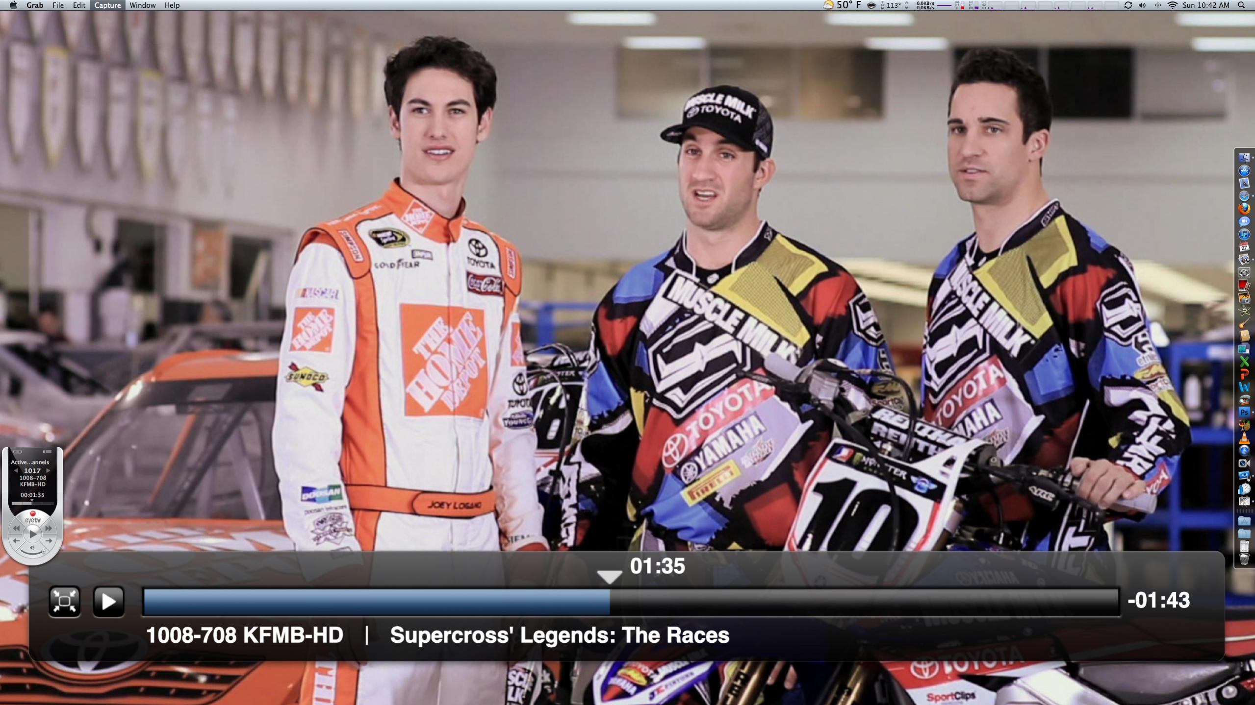

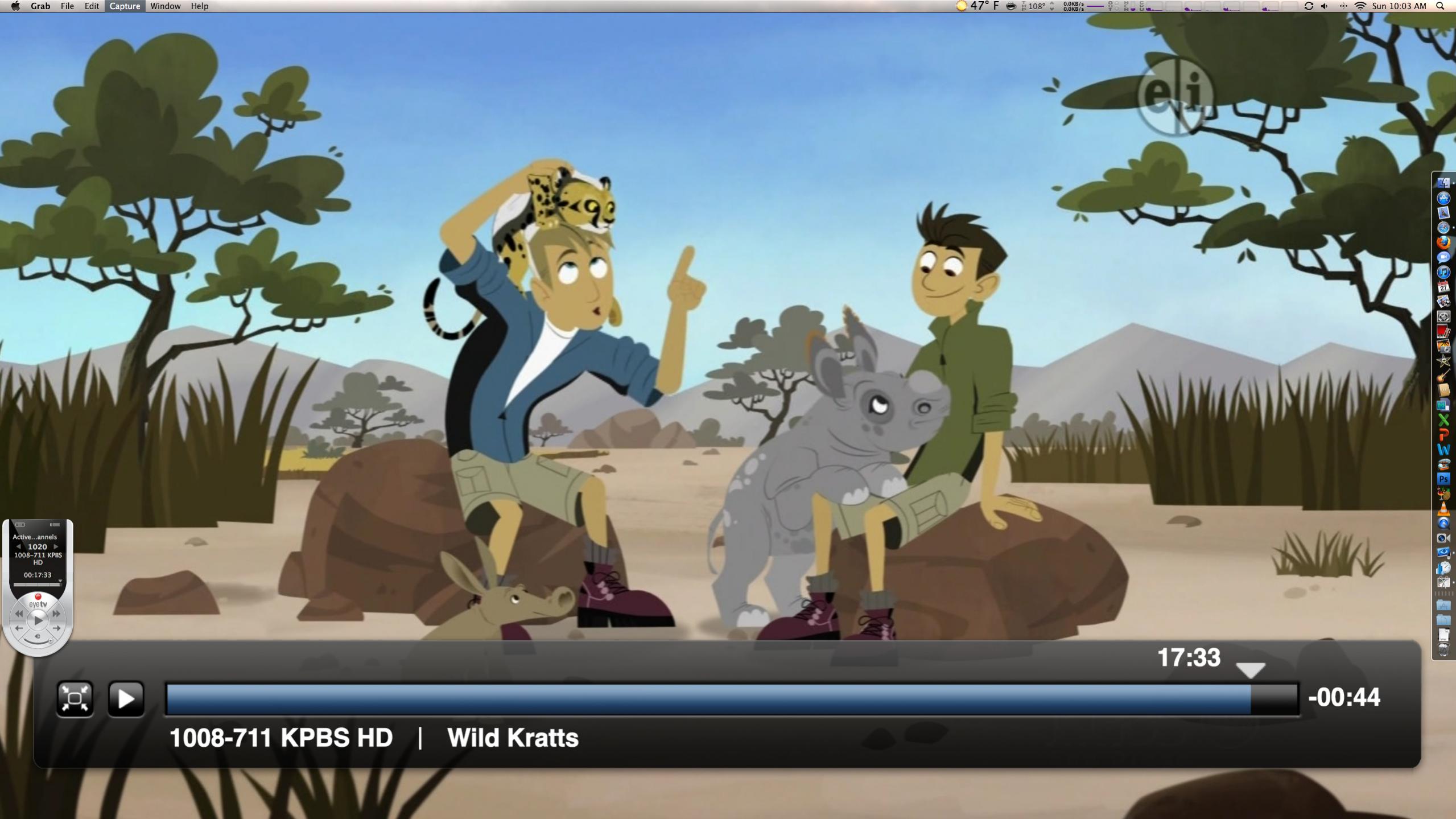

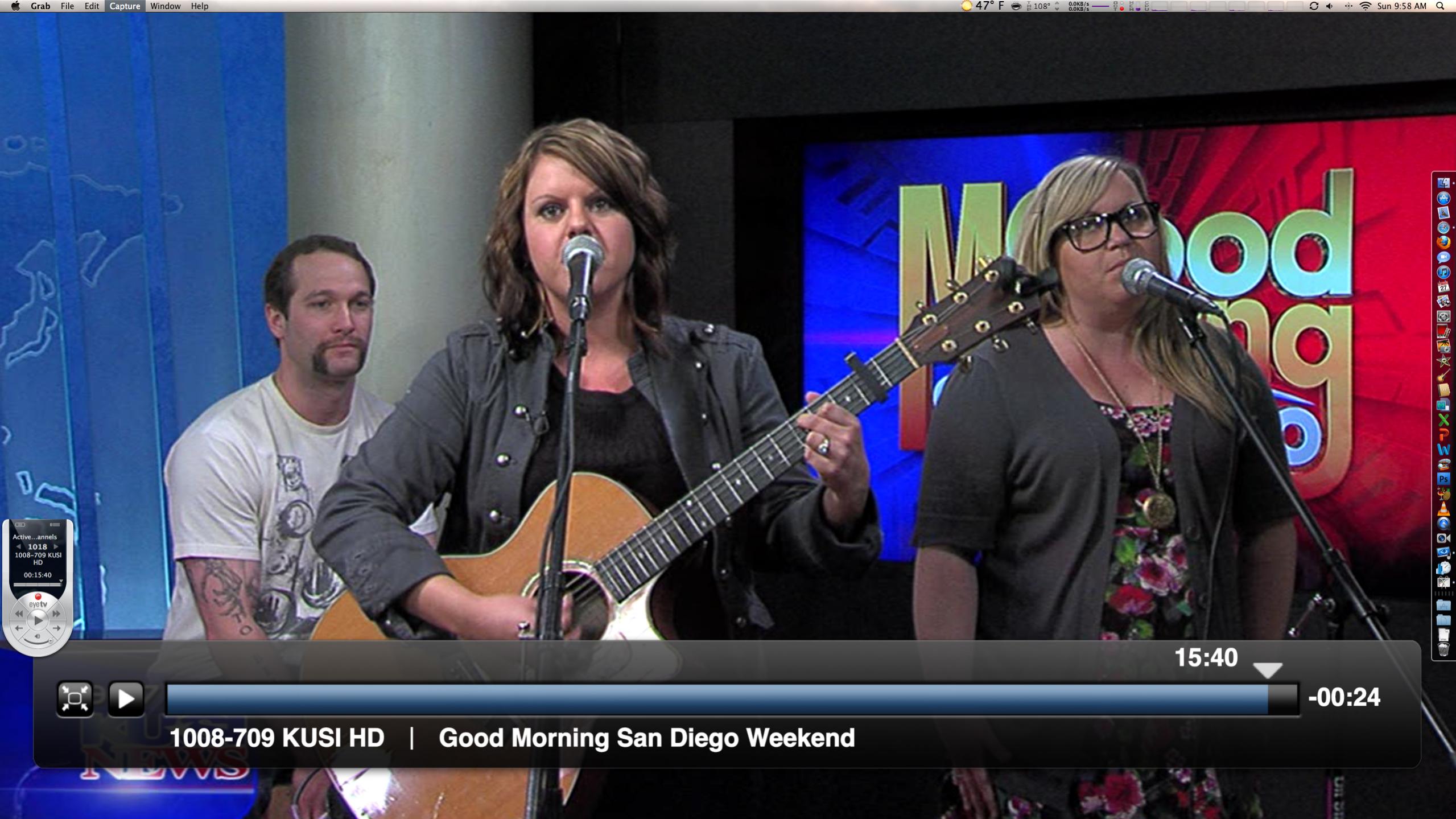

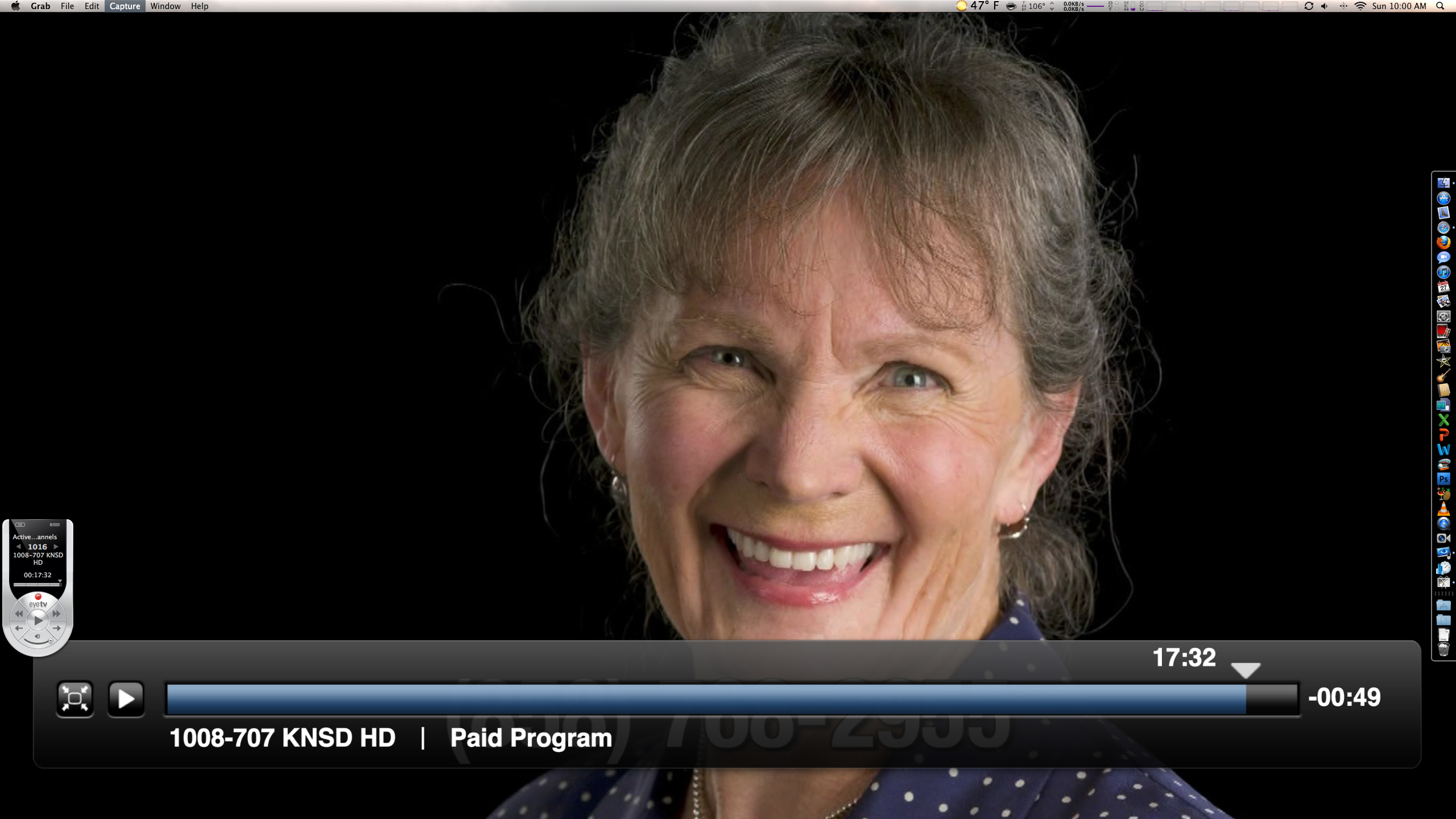

One more thing. I recommend using Handbrake with the Apple TV2 preset to encode vs the ElGato encoder for Apple TV2. Handbrake outputs much better quality.
Well the quality certainly looks right... I'm sure that is as good or better on your TV.

Read the thread. The OP's unit might be defective, but he's got lots of company. Besides, the guy in the post you're probably replying to isn't using the EyeTV HD. His images are from a different device entirely. Also, I don't think the Hybrid can even encode HD. Its inputs are composite and s-video.
