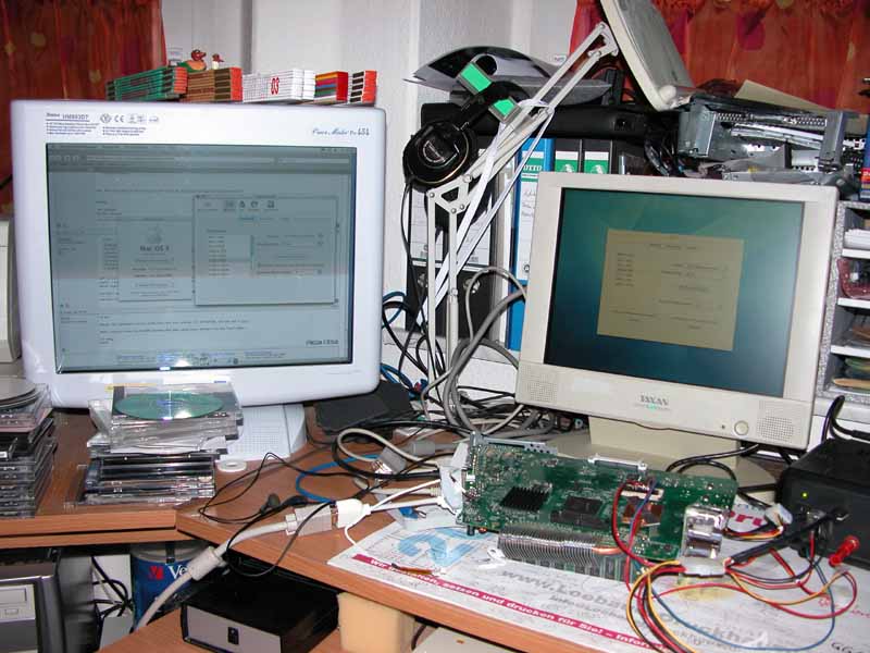

the Gen 3 board is running... just still with a b/w video on the internal, maybe it's just a missing wire or so... will look for it in the evening. The board takes at the 12 V line (without drives) 3.12 Ampere.
Now i'm installing X.3... 😀

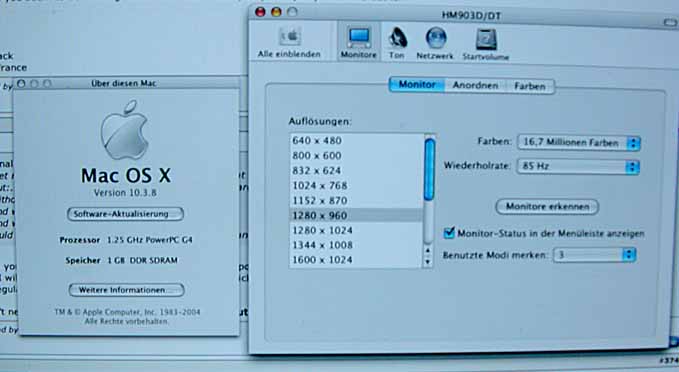

Hello all,
yes, i'm running the 1.25 GHz eMac (Generation 3, USB 2.0, DDR-RAM) headless... only with the downconverter and the pinouts posted by Leo.
This posting i'm writing with it 😀
But there's still a problem with the monitors: they're not recogniced, both, internal and external. The internal screen shows me 640x480, the external 1024x786, no other resolutions available. I've tested SwitchResX, but no change. There is also no button "detect displays (or whatever it's called in english)"... OK, i will try a little bit more...

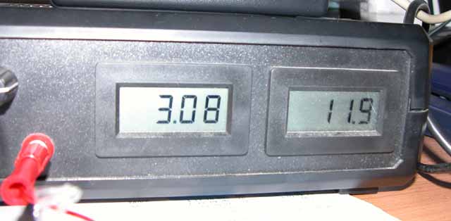

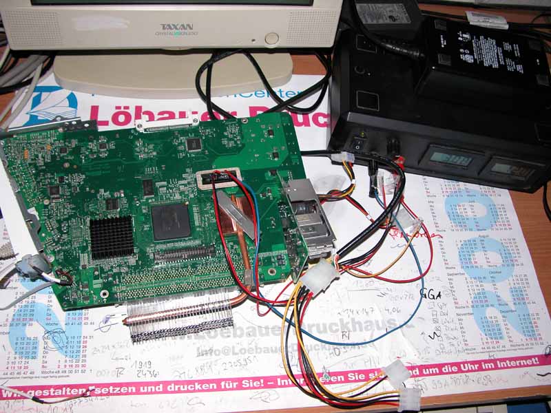

OK, now it works... it's recogniced as eMac in the "Displays..."
I think, i will put a heatsink on the Intrapid... it's getting so hot. And in the final case a slow rotating fan...
I've shot the photo below to demonstrate, that it is working (ok, nothing to see...). Will take some more photos tomorrow.
Now i'm looking forward for a little PSU and some other accessiores... 😀
So long and sleep well.
MrFX

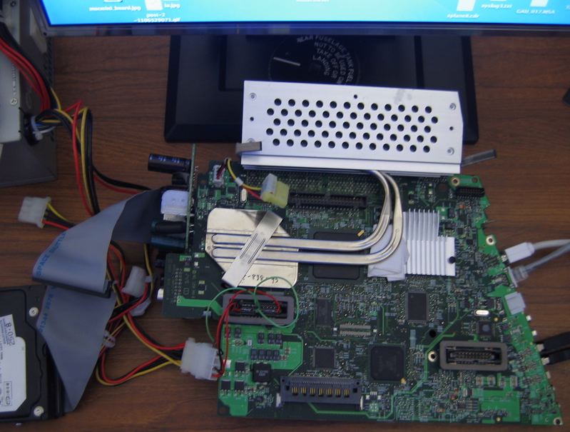

OK, very quick update for tonight.
I am finally running 700MHz bare (headless) Off the +12/+5V ATX PSU. Details tomorrow. Big thanks to guylan for live voltage measurements!
You've done a great job lbodnar. I'm already planning a great case mod for the Headless eMac's around here.
If someone has any ideas, just tell me and I'll try making it...

Hi all...
@Leo: i've uploaded a hi-res photo from the area around J11, tif-format, you can get it here.
Now i have to clean my reallife desktop and take some more photos from the "new" eMac.
So long,
MrFX
Gen1 700MHz/800MHz "headless" details
This is the bare minimum necessary to power a Generation 1 eMac (GeForce graphics, 700/800MHz) on:
Blind mate connector J4504
pin 1 is has ^ mark on the board, pins numbered
2 .. .. .. 20
1 .. .. .. 19
1,3,5,13,15,17,19 +12v (needs 4-5A)
11 +5v (trickle/standby or normal)
7 leave open
2,4,6,8,9,10,12,14,16,18,20 Gnd
Video connector J2701
2 .. .. .. 18
1 .. .. .. 17
corresponding VGA connector pins are in (brackets)
3 B Video (3)
5 G Video (2)
7 R Video (1)
4 B Gnd (8)
6 G Gnd (7)
8 R Gnd (6)
11 V sync (14)
13 H sync (13)
1,4,6,8,9,14,15 Gnd (5,10)
DDC signals (SCK, SDA) are still pending but eMac powers on and works without them just fine.
Hello!
I've take some photos... hope, that you all can see, what you want.
Best wishes,
MrFX
