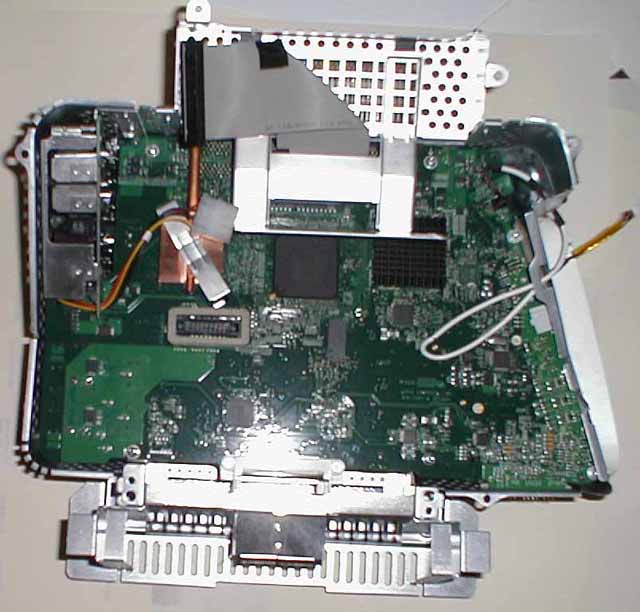

i have now some photos from the Gen 3 Board, it looks like a Gen 2.
I think, i will get the whole Digital Assembly as on the picture, so the Down Converter is included.
