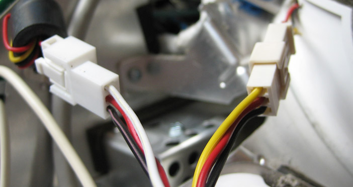

Fan install
Hi people
I've got a Zalman fanmate 2, and installed it (see pics)
problem is, I think I need to cut and rearrange the wires leading to and from the fanmate before it has any effect, currently the knob affects the fan speed not one bit... :confused
currently arranged like:
Mac
Red - Black - Yellow
plug
White - Red - black
fanmate
Yellow - Red - Black
plug
Please could someone tell me how I should rearrange the 2nd and 3rd set of wires?
Cheers

I wonder if there's a chance that you fanmate is actually defective?

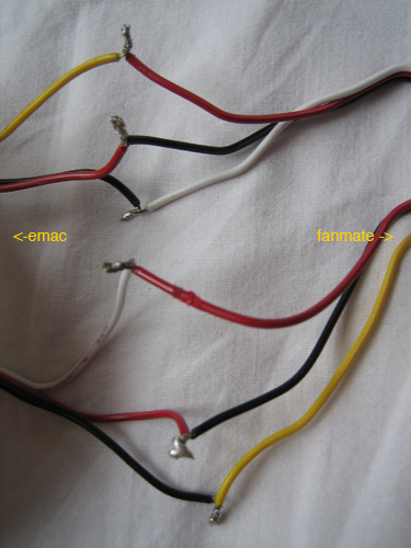

Okay, I finally cracked open my eMac again for some new stuff-
1. OC'd to 1.33GHz. Not as high as I originally planned, but since I had a edu 1GHz model I only had to solder 1 bridge. After I saw how miniscule the bridges were, I decided discretion and 1.33GHz was better than a nun-functional eMac (if I had a thinner soldering iron and some sort of magnifying glass I would have been more bold.)
Good news is that the computer is humming along at 1.33GHz, nice enough for me! Thanks to Leo and everyone else here for all the great info and tips!!!
2. Added a dual-layer burner ($50 from Newegg) and new 200GB HD.
3. I looked at my Zalman fan controller wiring. I'm not sure if I have the #1 or #2 model, but it shouldn't matter. Basically all I did was shave a bit of plastic to make the plugs fit (as it seems most do), but here is the wiring for Seb:
Fan side
* Mac yellow to Zalman black
* Mac black to Zalman red
* Mac red to Zalman white
Power side
As you can see, it's basically symmetrical.
BTW- for those who have done this mod, how low have you turned down the fan? I am now at 50% or so. The fan is quieter than before, but I wouldn't mind going lower if its okay...The G4 iMacs were really quiet and have similar hardware (although airflow was of course different.)
Actually, I should fool around the controller to make sure it is actually reducing fan speed/noise, and not just some placebo effect! 😉

Leo told me how to rewire a fanmate 2, here is a photo of the rewiring, and the message he sent me. My fan is now inaudible.
quoth Leo:
Hello!
Thank you for emailing me. I am glad you have used my information.
You are correct, colours do not match. You have to rearrange wires so that red/red black/black and white/yello are connected together.
It is also important to mention that Fanmate has power side going into its SOCKETS and coming out of its PINS. eMac has the opposite arrangement so you have to find the way to connect male emac plug to male Fanmate plug, same with female plugs.
One way would be to cut and swap around Fanmate connectors.
It is easy as soon as you figure it out!
Remember: red is +12v, black is ground, white/yellow is RPM sensor.
Fanmate gets its power on its female side (should be illustarted on its box)
Does this now fall together?
end quote
In the attached photo I cut the fanmate wires in half and re-ordered them as shown. I soldered them together, taped them seperately and then taped the lot together.
I wish you success, this is certainly worth doing and has no ill effects (have been compressing VIDEO_TS all day in the middle of a heatwave with no crashes...)
