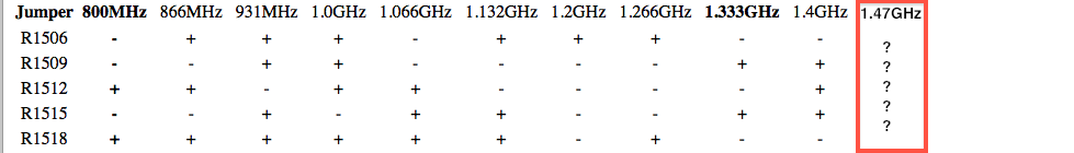

I have an eMac 1GHz also and would like to try and oc it to 1.47GHz too, BUT the original multiplier chart in this thread only goes up to 1.4GHz and I was wondering if you could tell me what what two jumpers you are removing to obtain 1.47GHz (11x multiplier I am assuming)?
Here is the original chart, I have expanded on it adding the 1.47GHz speed that you have reached (circled in red). If you could just fill me in on which on the jumper config, thanks.

Man, props to you guys that are doing this. I've afraid to crack open my old eMac to replace its dead hard drive, much less do any of this stuff.

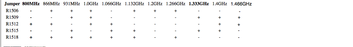

Ok I figured out the jumper config to obtain 1.47GHz (1.466GHz actual) and have expanded the chart accordingly.

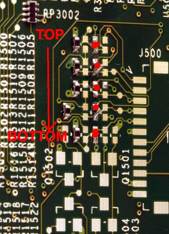

Well since i assume this thread it semi-live again: which side is the "reverse side" and which side is the "J11 side." MrFX's website, which had all of these pictures, is no longer up, and i'm confused out of my mind. Also, I've overclocked a second gen eMac, but I need advice for a third gen: what is the recommended speed that is stable but doesn't require modifying the vcore? I'm thinking about going to 1.75 from 1.25... I know this thread is ancient, but you are all gods about this stuff.
Welp I wasn't stable @1.466GHz but I seem to be sitting pretty @1.4GHz, sweet 😀 A big thanks to lbodnar and everyone else in this thread.
By reverse side do you mean the other side, or backside, of the logic board? Or which way is up and which way is down for the jumpers? Because, I am just beginning here myself, but AFAIK you don't need to touch the other side of the logic board (backside), just the side facing you when your take out the optical drive.
And the jumpers are in red, from top to bottom, they correspond with the chart i posted.

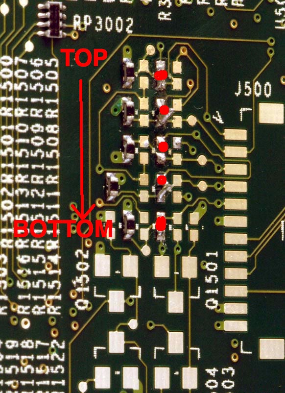

Hmm... Well, i'm about to crack open my third gen, right now. I just realized i can find the jumpers by the resistor number: Look in the chart posted above Here
You're right, I just noticed that 3rd gen eMacs have jumpers located on both sides of the logic board, my mistake. Mine is a 2nd gen and all the jumpers are on the same side.
If it helps there is an image of the reverse side in this post.
For what its worth too I just used a #2 pencil to close the required jumpers, rather than solder, and it worked fine. To open them back up you can simply erase the pencil bridge...It saved a lot of time and mess 😀

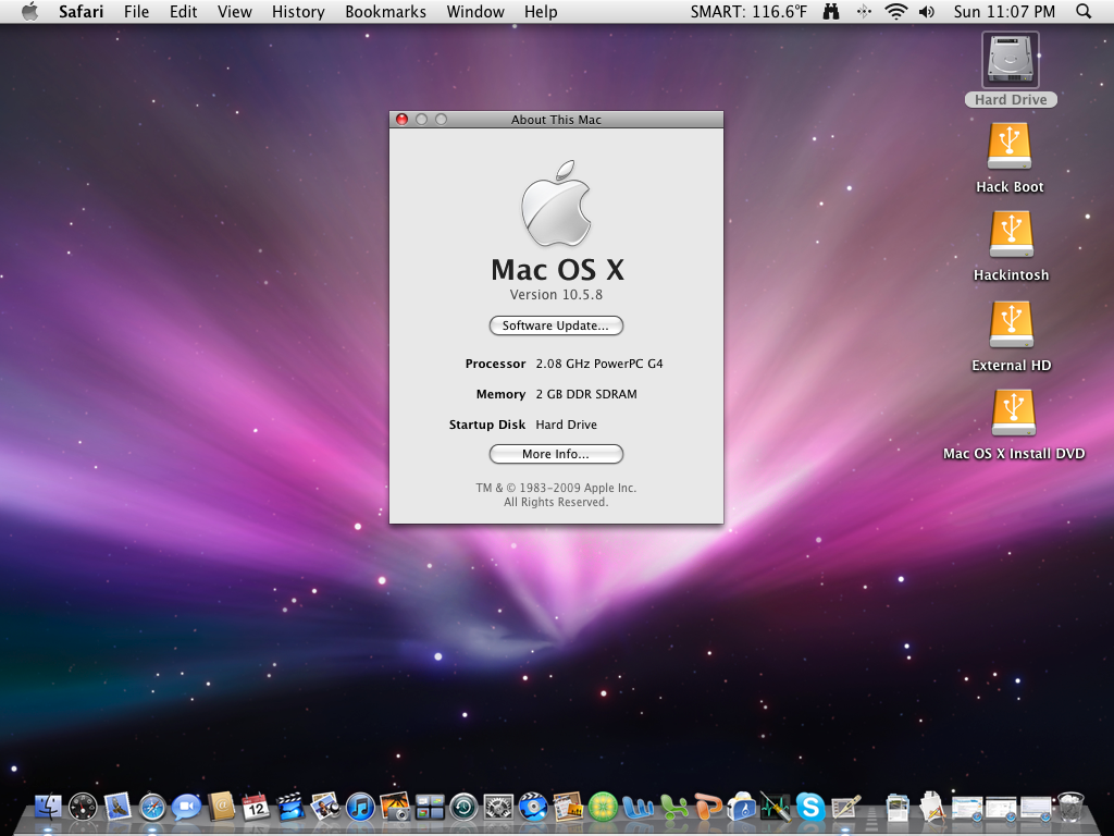

I have been messing around with my emac for quite some time now and i finally got it 100% dialed in. i started off with 1.25Ghz and now im running at 2.08Ghz. i cant tell you how this happened, but i overclocked it originally to 1.58Ghz with a .025 Vcore increase and fixed my "ATM" with the open firmware fix. i was having problems with my mouse freezing on wake-up from sleep and slow boot "gear" logos, so i decided to run these in open firmware:
reset-nvram
set-defaults
reset-all
once i booted back up the gear logo was spinning like a top and everything looked good. i opened up my "ATM" fearing the 750Mhz problem until it says 2.08Ghz. I did not believe this until i ran GeekBench and it came back with a score of 1167!!!! I know this is legit because a few days earlier after the overclock it scored a 835. look here at the full score http://browse.geekbench.ca/geekbench2/view/329447
i have also overclocked the graphics card with ATIcellerator II running just over 22% on both processor and memory values. The SMART sensor is reading 116.6 degrees fahrenheit and holding steady under load. The fan is a little loud, but i can deal with it since i can now watch youtube videos without viewing them frame by frame. does anyone know what may of happened with the clock?

Congrats! You have (by accident) the fastest eMac I've seen. You Geekbench score confirms that. My 1.92 GHz scored 1138 (slightly lower than yours): http://browse.geekbench.ca/geekbench2/view/276397
My guess is that you have soldered/desoldered wrong resistor.
2.08 GHz is unusual for 1.25 GHz CPU, because highest reported stable overclocks were @1.75 GHz.
