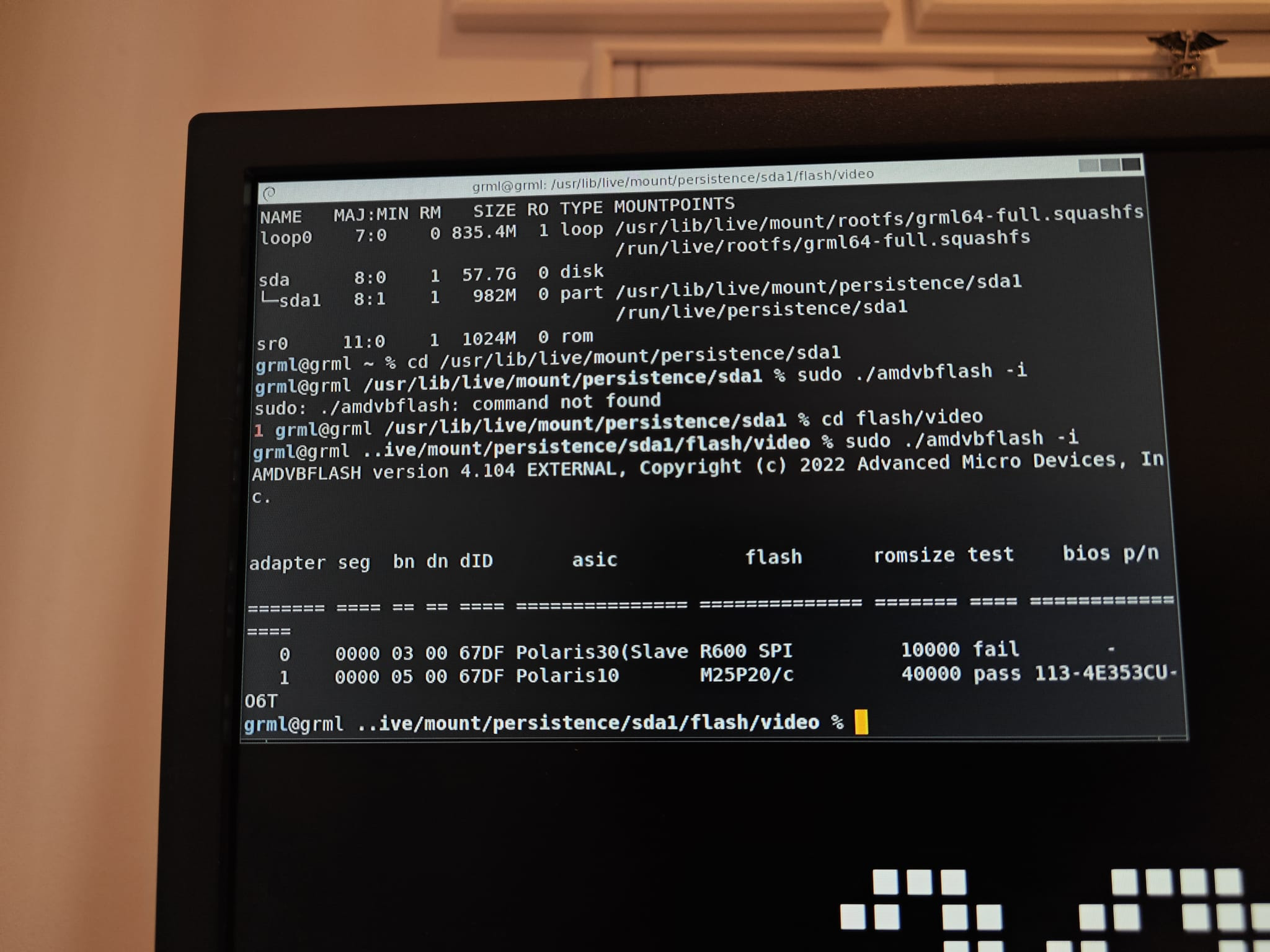

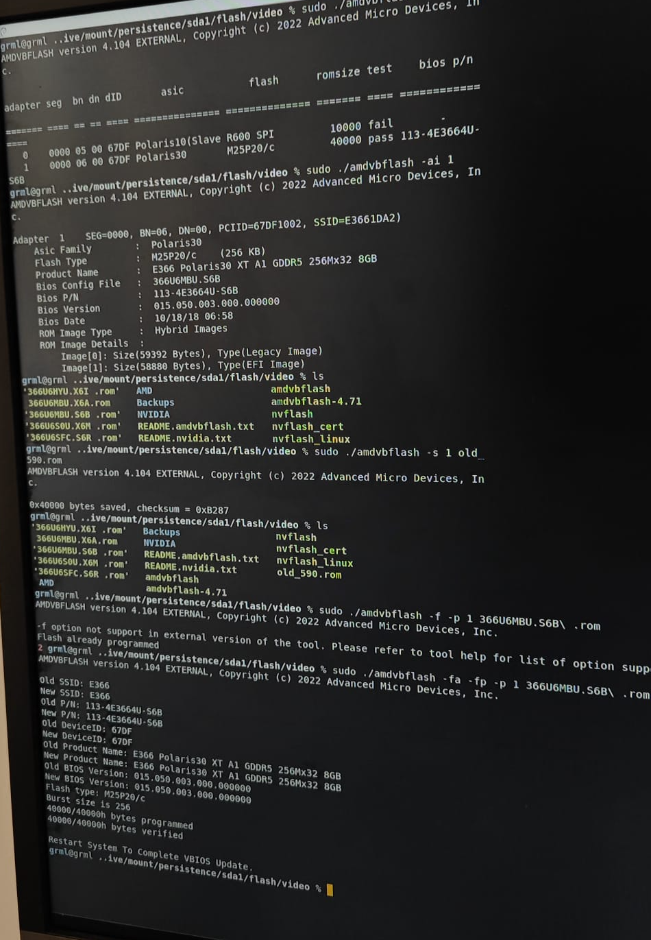

Hello I have a Radeon RX 590 Saphire Nitro +
I was following https://forums.macrumors.com/thread...-era-imacs-and-mac-pros.2378942/post-32671327
I've tried it on slot 3 (with RX 580 on slot 1) and I can boot "november rain" grmpl linux but when I do list this happen:
I use the "-ai", but can't get enough information to get to know which of the one on the list of 590 from techpowerup (there are 5 for this model) I can use to flash.
Can someone help me? From previous replies there's people that were able to use RX 590 and from what I can tell RX 590 (device ID 67DF) is supported on MAc OS.
Thanks in advance

I could use this method before to flash my RX 580 with eGOP (I only needed to use it alone on PCI 1, no other pci cards or boot drive). With radeon VII I could use a GPU on slot 1 and another on slot 2 and was able to flash a rom with eGOP to my Radeon VII.
Both I could not see the mac os boot menu but would end up booting with OCLP (I haven't applied eGOP on OCLP I am sure).
Radeon RX 590 does not fit on slot 2 with Radeon RX 580 on slot 1 (or vise versa).
Tired RX 590 on slot 2 with a pcie "extender" same issue it fails the "tests" I tried with both Bios switch positions
Ok so what worked:
RX 580 (or already flashed eGOP card) on slot 1
RX 590 on slot 2 (with BIOS switch set closest to the outputs)
Display cable on display port further away from HDMI and directly (no KVM) connected to display.
I was able to flash it that way using:

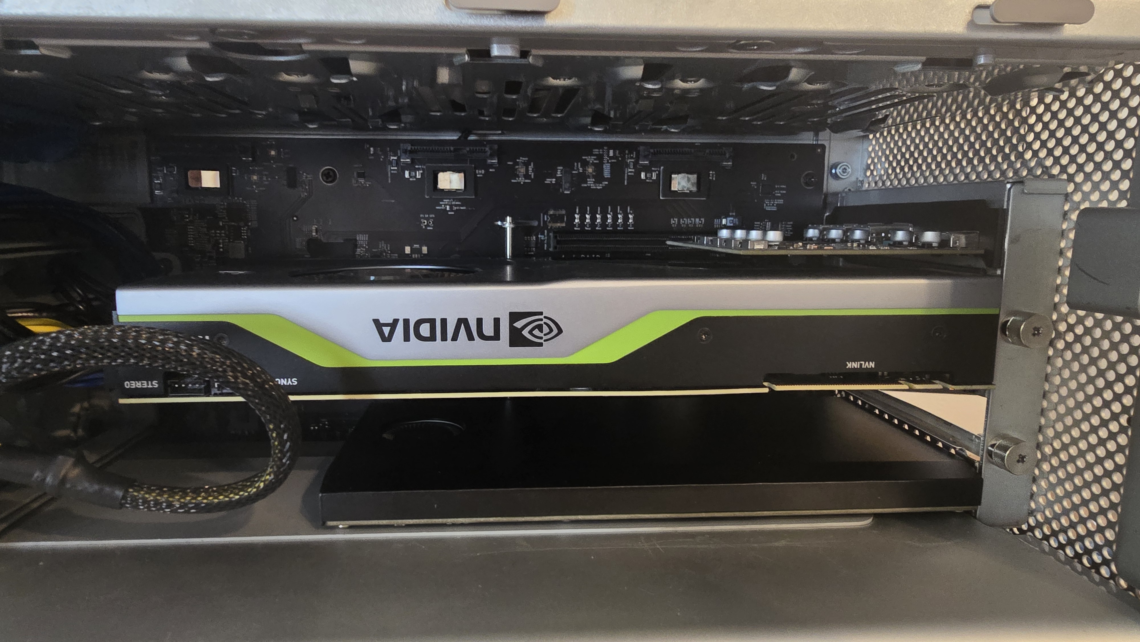

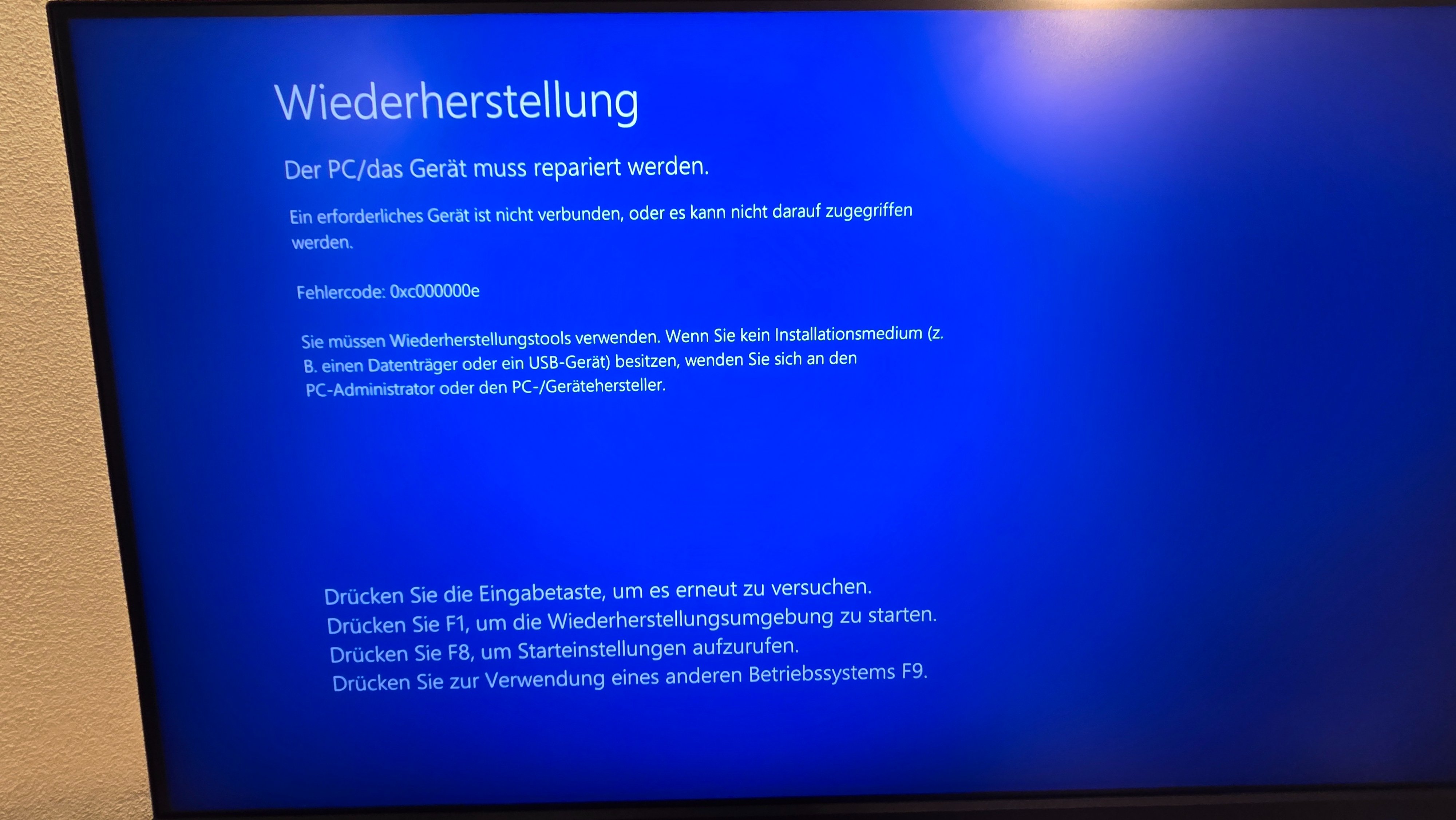

I'm working on a Mac Pro 5,1 (2x Xeon X5690) and ran into a black-screen issue with EnableGOP1.4 on a Turing-based card. Macschrauber suggested to post the case here...
Setup:
Mainboard ROM with EnableGOP1.4 flashed (reconstructed CK0410DVH2P_144.0.0.0.0 + EnableGOP14)
Test GPU: NVIDIA Quadro RTX 6000 Founders Edition (TU102 reference design, P/N 699-5G150-0510-506E), unmodified factory VBIOS
Production GPU (works fine): AMD RX 6600 XT with MacVidCards Mac-EFI flash
Result:
With the Quadro installed and EnableGOP1.4 active, the system chimes and boots normally (no hang, no hardware fault) — but the display stays black throughout, including at the OpenCore picker stage.
Tried with and without ProvideConsoleGop=false in config.plist — no change in either case.
Reverted to the non-GOP14 ROM, RX 6600 XT works as before (confirms the board itself is fine).
Question:
From what I understand from the thread, EnableGOP should provide pre-boot GOP for a PC GPU with unmodified factory VBIOS (one of the three documented paths to a working picker). The Quadro RTX 6000 should fit that case, but stays black.
Is there a known issue with Turing-generation cards and EnableGOP — e.g. an HII (UEFI 2.3.1) requirement that Apple's EFI 1.10 doesn't satisfy? Or is there a way to test in isolation whether the card can even draw the picker via BootKicker.efi, independent of the rest of the OC config?
Happy to provide more details (board ROM version, full config.plist, etc.) if useful. Thanks for all the work on EnableGOP — it's been essential for getting the RX 6600 XT working 😆👍
Best,
Tobias
Purely a knee-jerk sort of suggestion but have you tried all the available video-out sockets (DP, HDMI?) just in case it makes a difference?

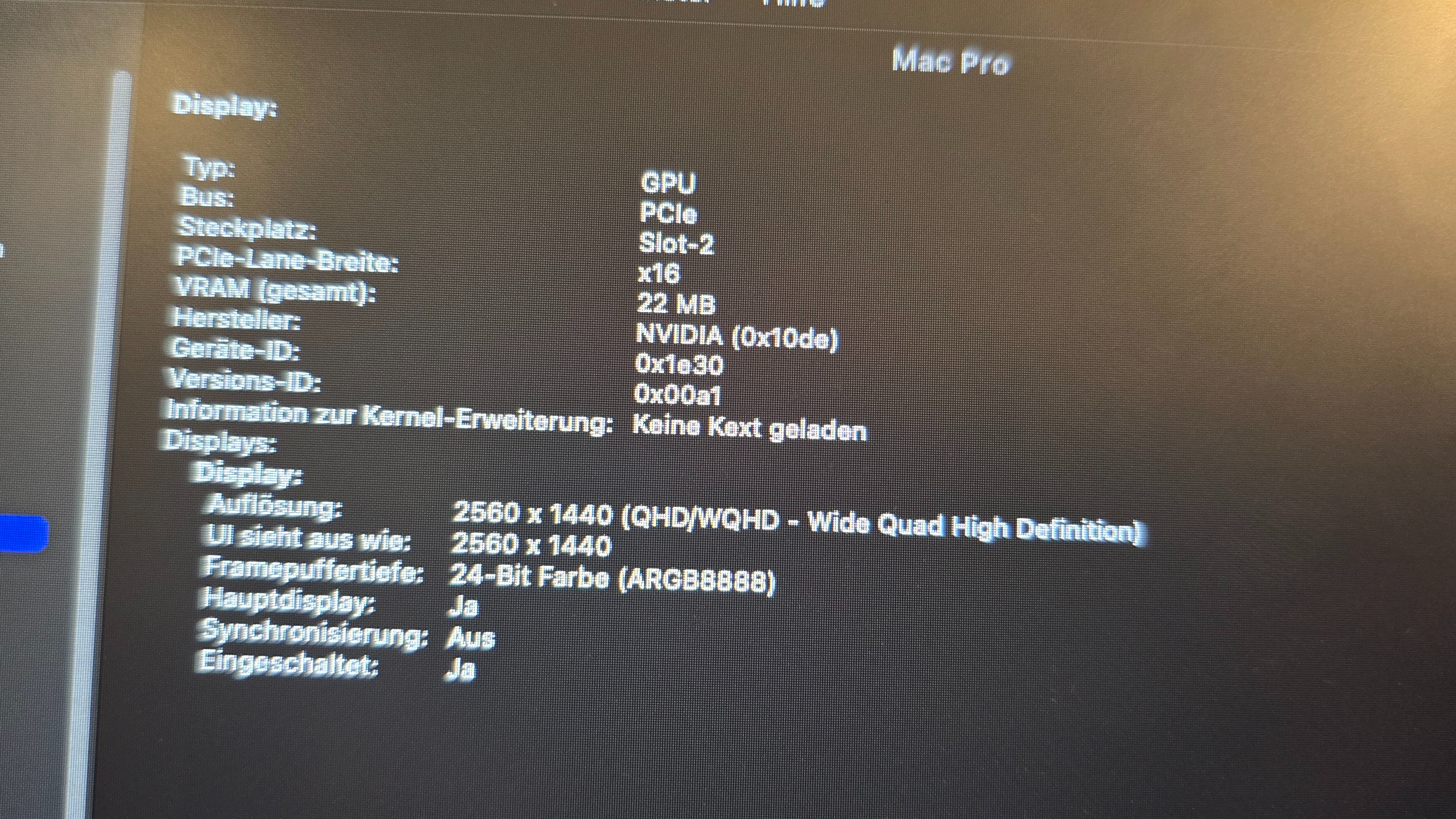

Nvidia 2xxx cards did not require HII and even worked with pre-boot configuration support from factory.
Did you tried Titan RTX firmware instead? This post have the full procedure to cross-flash the firmware:

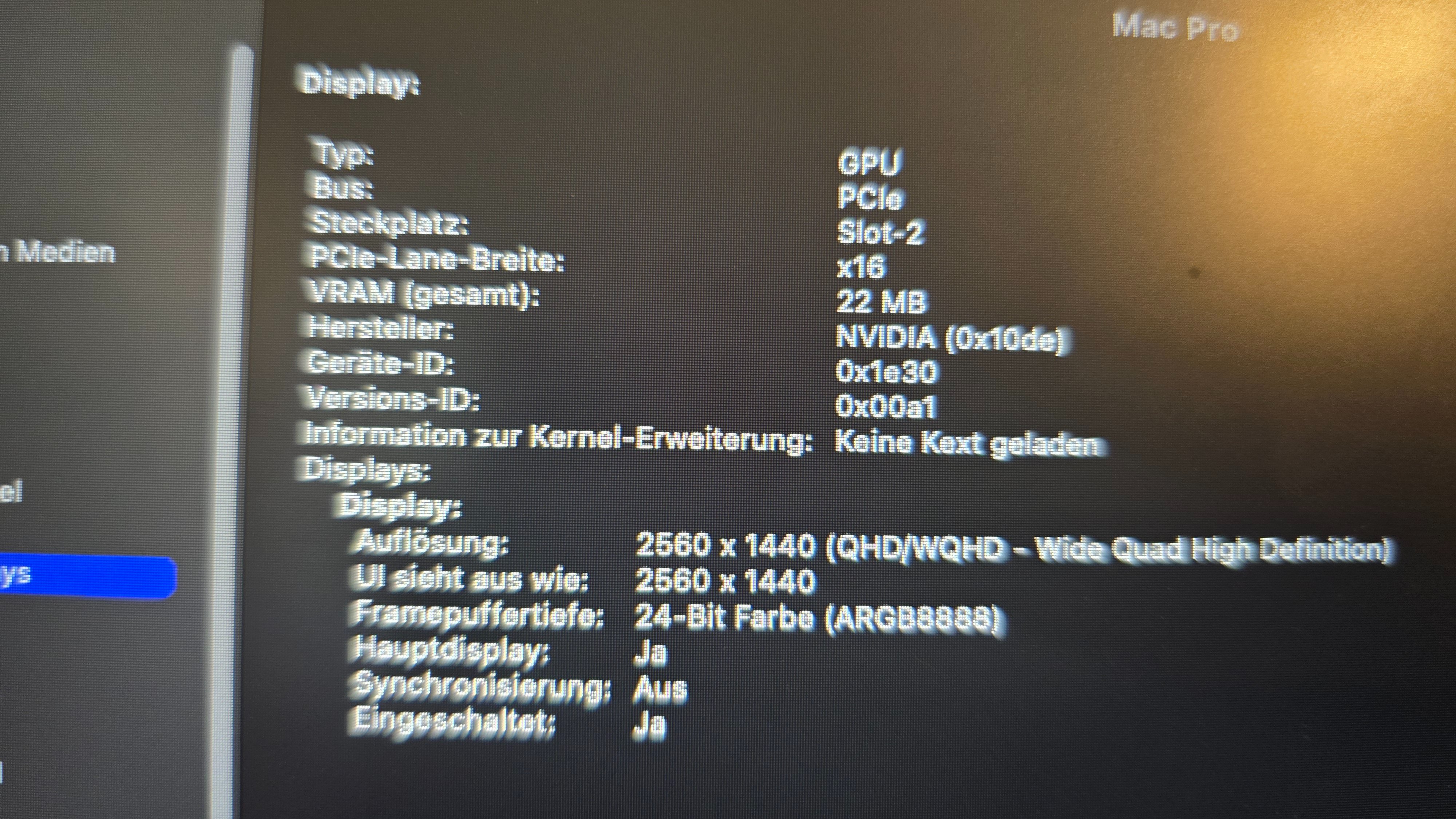

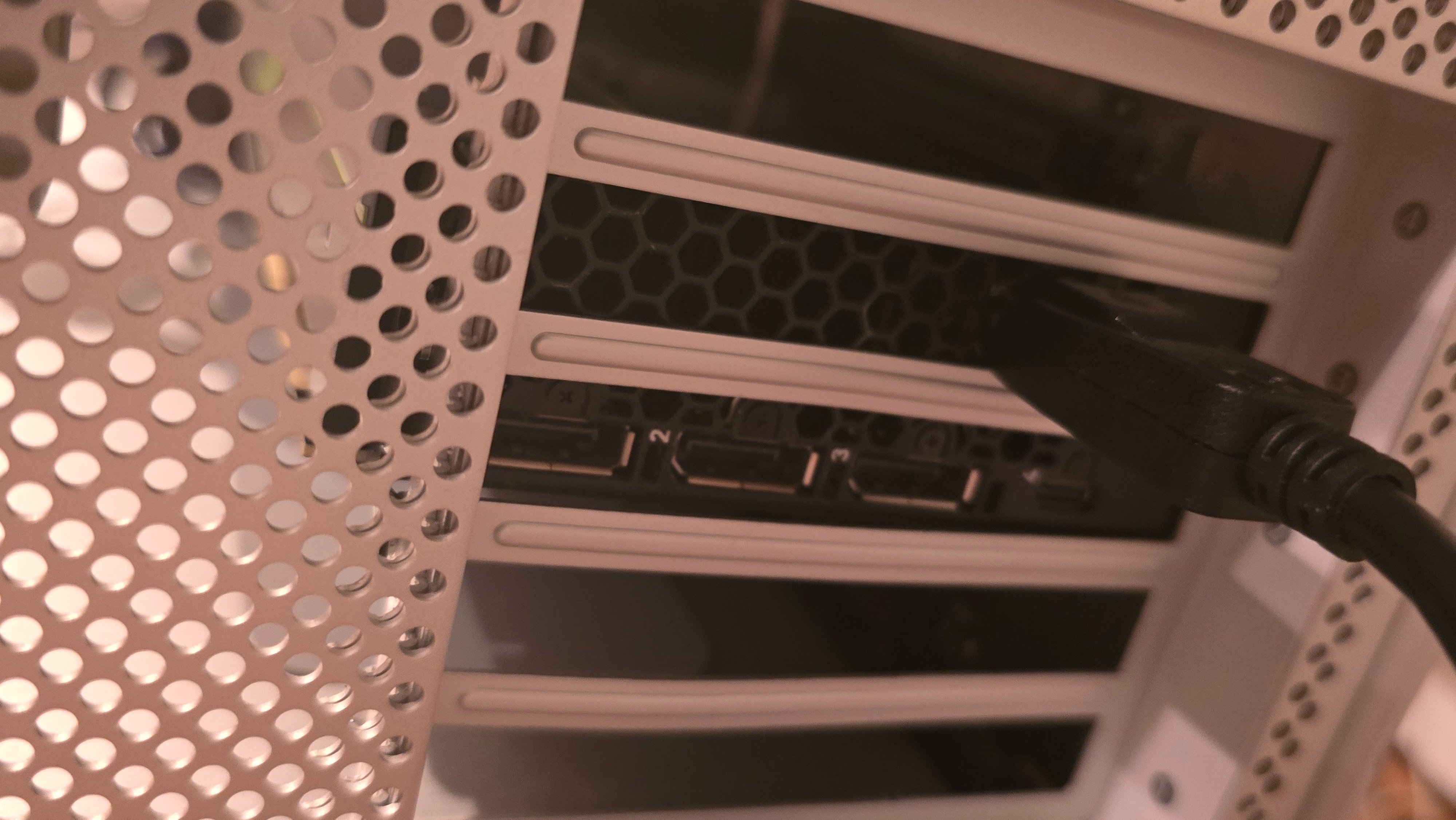

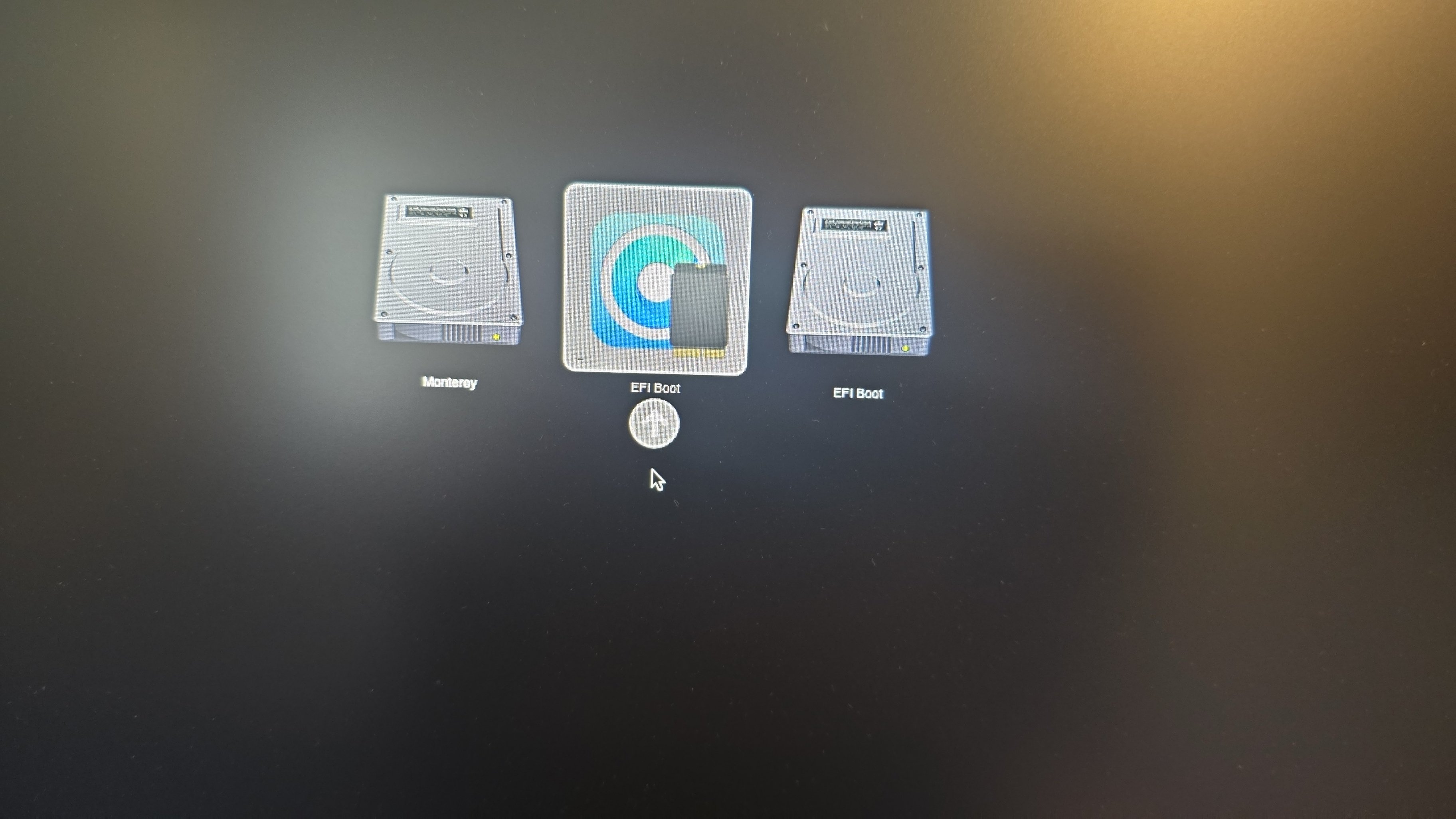

SUCCESS SUCESS SUCESS !!! 🤣🤣🤣
I flashed the GOP1.4 again an used the DP-Port above instead of the other 3...Boot Picker is there an Monterey boots 👍 Windows does not work yet...
Reactions: Amethyst1
Quadro RTX 6000 works with Enabled_GOP 👍👍👍
22MB is not WORKS. No hardware acceleration.
