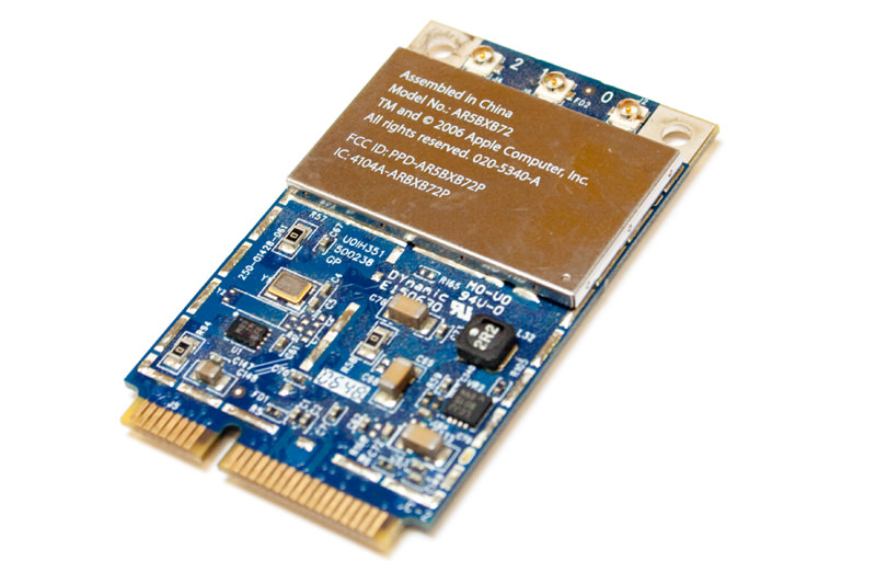

Pull the airport/bluetooth card from your mac book(should be easy and its 4.0le) then pull the BT and airport card from your pro. Switch them, plug your bluetooth/airport card into the old airport card and connect the wires.

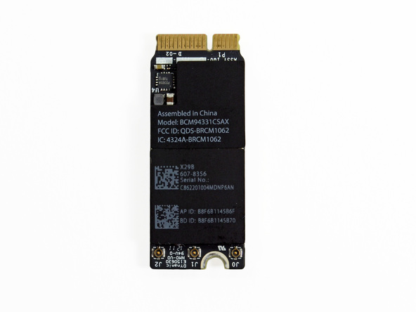

step 11. the cards are totally different. That's not going to fly.

Ive seen the teardown, they both use a mini pci to connect though, Im just saying it could work. If it does then that means older macs just need a $15 part to fix this giant issue.
I have every screwdriver in my kit except the size to open my air or I would give it a go. And I really wouldn't say totally different but then again I cant tell the without trying.

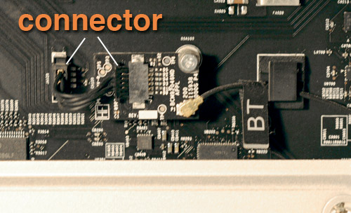

2hj4IKDTAFEZnmbl.medium
Not in a 12 core MacPro5,1 at least.
Yeah thats the bluetooth, unplug that take out the airport card(thats in there mini PCI) then plug in the MBPs combo(bluetooth + Airport) card into that Mini PCI slot. The new card should run both threw the miniPCI slot.

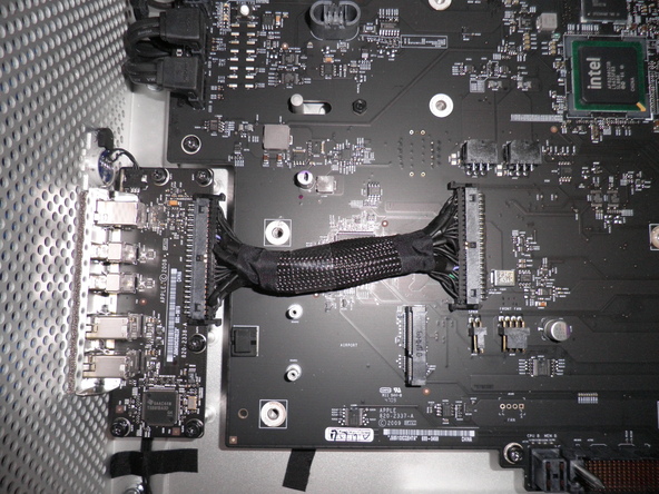

See the mpci slot that the airport card goes to?

Sounds like the card won't work for bluetooth in the slot, just wifi, there may be some luck with the taobao pcie adapter card they're talking about http://www.insanelymac.com/forum/topic/289922-anyone-got-any-pci-e-bcm4360-wifi-ac-card-going-new-macbook-air-owner-wanted/
Its an adapter that converts the proprietary apple connector to a pcie card, runs antennas out the back, and gives you a usb port to plug in the bluetooth on the card to the mac. Not ideal, trying to get some details from netkas on his adapter convertor. That thing is beautiful in comparison.

Actually, the 2009 MP needs the antennae extended but also the USB run to it.
What we have figured out is that 2008 MP used Mini PcCIE spec as written, including USB connection.
At some point during design of 2009 Apple decided to go off spec and removed it.
