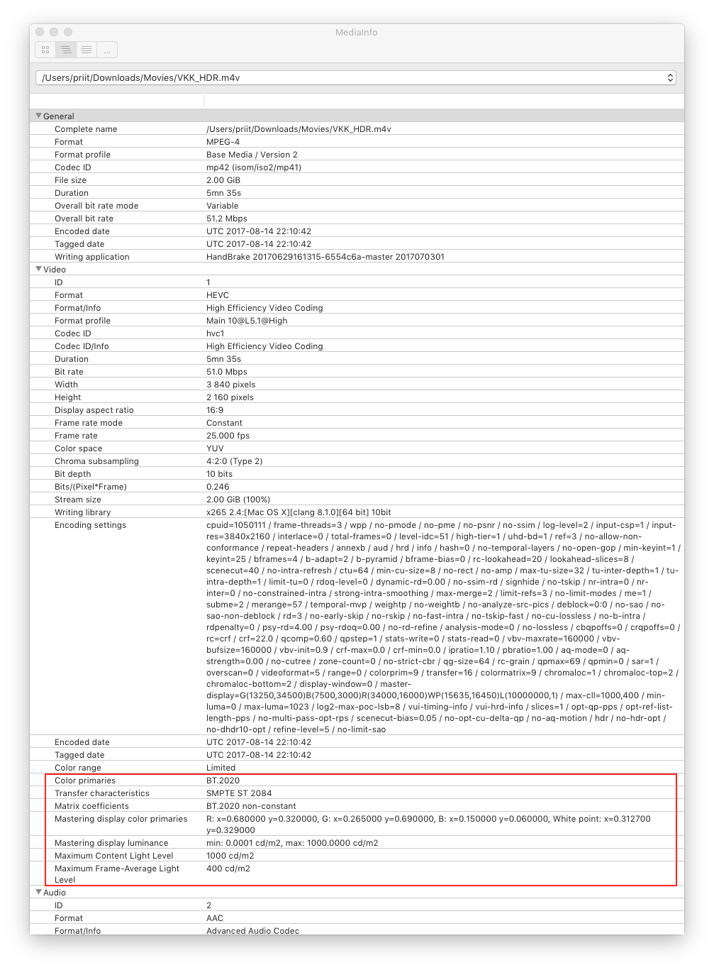

Are you saying, that that other guy’s effort to recompile x265 in 10-bit mode was all for nothing?
My point is, that even with all said limitations, end result is totally worth it. Just because I can get out of the Rec 709 cage. And my display can deliver maximum that it’s capable of, not its minimum. For that to happen, my clip needs to be encoded in PQ EOTF, 10bpp and 2020 color space. Not much more, really.
PS do you know when will Subler get the update to output this new metadata, that will give us nice and proper tags in iTunes library?
Encoding a 8 bit source with a 10 bit encoder helps a bit to reduce banding in dark areas. Encoding a 10 bit HDR source by downconverting it to 8 bit with a 10 bit encoder is just asking for trouble.
That I didn’t get.
If my final encode shows 10-bit HEVC Main 10 profile stream, where does the 8-bit downconversion come in?
@Ritsuka - please check my output file data above and let me know, where can it go so wrong that it will be just asking for trouble?
I am really interested to learn the details of producing HDR movies for myself.
So far, with the output as shown above, I definitely get a visibly better image than in Rec.709 SDR mastering.
PS Just received my aTV 4K, will check how do my files play back on it in coming days.
