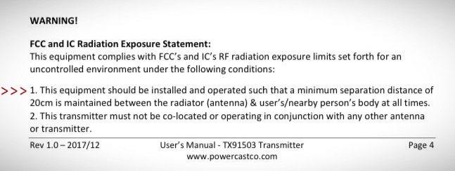

Their recently announced on-demand consumer power transmit station is smaller than Energous' one, with less power (Energous starts with 10W, whereas Powercast starts with 0.5W). However, even the Powercast manual has this:
In other words, don't put one in the crib to power Junior's baby monitor 😉

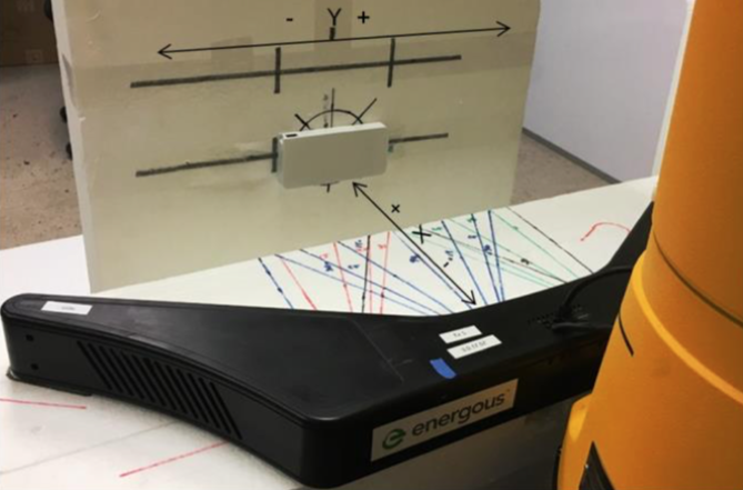

In the best case, if you hang this enormous thing a foot off the table pointing down, you'll get something like 3% of the charging current you get from an inductive pad. This is not a viable technology...
The MS300 transmitter is two and a half feet across and a foot deep with a range of 3 feet within a ±35° arc. It's considered dangerous to get within 2 feet of the transmitter so, while it will charge a device at that range, it will cut off if it detects anything moving or breathing within that space.
The Part 18 filing doesn't give much detail on charging currents, but according to the SAR report, it has a field density of about 75V/m at 85cm, or about 75^2/377 = 15W/m^2
The iPhone 8 has a surface area of about 0.0673*0.1384 = 0.01 m^2
So, if the entire surface of an iPhone 8 was covered with an Energous antenna, you manage to center it in one of several discrete charging pockets, and the antenna efficiency was 1 (impossibly good, but for arguments sake), it would pull something like 150mW.
It wasn't tested within 40cm of the source, but at 40cm the best case power is around 21W/m^2, or best case charge current of 210mW.
Oh, and they make this point as well: "Sufficient power will not be received with the back or edges of the [device being charged] facing the MS300". So it won't work with the phone laying flat in front of it. In order to get those field strengths, they had to test it like this:
