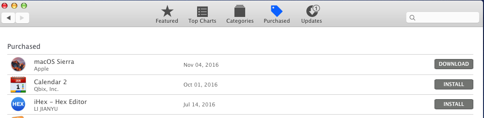

And I'm exactly the opposite, two computers running Yosemite and both showing "Sierra" in my App store purchased list.
Go figure ???
Go figure ???
Definitely strange. My 3 different computers do not show Sierra in the App Store Purchased area using the same Apple ID. 😕
