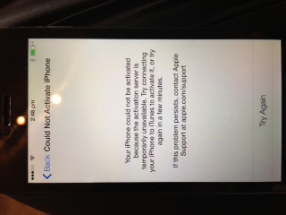

i am currently using an iphone 5 ( completely factory unlocky, no jailbreaks nothing ) and have been running ios7 ( again officially as i have an developer account ) since the beta version was out.
All of a sudden last night my phone started asking me to activate it again. after following the steps i keep getting an error 'could not activate iPhone, try connecting to iTunes and activate etc'.

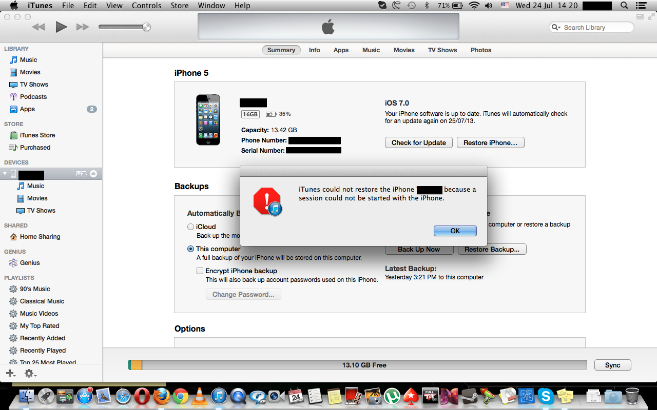

Even after connecting to iTunes i am unable to activate it.
PLEASE HELP!!
i am attaching a few screen shots below which will hopefully give you a clearer picture of what the issues is exactly..
ANY HELP WILL BE MUCH APPRECIATED!

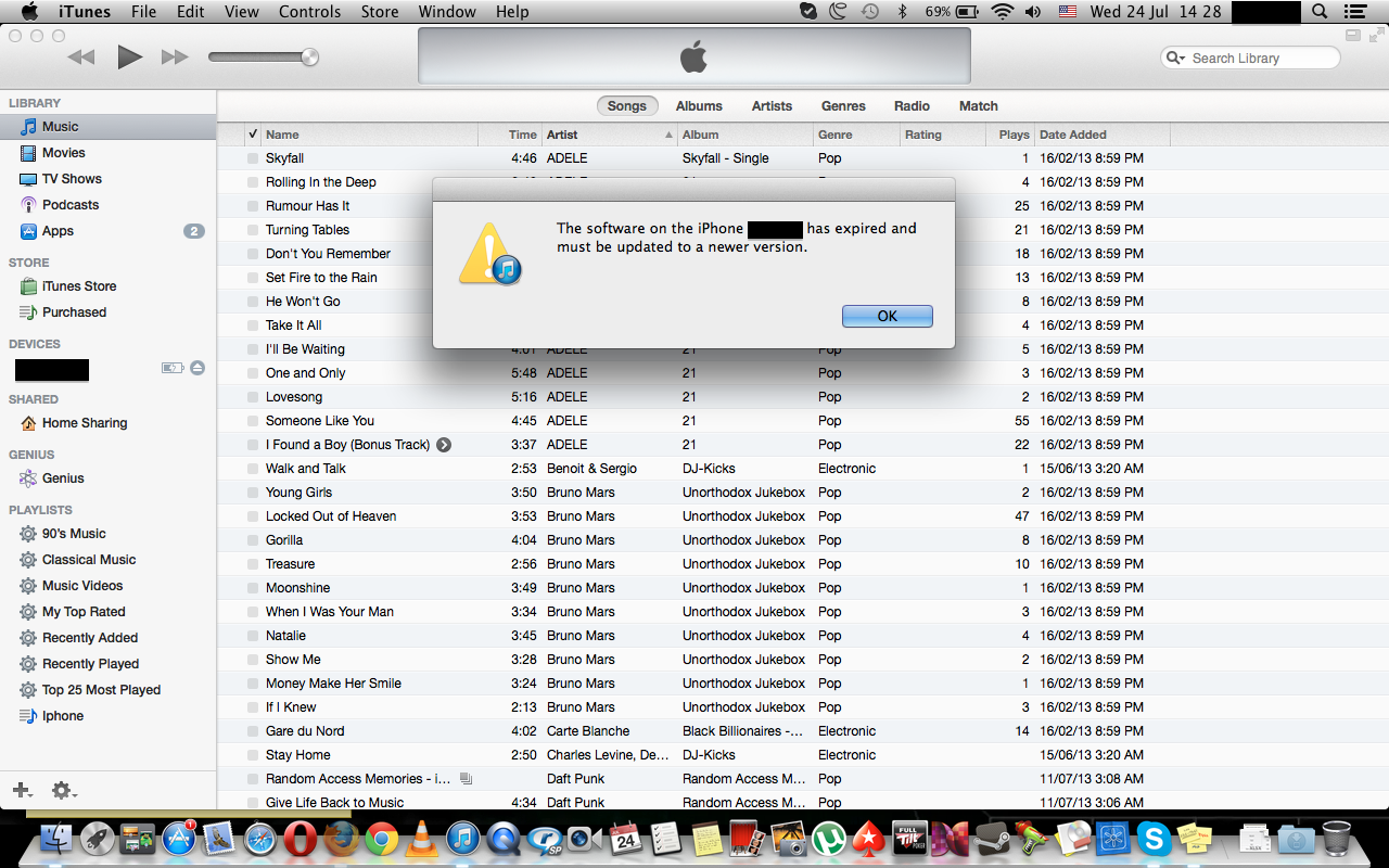

one is the error i am getting on my phone, and the other two are iTunes errors. one when the phone connects and the other one when trying to restore.

Beta1 expired.
Did you never update?
Id tell you to log into the dev center and pull down the latest build... But...
Beta1 expired.
so what are my options? do i revert back to iOS 6 first and then upgrade back to ios 7 or is there any other way?
Same problem after downgrade
went that way, but with restore to 6.1.4 you end up in the same alley: no activation server avail. Is waiting the only way now...
You could also Google iOS 7 and find a mirror of the beta...
Edit: Just re-read the thread. If the activation server is down then having the software won't really help now will it. Looks like 6.1.4 will have to do.
worked fine 6.1.4 only OTA activation
Hi, thx 6.1.4 worked fine OTA activation, not via iTunes. Back on track, for now.

Final Beta expired today. Put it into DFU mode and download the public release
have this problem..phone wont go into dfu mode becuase says its in recovery mode, also tried all the devices that make the recovery mode crash but no help..anyone?
If its in recovery mode a message will pop up in itunes (if you phone was plugged into your computer). Then just click restore.
Was so confused
I had these exact same problems and so did my girlfriend and i was so confused. both tonight at homecoming our phones went up and we were like what?? and then when i got home my mom told me my sisters as well, and my uncles. All these in connection? i all gave them IOS 7 beta before it came out. I plugged my phone in. tried to back up, but couldnt because find my iphone was on and couldnt turn it off. luckily my last backup was just 2 days ago and i was still able to back up all my photos with iPhoto. but reset it. installed 7.0.2 and boom. fixed it immediately. Now to fix everyone elses without them getting pissed lol. But thank you. wouldnt of guessed this issue if you hadnt of posted this.

3 ways to fix your issue:
1. Restore from your iOS 6.1.4 saved file you should have saved.
2. Delete the iphone software update file in itunes and off your computer.
or 3. DFU your phone.
Keep your phone plugged into iTunes.
Turn off your phone connected to the USB cable and iTunes is open.
Once turned off:
Step 1. Hold down the power 3 seconds, while the power is held down
Step 2. Hold down the Home Button and Power button for 10 seconds,
Step 3. Let go of the power and continue to hold down the home button until iTunes pops up with a
I have detected a device in recovery mode.
iTunes will install 7.0.2
After itunes installs 7.0.2.. your phone will restore as a normal restore. If you have an iCloud backup.. you probably will recovery everything.. if you have a beta itunes backup.. probably won't work and you will just have to setup as a new phone.

You also could have updated to iOS 7 at launch and restored your phone from a previous 6.1.4 backup.. You also could have DFUed your phone.
If you are getting a message saying your iCloud Find my iPhone is turned on and can't get in your phone, go to iCloud.com, target your phone in the find my iPhone app, and hit erase iPhone to bypass it.
